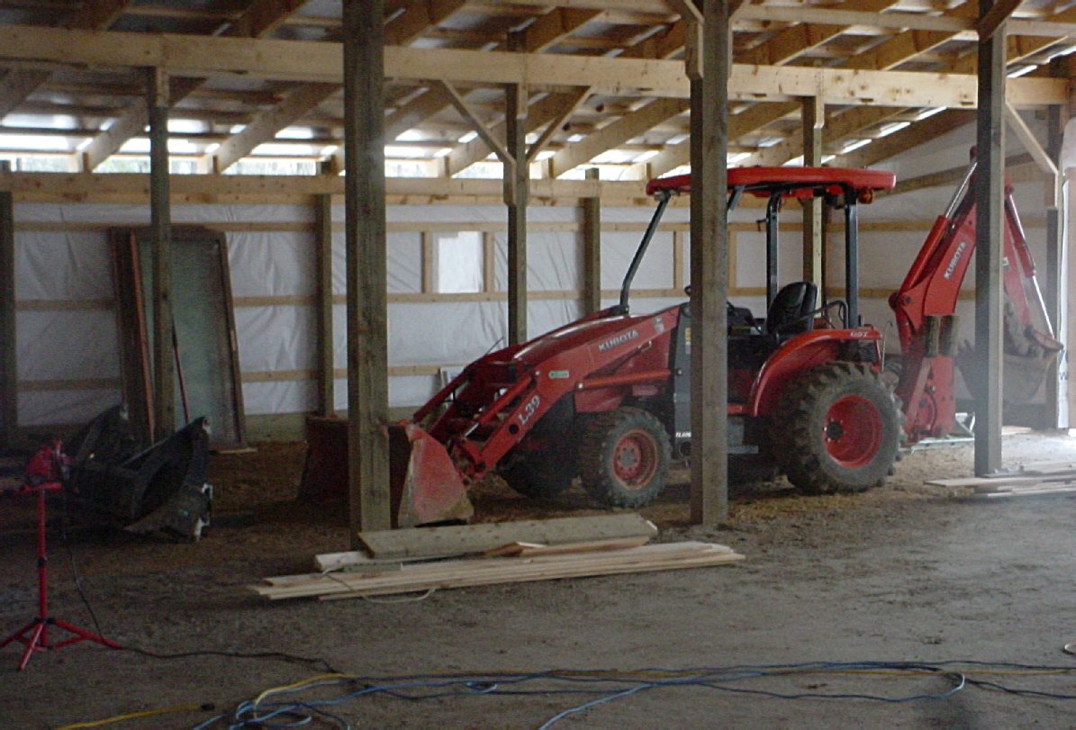

I got to measure my L-39 Loader tubes to have them filled with weights. I will fill them with a pair of 4.075" dia x 15.75" long steel bars for adding an additional 110 lbs. down low. This should also weight the front for better steering up hills and the extra weight will help driving into a pile and back dragging.
I have now a nice place to store my tractor for the winter, thanks to my neigbor.

I goofed in sizing my loader tube weights. I know better not to allow for shrinkage of the loader tube where it is welded to the upright.
My wheel weights are in the paint shop. All told these will add another 530 lbs ND bring the weight of my L39 to +7800 w/ bucket dry weight.
Tractor is undercover for winter.
Our neighbors Barn is coming along.
  • L39_in_tribs-Barn#1-2-12-07.pdf
  • L39_TL-1000_Weight_Opps_2-12-07.pdf

Some Photo's of L39 tractor and weights.
I think the 60 MM studs I ordered are too short. The 80 mm long studs will be lomg , but i will use washers to space the nuts
  • L39-TL1000_Loader_Tube_Weights_Test_Fit.pdf
  • L39_rear_wheel_weights_Not_Installed&Borgford_#1_2-18-07.pdf
  • L39_Borgford_Weights,_tribs_Barn_2-18-07.pdf
