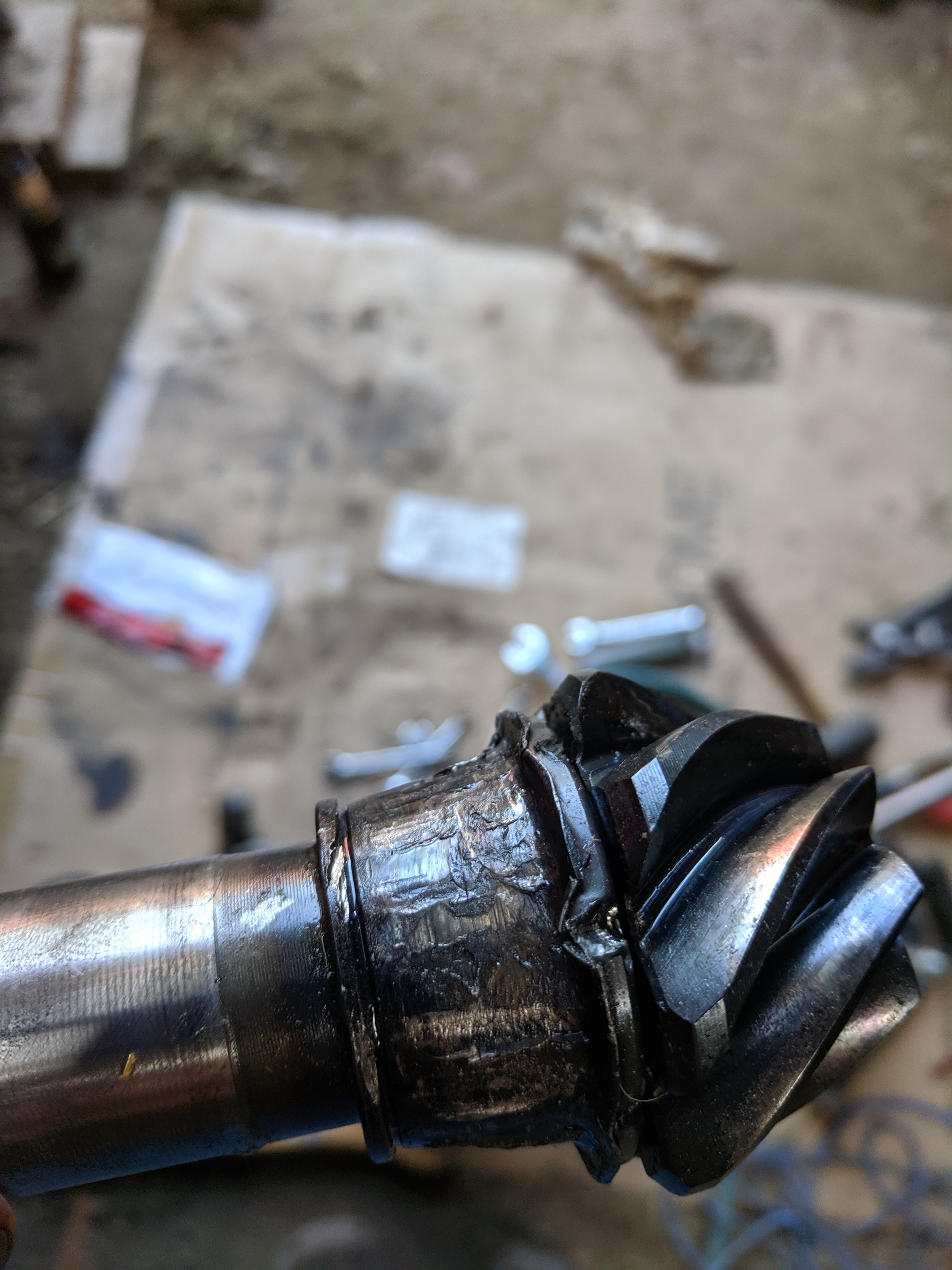

We have a winner!!!! I removed the front axle last night and quit at that point to figure out how to move the axle and work on it. Ending up buying a harbor freight transmission jack to lower the axle and then rigged a hoist in my barn from the rafters. The pinion gear (which I thought) is fine upon inspection looks good. The bearing closest to the gear was destroyed to the point where the roller bearings where welded together. Whats left over is a collar welded to the pinion gear shaft that will barely move (1/8") which I presume is part of the bearing assembly. Tomorrow I will try to get an actual picture of the pinion gear shaft. IMG_20190724_180256.jpg

The bearing is common to a lot of models (Kub part 34070-12200) NTN's part number is 332/28PX1 - available here for around $22 (2 req'd). To cut an old bearing race off the shaft a dremmel & abrasive disk should do. Dick B
   / L3940D FRONT WHEELS LOCKED !! RIDDLE ME THIS?? #8
Yeah it appears the pinion has been very hot. Replacing it also would be money well spent.
Was the differential oil level ok when you started tearing it down?

Well I finally was able to remove the old bearing race collar by cutting it on opposite side with a Foredom tool, soaking it with lube oil, beating on it, and finally used a gear puller to pull it off the shaft. Believe it or not the shaft looks alright, as does the ring gear.
I ordered all new collars, bearings, etc for the pinion shaft. What is now my concern is I believe the collar #30 is stuck in the bottom of the barrel as shown the illustration. Does anyone know if the collar rests on a ridge to keep it from dropping onto the ring gear. I haven't tried to remove it yet and would welcome advice.View attachment 614515 Thanks.
