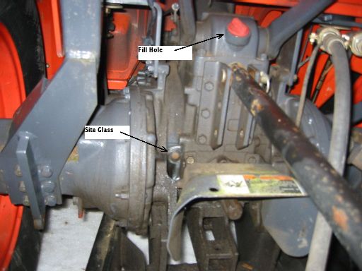

I know this has beend discussed here before, but I'm still lost. I called and asked the dealer how to check the hydraulic oil and they said either there would be a dipstick on the back of the tractor or a sight glass on the lower left side of the transmission. there is neither. There's something on the right side that looks like a sight glass, but I can't see anything through it. It's a L4200GST 4x4 around '95. if anybody has any ideas??

where is your sight glass located??

</font><font color="blue" class="small">( ...they said either there would be a dipstick on the back of the tractor or a sight glass on the lower left side of the transmission. there is neither. There's something on the right side that looks like a sight glass, but I can't see anything through it. It's a L4200GST 4x4 around '95. if anybody has any ideas??)</font>
Baler,
I have the same machine - and rest assured, there IS a site glass on the lower left side of the transmission/PTO housing, when viewed from the back of the tractor. You must be looking under the side of the machine or something. The site glass and fill hole is in the back above the PTO shaft and amongst the 3-pt hitch control arms. The site glass is about 10" or so below the transmission fill hole, which is on the top of the transmission in the back, is red plastic, and says "oil" on it. The site glass bumps out of the housing... oh, to heck with it - see attached picture.
Please excuse the lack of focus and poor composition - it's pitch dark and I had to shove my arm under a snow-covered tarp to snap the picture /forums/images/graemlins/wink.gif.
Before I could get a site-glass reading due to low fluid levels, I took a piece of wire (ideal application for a clothes hanger) and dipped it from the fill hole. I then could simply hold it up on the outside of the housing to see where the oil level was on the inside.
Jay

FWIW, just talked to my friend who has an L4200GST and he says the sight glass is near the top link of the 3PH. He says his is fine, nice and clear, no problems seeing through it.

</font><font color="blue" class="small">( FWIW, just talked to my friend who has an L4200GST and he says the sight glass is near the top link of the 3PH. He says his is fine, nice and clear, no problems seeing through it.)</font>
See pic in previous post. Ditto on the nice and clear too - leaks, but is clear. At least was - I think I completely clouded mine last week by shooting it with brake cleaner (clearing the spooge to find the leak) but I'm not sure - it looks OK in my picture (go figure). The good news is that new ones cost all of $6.
