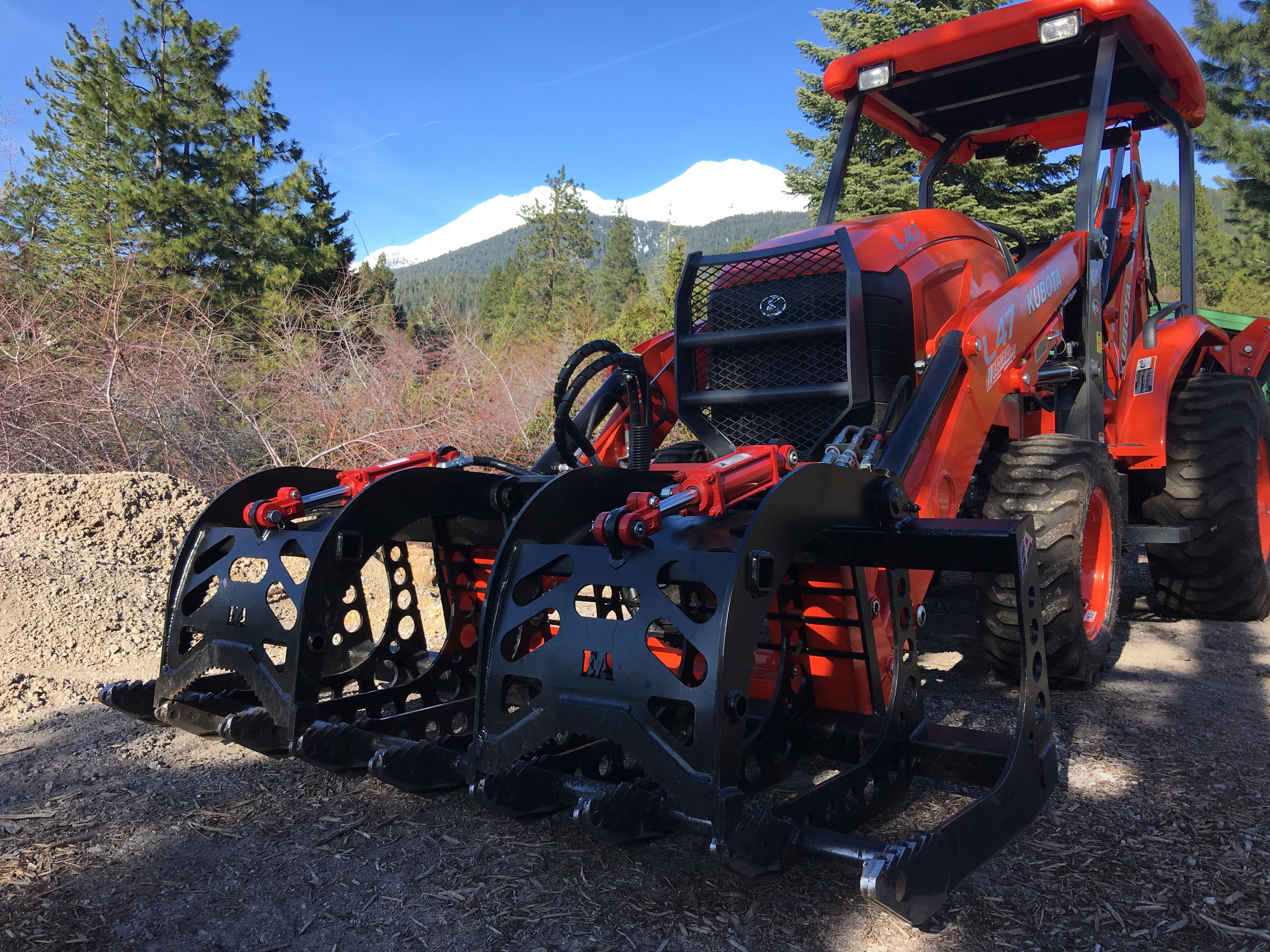

Thank you for the feedback. After sitting here considering the question for a while it occurred to me that the linkage probably wasn't the best thing to save a few bucks on.... Called the dealer and added the linkage on. Next up will be a brush cutter, looking at Everything Attachments, their video's are helpful for a newbie...
   / L47 three point linkage question (first of many questions from newbie) #9
Those boys in NC are great. I bought a grapple from them, which I am extremly happy with.
