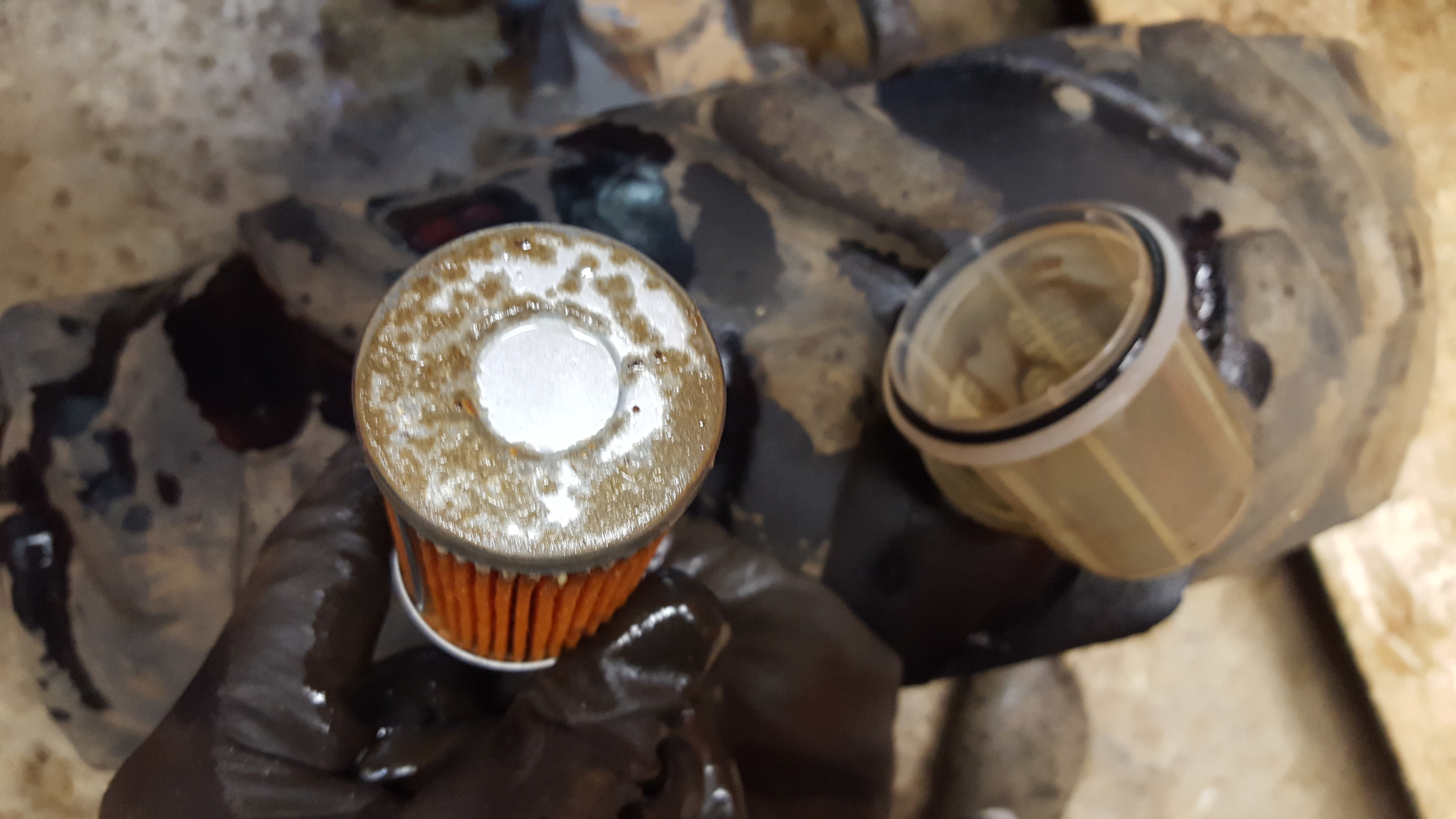

Ok. Performed the test suggested by Kuboman
Cracked each injector open and each one altered engine performance/revs dropped (some more than others) :(
As an aside, I removed the valve cover breather hose to get at the injectors. Is there supposed to be this much smoke coming out of the vent? Kubota knock 3 - YouTube
Not much smoke coming out of the exhaust Kubota knock 2 - YouTube

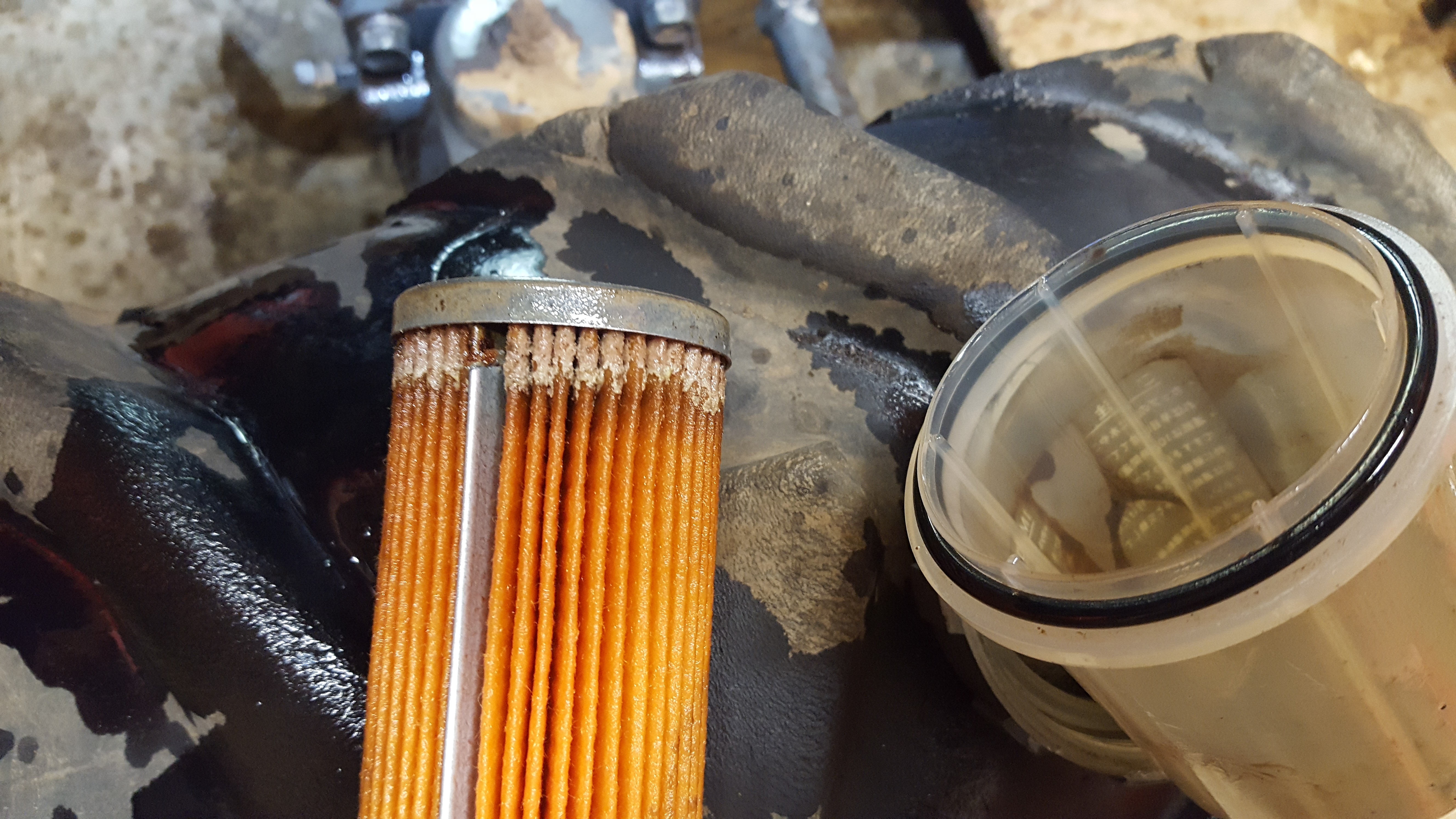

Aside 2. Fuel filter looked dirtier than I ever remember seeing it
It was changed in January
Opinions?
Recommendations?

That #3 video proves to me it's not just an injector. Looks like a ton of blow-by so I would go with rings and/or a broken piston. What does the air filter look like? I ask because the tractor looks pretty dusty/dirty. The engine could also be "sanded" from a dirty air stream. All in all, definitely not good symptoms for such a low hour engine.
SimS
   / L4740 HST Engine knock #10
Definitely more than just an injector. That is a lot of blowby. Is there any muck on the inside of valve cover?
You have serious issues no doubt.
