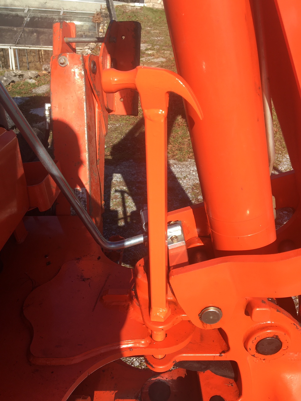

Hi all,
Just got a used L48 TLB. I have the swing pin but I do not see a boom lock mechanism anywhere. No flip brackets, etc. Maybe it broke off, or whatever, wondering what the best way to secure the boom in the up/down position in for transport. I am ordering manuals but not in yet. Thanks in advance.

Messicks diagram shows a locking pin for the boom. Goes thru the boom and operator frame. Not as handy as a hooking type. I’m sure they could probably order one but any good bolt or shaft near that size should work.
The swing lock on my M59 was missing. Made one.

Messicks diagram shows a locking pin for the boom. Goes thru the boom and operator frame. Not as handy as a hooking type. I知 sure they could probably order one but any good bolt or shaft near that size should work.
So that's where my hammer went! :)
BTW, that's an excellent picture of the boom lock mechanism as well. Doesn't the L48 have something like that? Can you post a picture of that area of the L48?
BTW, sometime when I get back to Colorado I'll see if I still have the old advertising flyer for the L48 from back when I was considering whether to get that or the M59... piece of history.

Yes...... my 2006 L48 has exactly the same locking mechanism.....minus the hammer!

Just so I am clear, by boom lock I mean something that will not let the boom arm down, not swing side to side. I do have the Kubota supplied pin that stops the side to side swing, but not the boom bleeding down. The newer stuff has locks on it that not only stops the boom from swinging but also stops it from going down. So it locks it "up" in the full up position as well as anti-swing.

From Messicks website. Has diagrams of the different backhoe components. Any dealer should help you. There might have been changes during the model. Pictures help.
My M59 and B26 have separate locks for boom and swing. Same as many other backhoes I have owned.
