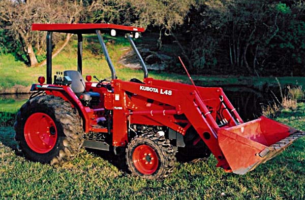

Blake I purchased a L48 not because I liked it but because I loved it. It is a powerful yet compact tractor. I thinks its beautiful, the Angie Harmon of tractors. I have just finished using mine to cut and move approximately 1500 yards of tough material. The Case and JD industrials dwarf it. You can't tow the industrial with a light duty truck, the L48 tows just within the limits of a 3/4 ton truck. The L48's hydrostatic drive is awesome. The loader is very powerful for a compact and best of all the price is just a fraction of an industrial. The hoe is very powerful, perhaps the most powerful and longest reach of the compacts. Its width is a little wider then the JD 110 (a great compact TLB as well) but the overall tractor is shorter. It has a little more power then the JD 110 including HP, loader lift and hoe forces. I found the swing on the L48 to be considerably more powerful then the JD 110. In my area the L48 is a couple thousand dollars cheaper then the 110 and tens of thousands of dollars cheaper then a JD 310 or whatever Case has these days.
The Bobcat excavators I am familiar with are incredible and pretty much the best way to go (excavators that is, not just Bobcat) for most trenching, especially valuable on steep terrain. You mention you are a 17 years old, a baby compared to most folks here. Its good to see that you have the desire for this kind of work. Keep it up as it seems fewer kids want to do physical work so your talents should be well desired down the road. Take Care, Later, Rat...
Here is a picture of my "Ugly" NOT,,,,, L48
