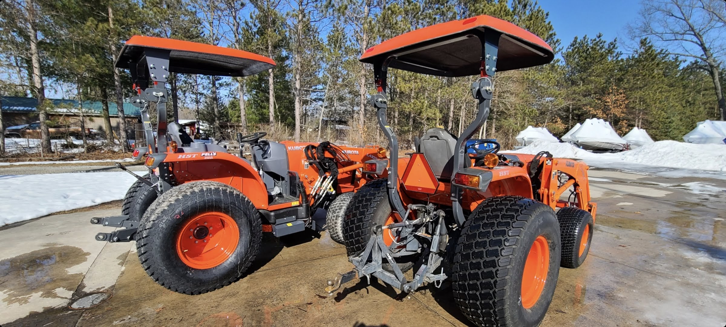

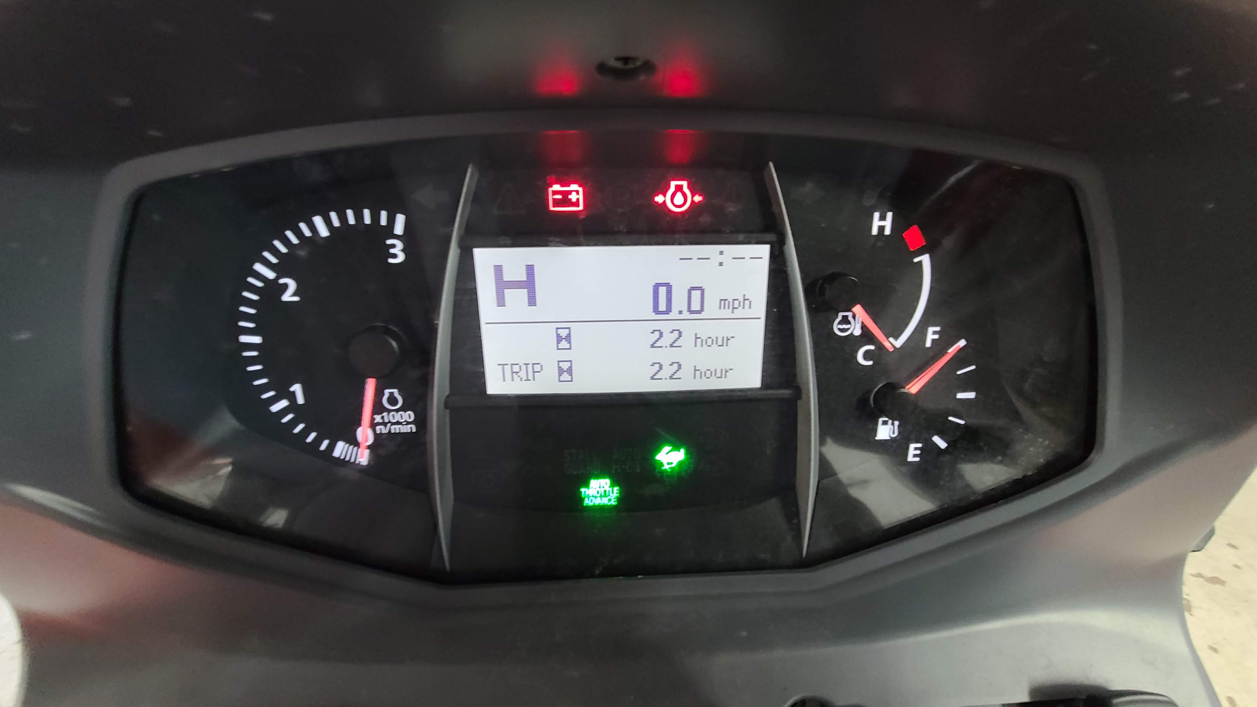

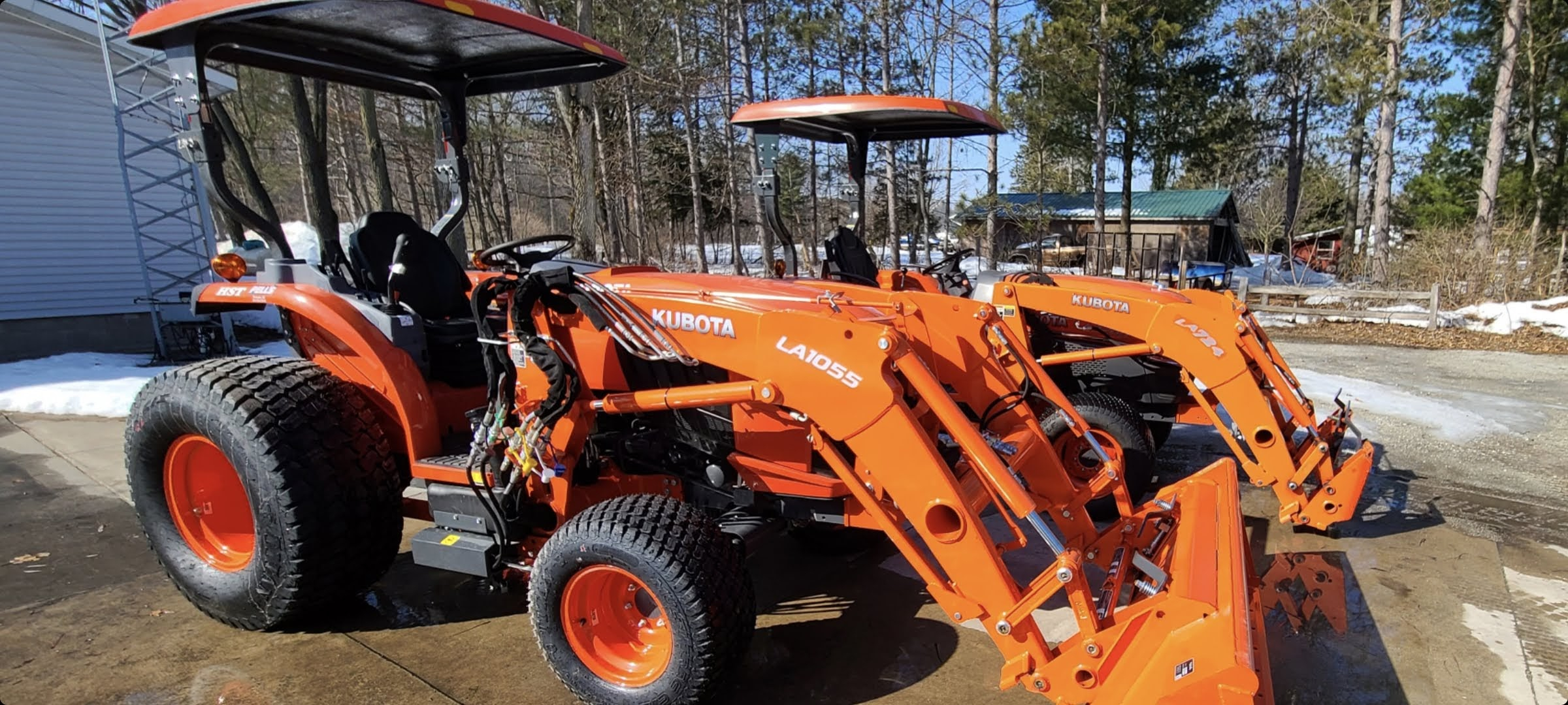

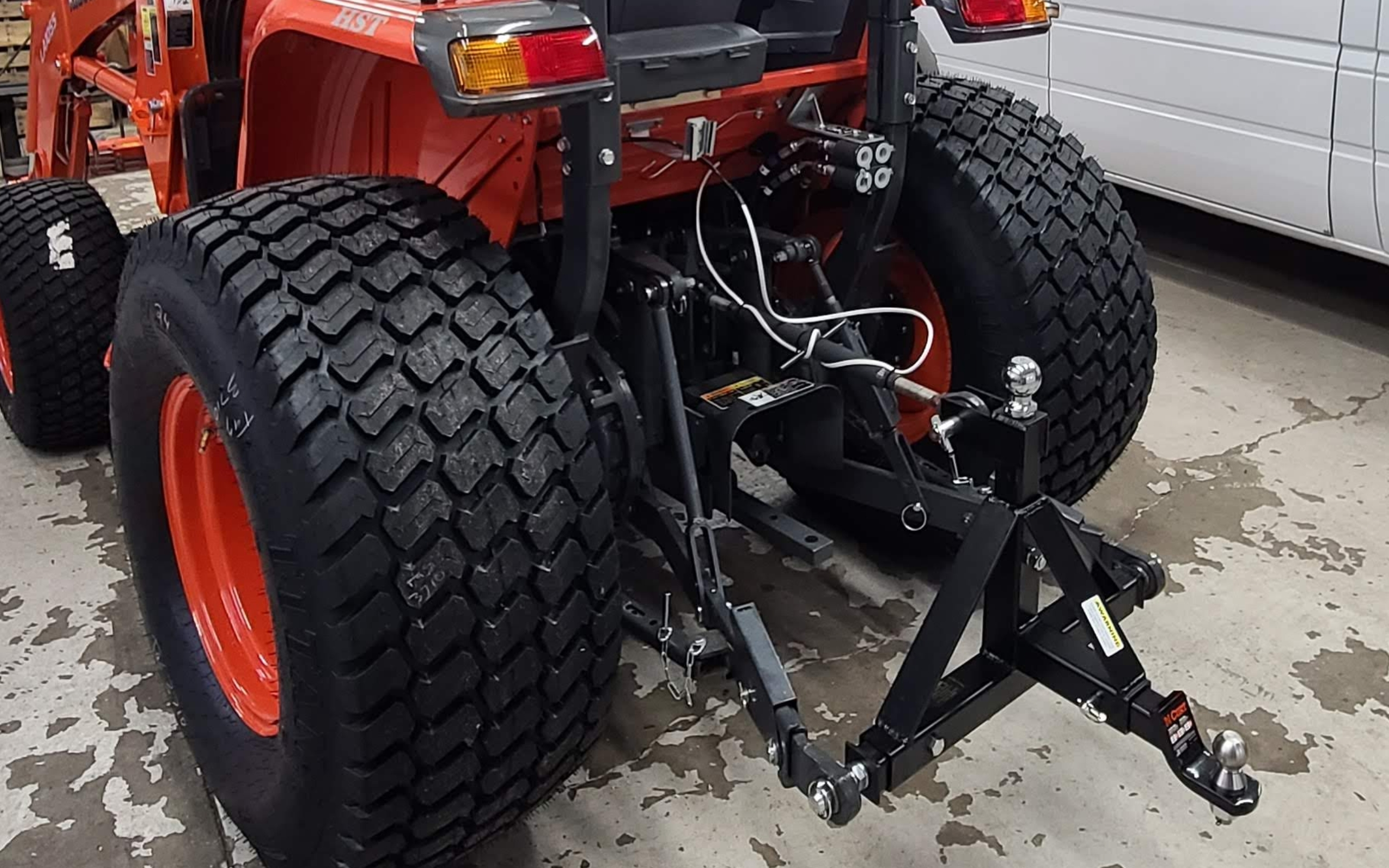

Purchased beginning of January off the lot, added canopy, 3rd, rear valves, and turfs. 2 months later after dealing with back orders its here! Surprised in how much bigger it feels than my L3240, suppose I need to get used to it lol. The L3240 I sold well before the new tractor showed up. Glad new owner allowed me to hang onto it until I recieve the new one. 2 hrs on the hour meter is awesome! Screenshot_20210303-160520_Gallery.jpgScreenshot_20210303-160443_Gallery.jpg20210303_171753.jpg

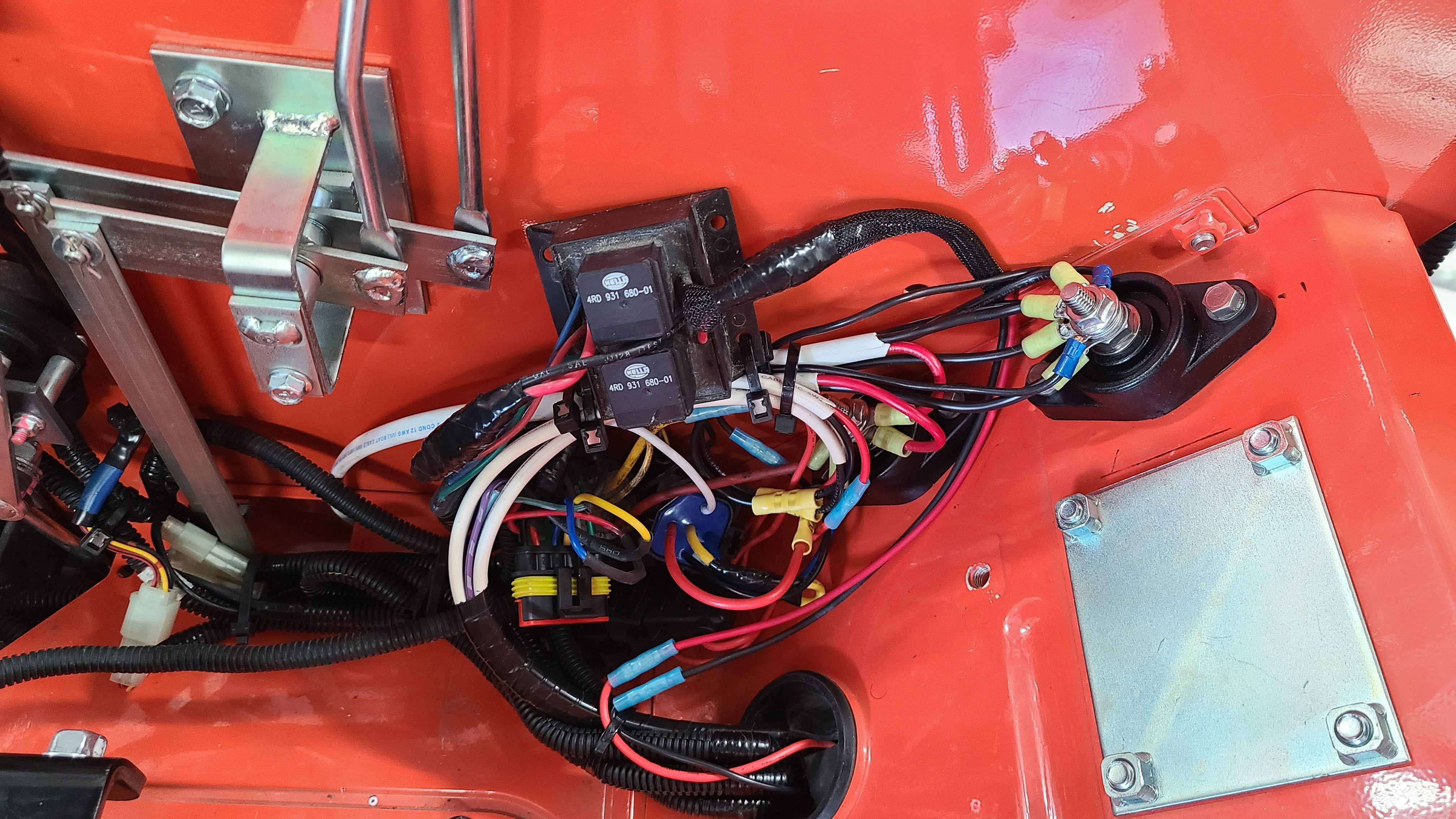

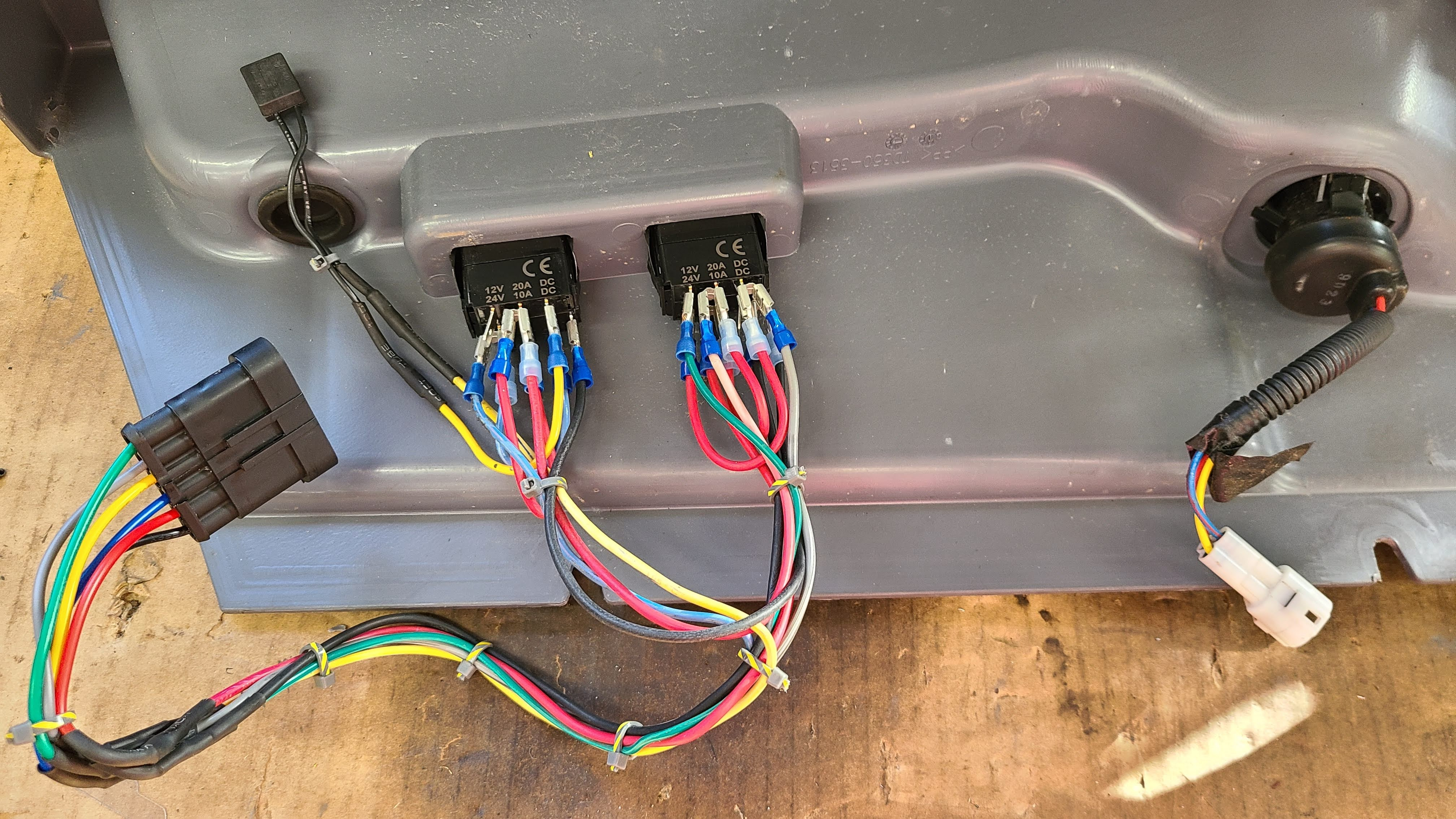

Got a good start on some led lights, going to take a little time to get it wired in with relays with marine rocker switches

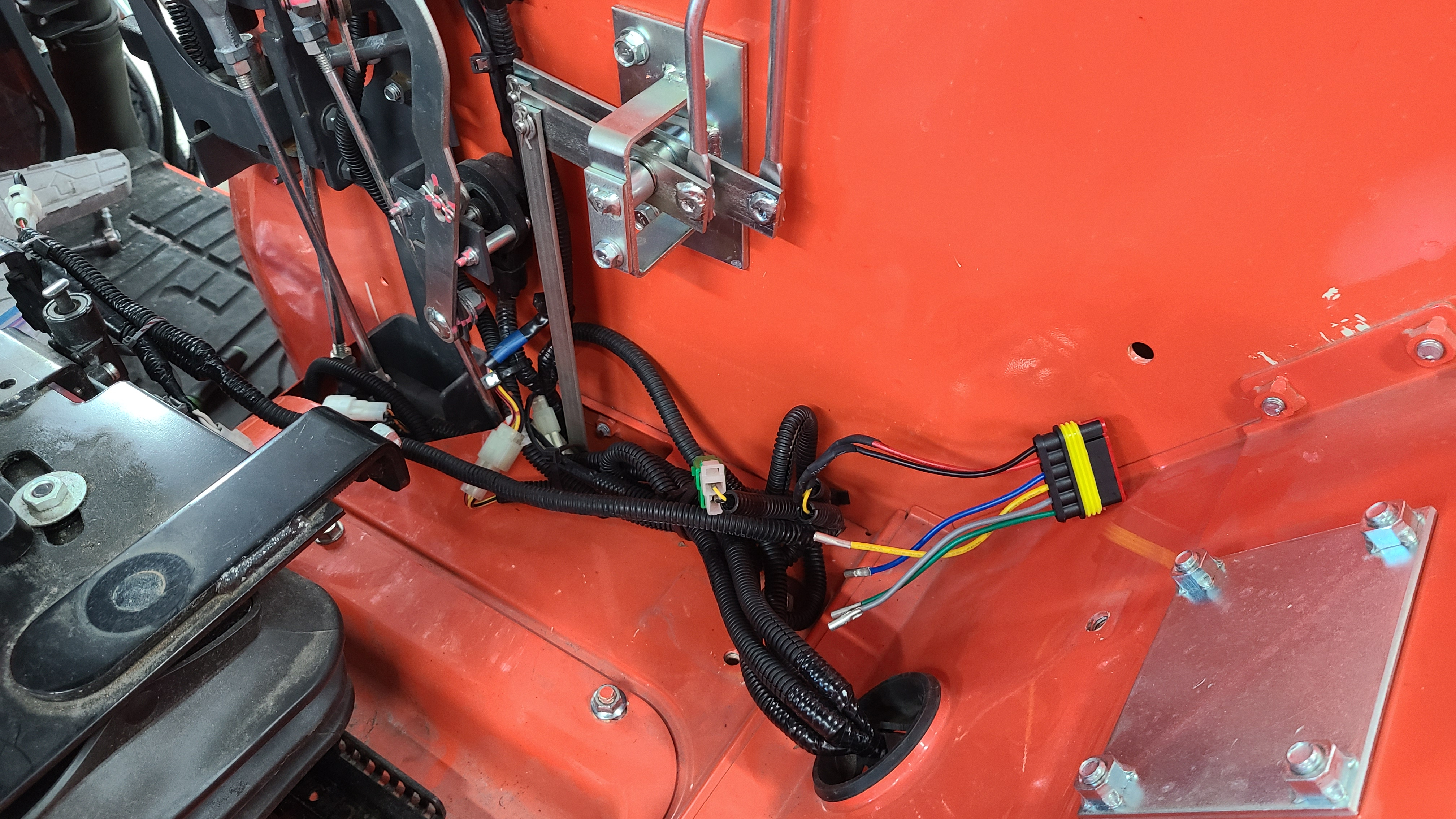

Finished up the wiring... led lights, led amber flashing caution lights, and trailer harness to release electric trailer brakes. All working as wanted. Used misc relays i had laying around, ran 12 gage wire and fused at battery to posts under plastic panel to run fused circuits from.
Plan on adding a hydraulic top link soon.Screenshot_20210307-200743_Photos.jpg20210306_163733.jpg20210306_163748.jpg
