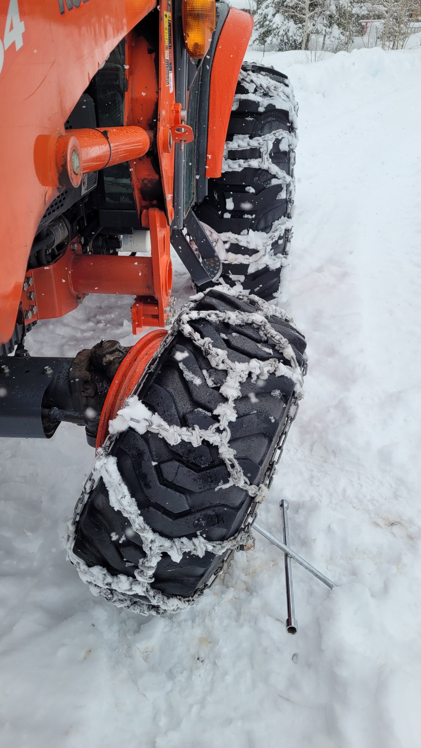

I have a 12 year old L5740 running the original R4's. I just got a flat on a front tire while plowing snow, and the tire came off the rim while I was moving up to a spot where I could park without blocking my own access. This tire has 2 patches already and I'm guessing one failed. I am going to replace this tire, and will do the other front now as well so they match. Ever since thie R14's came out I thought they looked like a good option for me. Any reason other than the higher cost not to change over the fronts while leaving the R4's on the rear? The diameter of a new R14 is only about 0.1" larger than a typical R4 in 10x16.5, I think. Is anyone running R14 Front and R4 rear? If so how do you like it?

A few comments: 1) The small diameter difference in tires you mention is negligible. Don't worry about that part. I assume you know it is rolling radius that matters, not apparent radius/diameter. Still probably plenty close enough to be negligible. 2) Your existing tires do not look bad tread-wise. I would pull the tire (better yet take the whole rig -- i.e. 2 wheels and two tires still mounted to your best local tire shop) with the objective of finding out the real condition of the tire(s) first and second why not put tubes in them?? 3) I just do not hear anything so far that gives you a reason to go changing tires. Seems like considerable cash to acquire questionable, if any, improvement in operation.

If you are using tire chains you will not notice any performance difference.
I would stay with the R4s as they are the most rugged.

The applications where I think I'd like R14 are summer working in forest with soft ground, and early or late season snow when I don't have chains on. I have to travel on our road occasionally which is hard packed dirt and rock, so I can't leave the chains on year-round.

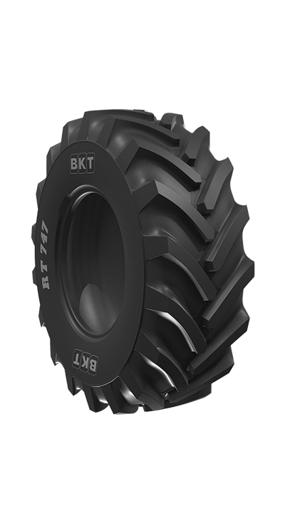

BKT's RT 747 AGRO INDUSTRIAL Tire for Agriculture, Industrial
I like mine and they ride better than the old R4 tires.
