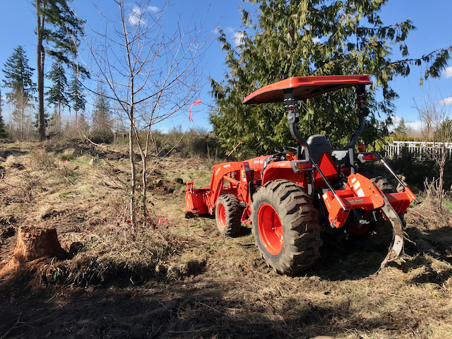

Thoughts and a quick review of my Kubota L6060 now with just over 80 hours on the clock.

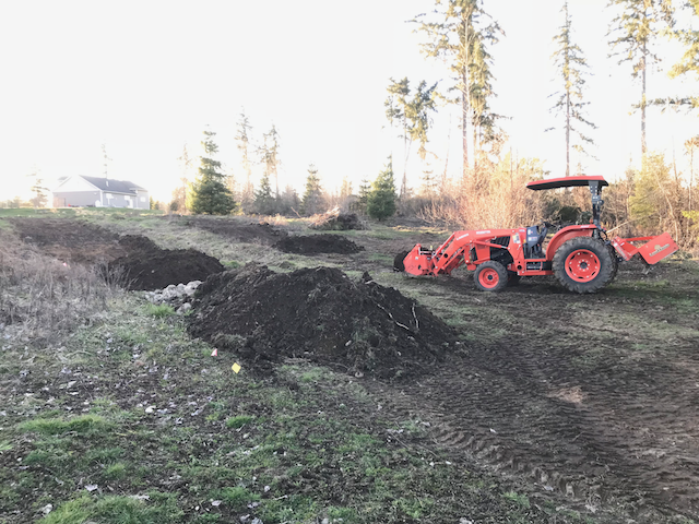

Favorite implement:
4-1 bucket - this thing is MONEY. :D:D:D
After sub-soiling and some of the clearing various 'mini-cooper' sized rocks abound on the property - Mr Glacier dropped a lot of its baggage around a 'few' years ago. the 4-1 is perfect - open, push a bit and close down, pick and move and pile em up. Those that the 4-1 clamshell cant get around I simply do the normal FEL push and tilt. (use the rocks for bases for jumps on the track)
Have a lot of junk trees on the property - black cotton wood, nasty things with fairly (usually) crappy root systems. I cut them off at about the 3 foot level (use the 4-1 to transport and stack to burn piles, then use the 4-1 to rip the remainder out of the ground, and do the same to the burn pile. :thumbsup:
Dumping dirt and rocks EXACTLY where I want it and the ability with the clamshell to meter out the soil as I more (or horse bedding/shavings/manure) is fantastic.
2nd favorite implement/feature
Top and Tilt set up with the quick hitch.
On all of the 3 point implements, and the frequency of how many times I swap out during the work session, the ability to fine tune each implement for the task at hand (without manually adjusting various 3 point settings) and lining up to connect/swap out attachments has probably saved me having to purchase a new step at this point and the related crawling up and down out of the operators compartment. The speed at which I can swap implements and then fine tune, on the fly, 3 point attachments while working or transport to and from worksite is simply priceless. I wouldn't have a fraction of the amount of work completed if I didnt have the 3 point (and supporting quick hitch). Period - the time savings and flexibility the combined system provides is a MUST have.
Next up = Box blade.
Virgin dirt, never been worked, was old growth forest, logged, then sat and sold for real estate.
Doing a lot of leveling and scarifying the dirt so I can level etc and of course the box blade
For what I am doing in the pasture and then MX track (jumps etc) is to run the teeth in the lowest full extended position.
I tilt the box full forward, rippers down and loosen my work area, as I am rolling to the end of the section, use the top and tilt to lower the rear blade down, rock the HST pedal to reverse and push - amazing the amount of dirt work I can do with this method, and fast with the HST - and using a combo of the 3 point lift and the tilt function - can effectively float fill any areas or build up areas quite smoothly as I push (building jump faces or filling low spots in pasture)
