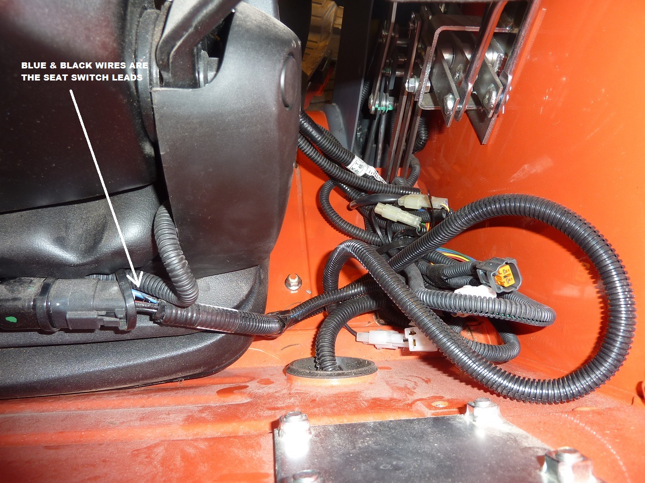

Anyone figured out how to use the PTO for stationary use with the air ride seats. I've read on this forum that the air ride seat will not permit use of the PTO when the operator is not seated. I contacted my dealer and he thought that wasn't right but after checking, he said it's true but has not got back to me with a work around. I read some people put a heavy object on the seat but I would prefer a better method. On my current tractor the engine would shut down when running on rough roads. That would cause me to bounce up and down, which would open the seat switch contacts. I simply put a jumper on the seat connector and bypassed the circuit. Not sure if that is possible with the L6060 (I don't have it yet so I can't look at the electrical connection setup). I can't bypass the entire connection either, as I still need the air pump to function. I've heard that some tractor computer systems monitor the seat switch to see if it opens and closes and if it goes for too long without activity it will shut the tractor down, thinking there is an electrical problem. Certainly don't want that because a service call to my place would not be cheap.

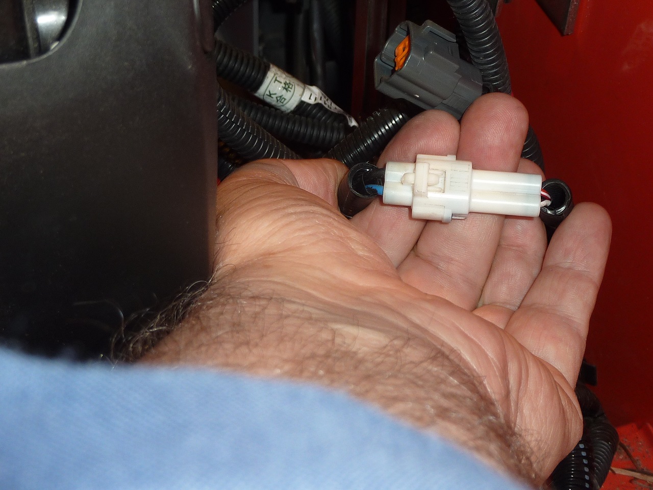

Just looked at my L5060. Four wires in the harness leading up to the seat. Then they split into two pair. One pair leading to the sensor in the seat and the other pair of wires to the plunger under the seat pedestal. Each pair has their own disconnect before reaching the switches.

1 sensor is to detect if somebody is in the seat, the other is to detect if the seat is flipped up or not. You can run the PTO with the seat up, but bumping the go pedal will kill it. If the seat isnt flipped up & the weight sensor isnt tripped it will kill the tractor if PTO or the go pedal is activated. If I recall my L3200 had 1 sensor with 3 wires. I presume the lever on the 1 switch registered seat up, down & weight in the seat depending on position.
At least on my old L3200. A zip tie kept the weight sensor down on my machine so I could stand & look at the forks. Never had a PTO impliment that needed to run with me off the tractor. It's a non-issue for me now as I can't stand up in the cab.
There is no way to flip the seat up if you up if you have the air ride seat. So presumably that seat lifted wiring is either shorted or open, depending on how its setup. I'm sure you could jumper wires appropriately if you looked at the schematics and/or messed with a multimeter on the wiring harness & switches for a few minutes. Safest way would be to put in a switch rather than permanently defeat the safety mechinism.

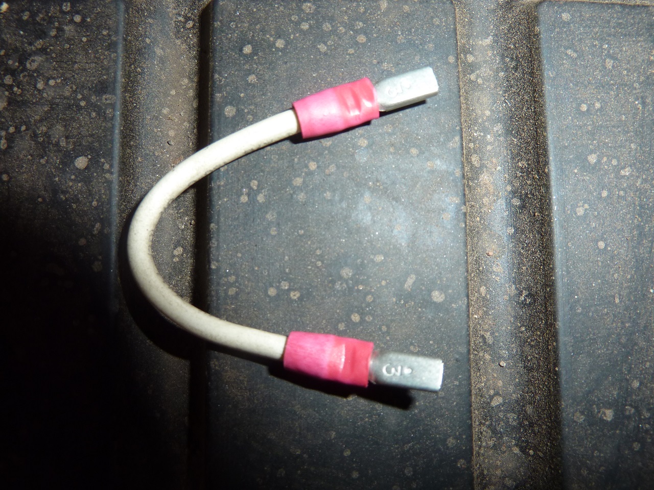

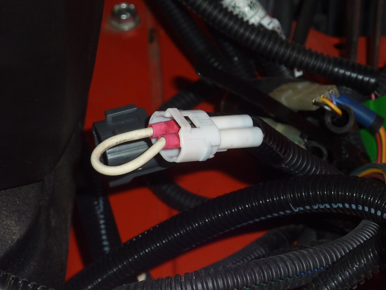

Thanks! It sounds like it will be easy to jump one of the sensors to allow stationary PTO use. If it is as easy as I think it will be, there is no need to permanently disable the safety switch. Once I know which of the connections to jump I could label it and simply disconnect that plug and jump it for the few times I need to run the PTO in a stationary operation. If I find I need to do that too often then I can add a separate switch to replace the seat up one.
