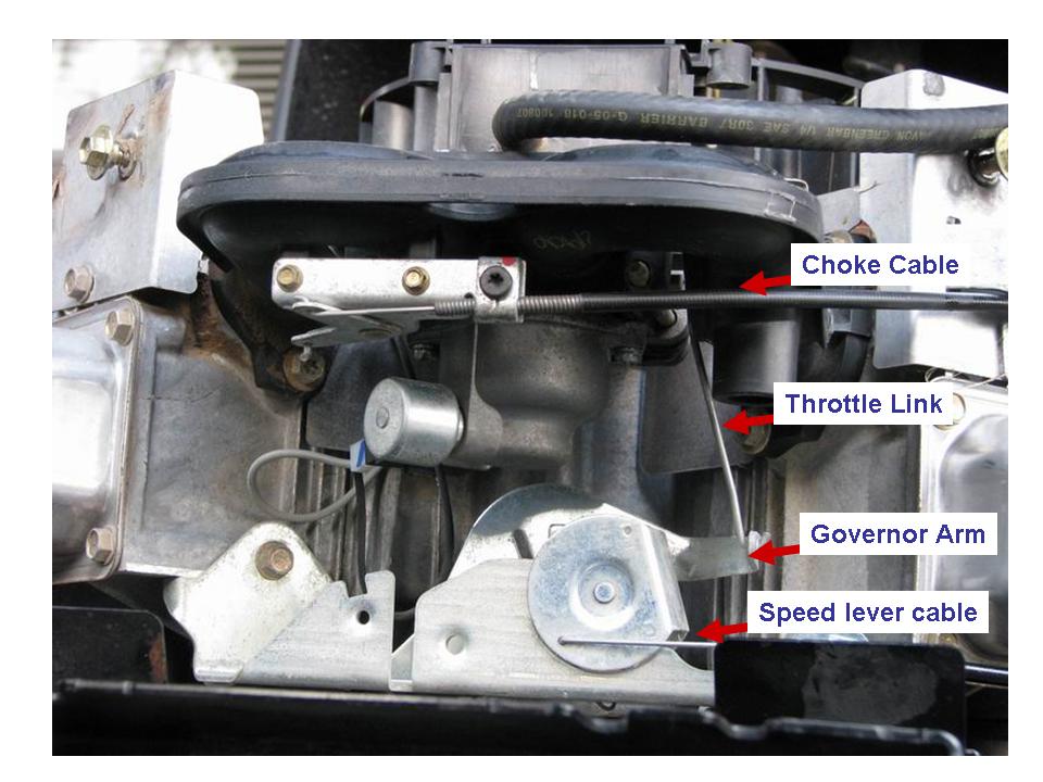

Recently I have started having a problem with my wife's 145. It starts rough, usually with a bit of smoke, and then it continuously revs up and down. It's like you are pumping the gas in a car while in neutral.
I am no mechanic and I can't figure out what it is. I have no intention to start pulling things apart until I have an idea about what it might be.
Can anyone point me in the right direction????

I'm not so sure that your problem is a plugged jet. It sounds to me like your governor linkage may not be right or a spring may be broken. Look at the first photo below. This view below the carbs shows the governor arm clearly. When you increase the fuel control lever, spring tension overcomes pressure from this arm and the engine increases speed. As speed increases, the arm will have more tension and overcome the throttle spring to cause the engine to come to an equilibrium in speed. If the governor is adjusted wrong, the engine's rpm can overshoot the equilibrium rpm and oscillate in rpm above and below the proper speed. In the second photo, you can see the whole governor arm and mechanism because the carburetor's have been removed. Check for a loose or broken spring and also any bending of the arm that may have been done inadvertently or perhaps trash that is interfering with the governor's operation.

Anything being out of whack or missing can make the motor "hunt" like that.
   / LA 145 Engine Reving #5
Check the following: Will the engine idle without surging? If not, the idle passages are plugged. The fuel jets for idle are tiny, and plug very easily. This is much more likely than a governor problem. Fuel related problems are the most common of all lawn equipment run problems.

I will take a look at the governor setup and see how it is. The engine does not idle though. If I drop the throttle to idle it sputters and dies. That was part of why I thought some garbage got into the carb. One if my dogs bit through the fuel line last fall and I had to replace it so I wouldn't be surprised if a piece got in.
   / LA 145 Engine Reving #7
Eric makes a good point. Be sure to check for contamination in the carb, but keep an eye on that governor's operation too. You can put your hand on the governor rod to see if you can damp out the oscillations. Also be sure to check the engine oil level. If the engine gets low on oil, it can cause surging through the governor because the governor is normally oil pressure driven.
Is this specific to this motor? I know that there are a couple of different kinds of governor systems in use, including one that operates off of *air pressure* created by the fins on the flywheel of the motor.
   / LA 145 Engine Reving #9
You are absolutely right for smaller engines, but the larger engines don't use the vane type. The photos I posted showing a shaft going into the engine crankcase are of the actual engine on an LA145.
   / LA 145 Engine Reving #10
I wasn't challenging what you said... Was just asking if this particular style was specific to this motor. I know that most small engines use the flywheel to create air pressure because it's a simple model. And, I was curious as to what made this "different".
