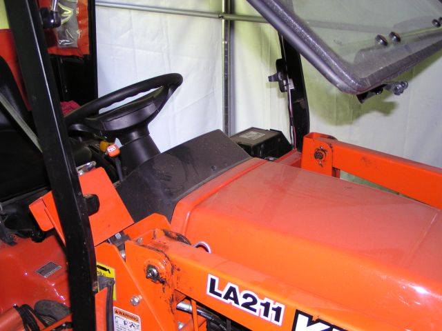

Now to your other question. I have a BX2200 and a Curtis Cab and suffered through loader removal of an "alternative" nature. This included removing the pivot pins on the loader arms instead of the one main disconnect pin on the upright. A MAJOR pain in the butt! /forums/images/graemlins/mad.gif
Then I found that all you need to do is open the windshield and disconnect the bottom hinges with the little spring clips. Push the windshield wide open and the top of the "firewall" part of the cab comes right off. It's only set in with pins, no bolts or nuts or anything. Now the loader can be removed in the usual way.
Here's a picture that will hopefully illustrate what I mean. /forums/images/graemlins/grin.gif
