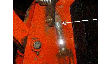

I put the factory fix kit on the Q/A and thought I would relate some info.
It went on easily, it basically is a bushing fits inside the spring attached to the top of the q/a pin. With the bushing the pin cannot lift out of the tab spot.
It doesn't fix bad fitting q/a plates but does fix the tendency of the ramp on the pin face to slide up against the spring.
I'll try to get pics or scan in the instructions.
Part number 7J266-99200 price $13.79

Do you know if the same kit works for the Q/A on a LA723? I have popped attachments off of mine a few times. A real problem when you have hydraulic connections.
Vernon
P.S. I added washers above the spring to give more compression and that has helped.
   / LA 853 Q/A dropping buckets - Kubota fix kit #6
I did the washer fix also. It has worked foor the last 1.5 years. See the attached picture.
The washer fix is sort of a cheat and doesn't work as well. Unless you add so many washers that the spring bottoms out, the pin can still rise out of the q/a. There isn't a good way to add that many washers and still be able to adjust the pin depth of engagement.
With the kubota kit I added a single washer in with the spring stack so there is zero spring action left on the q/a for my main bucket. It solidly pins in place.
Hard to explain but basicly the kit replaces spring action with a solid acting rod.

CT, the thing is pretty strong, but kubota chose at first to leave some spring action so poorly built q/a plates would fit. They should have used much stronger springs though.
The washers add preload to make the pins reach a certain load before they move but once it hits that point the springs are no stiffer and just give way.
The kubota kit gets rid of the spring action so the pin physically can't retract like the original one.

With mine there is only enough spring action to keep the over center latching of the levers. On one of my attachments the springs are fully compressed just before the levers over center, takes a bit of extra effort to latch. The pins, therefore, can only move up 1/16 to 1/8 inch before the spring is fully compressed. Those are eyeball measurements of course.
