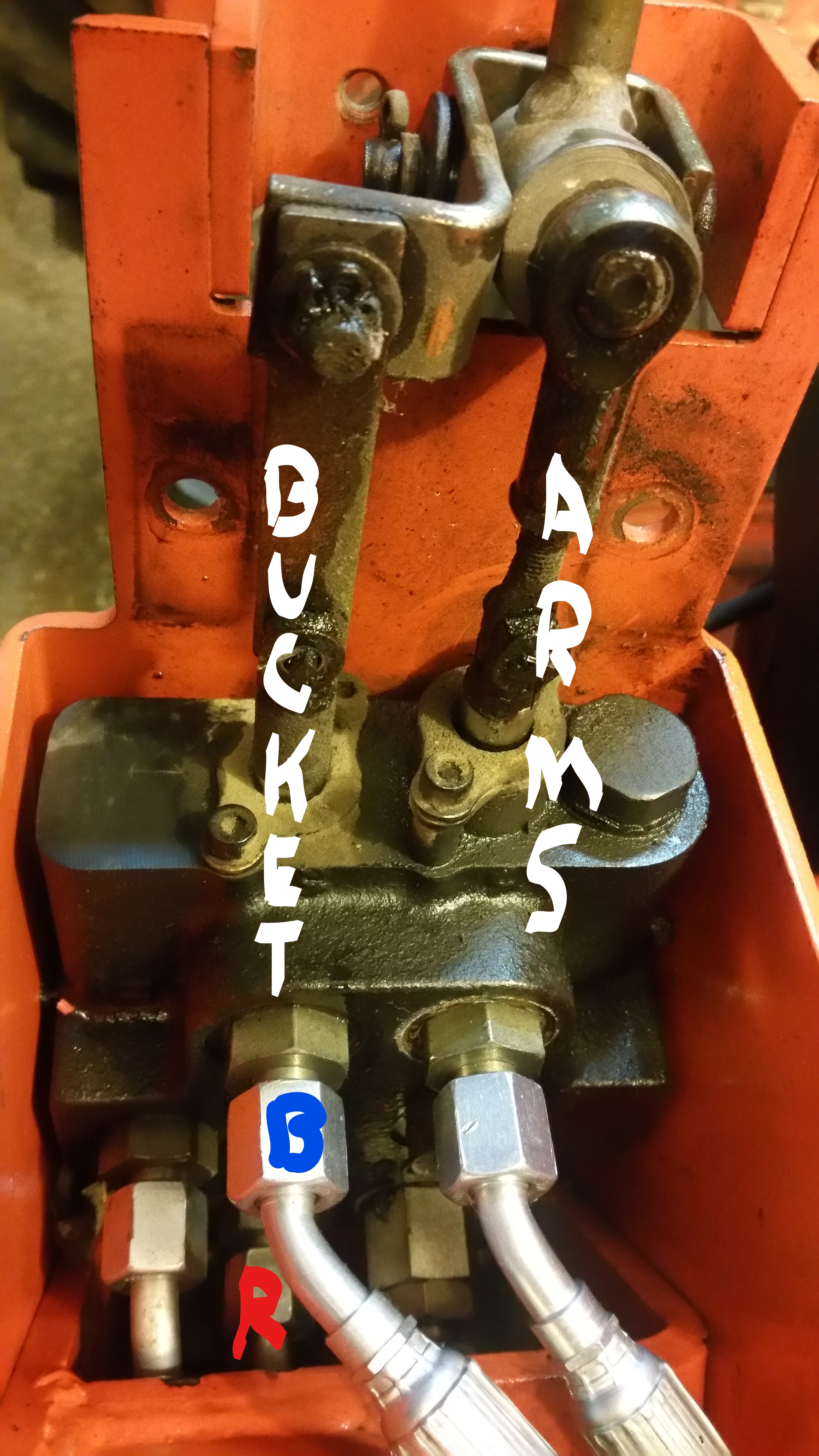

I believe it has with one item. It showed me that the blue and red tape lines got to the bucket.
I don't seem to have yellow tape on on my other two lines. I am assuming they are the arms for the loader.
It seems from comparing you pics to my lines that things work on the valve with out and return flow. Top to lines are out and bottom two are "return". Yes/no?

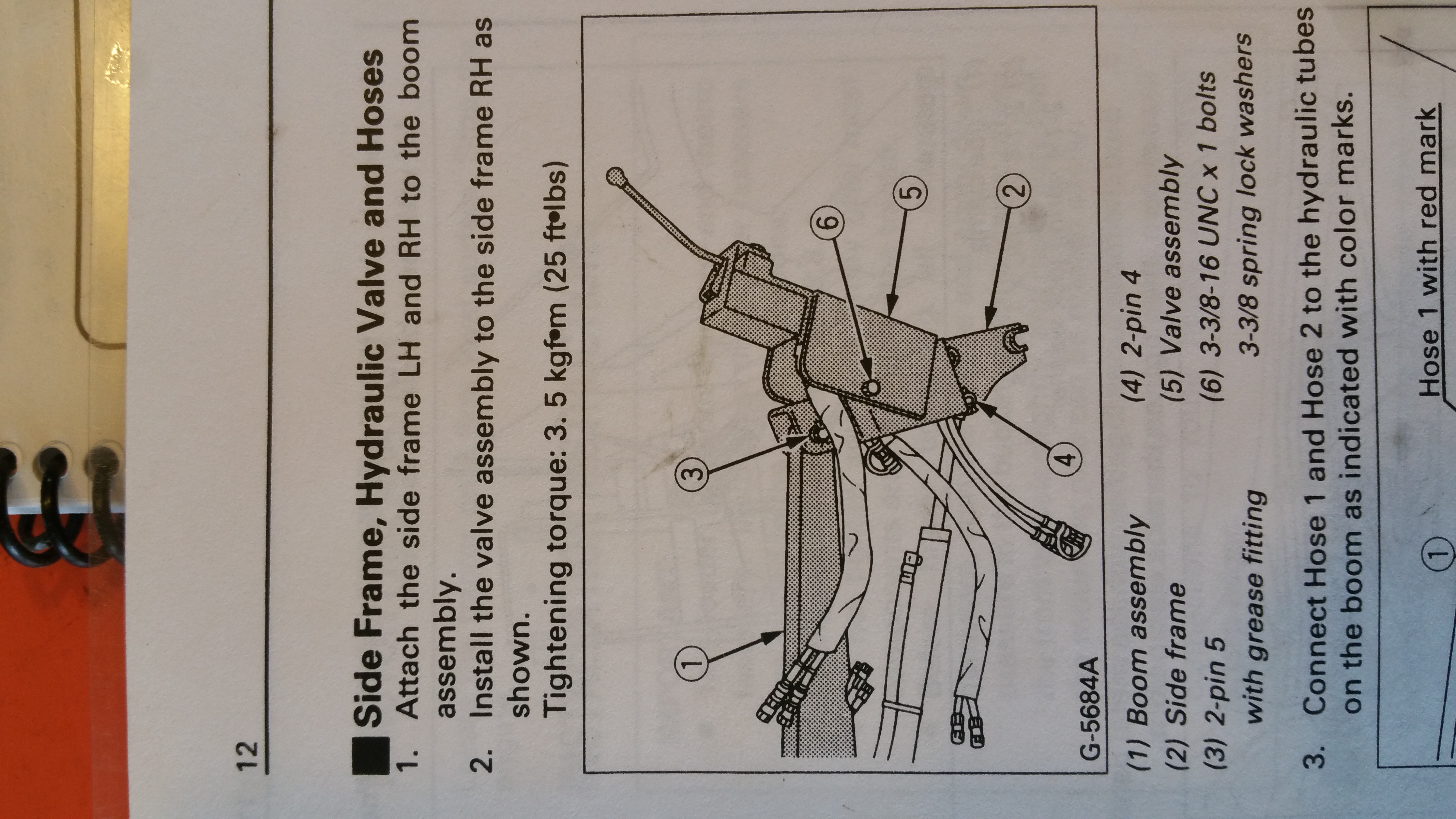

download kubota book and you get all the diagam hope you get it mario

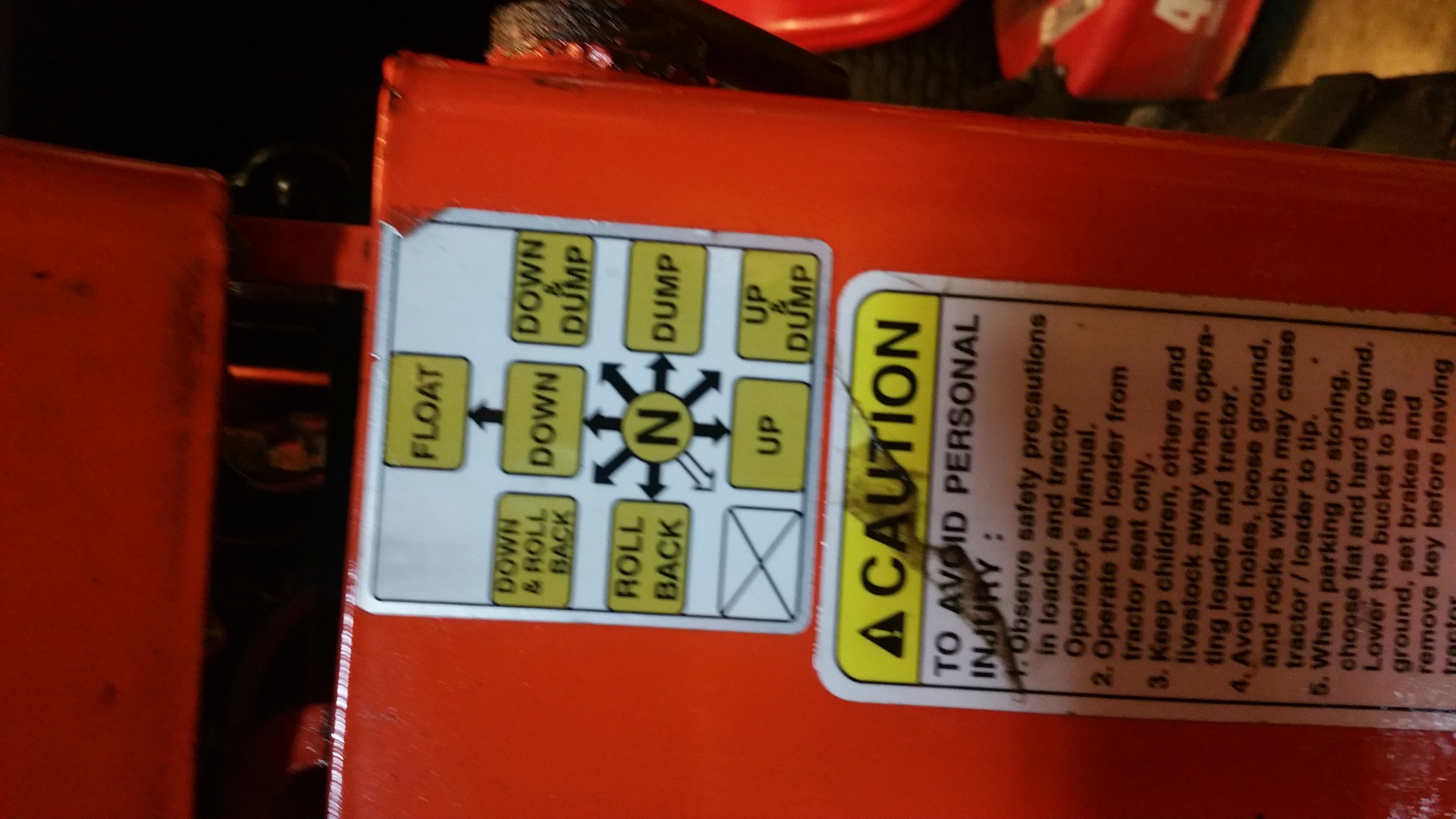

Things are working guys.....thank you TripleR for your photos. Those pics sent me down the path I needed to go. I connected up with the colors on my loader with Red and Blue tape I had on mine. My other yellow and white tape were long gone. I had the red one mix up with white or yellow. I opened up the cover on the valve control and took a picture. Hope this helps the next lost soul. The red and blue are the bucket control and are on the left as you look back at the control from the front. mjym... I appreciate the replies, those links just took me back to the current world of kubotabooks.20170401_101757.jpg20170401_101744.jpgValve.jpg20170331_210906.jpg
