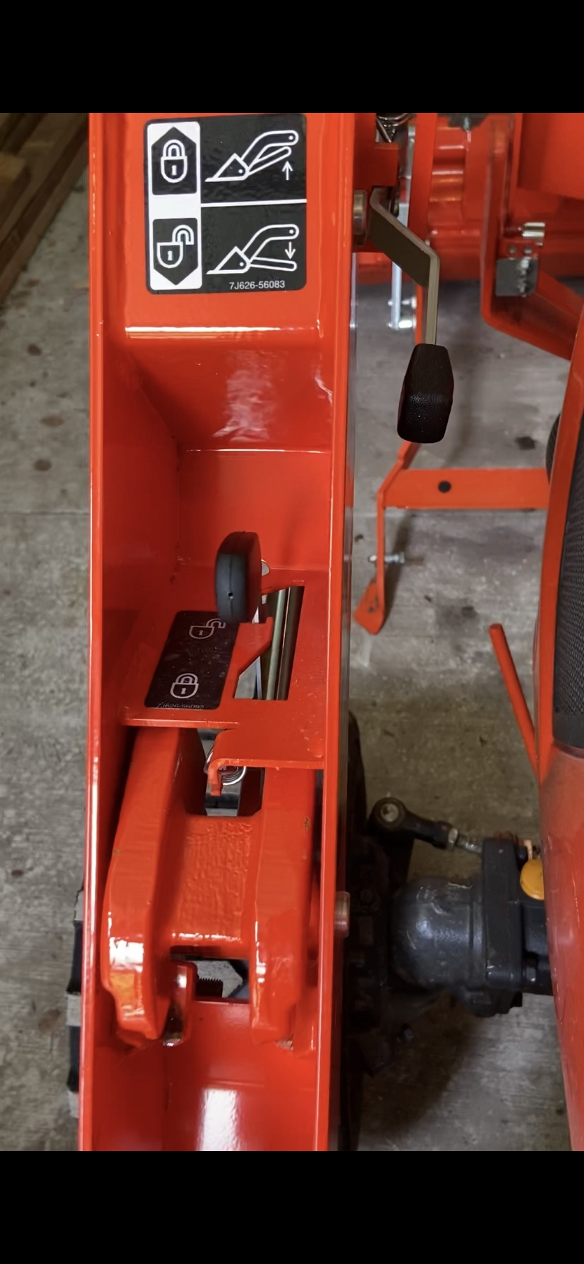

Made a descent video, won’t let me attach. This is the lever that won’t lock in. ( pic of left side). Right side is the one that won’t lock with out force from pry bar.
   / La344 loader #10
Oh Geez. That is much newer hardware than mine. I have no experience with that at all. Just curious, I see 2 levers each with a black handle tip. Which one is it that won't lock for you? [I realize your photo is left side hardware. Mirror image of the other side no doubt.]
   / La344 loader
#11
The bottom Left is lever is the one that locks. Top right is once locked. Lift bucket, roll an stow kick stand. Right side only has on lever for lock.
   / La344 loader #12
I'm sorry but I am not following you -- "Top right is once locked." What does that mean? Maybe a typo?

On the left side of loader arm, there are two levers. Bottom is for locking on. Top is for stowing kick stand.
On the right side of loader arm, only one lever. -Just for licking on. Right side is the one I’m having issue with.
