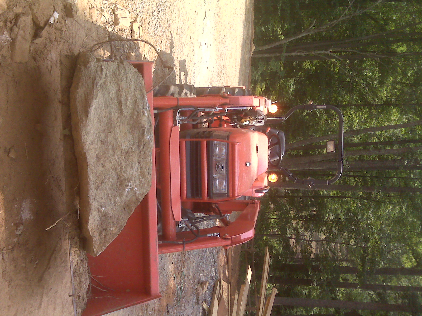

/ LA463-Sheared Loader bolt?
#12
Here are some pics..
Image 87 is the pins with the new bolt..
Image 88 is one of many rocks I was moving!
Well, the end result is not enough grease..
I guess all the dry dust ate it..
I was hitting it about every 10 hours..
gonna watch it closer now!
Later,
J
/ LA463-Sheared Loader bolt? #13
Thanks. I was picturing it all wrong.

/ LA463-Sheared Loader bolt? #15
krackerjack, I think you are thinking about the wrong pin. The pin to remove the loader is below the pin he had trouble with. Look at his picture and you'll see that pin just below it.
I think the zerk fitting for the pin he had trouble with is on the underside of the loader boom....but then again I'm may be remembering things wrong again. But I'm pretty sure that pin has a zerk fitting. The pin you remove to take the loader off does not have a grease fitting.
