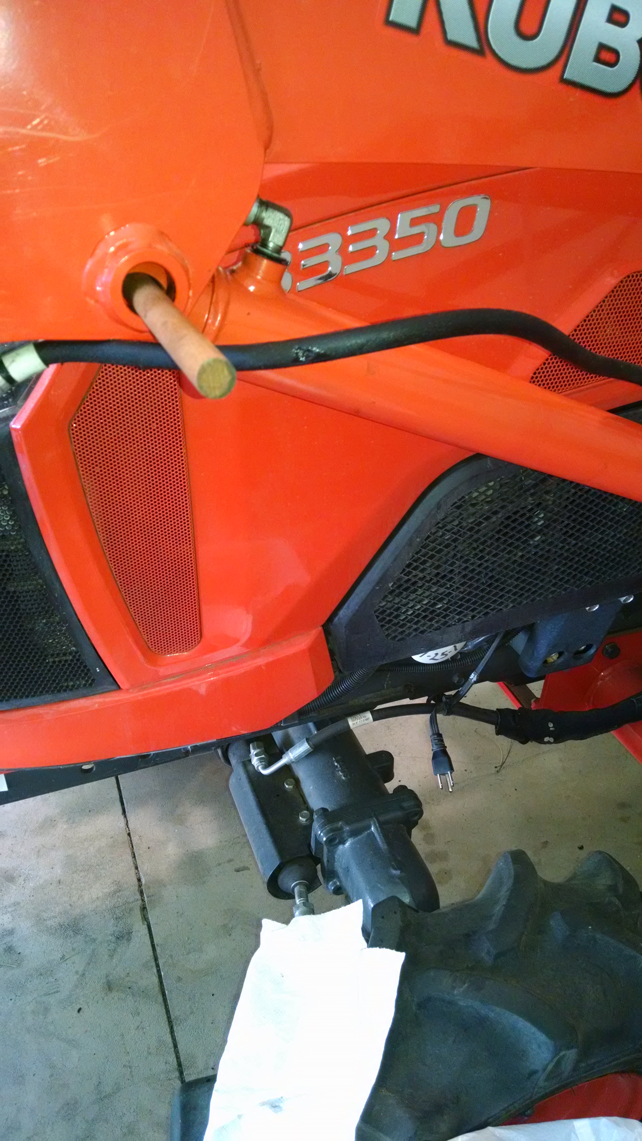

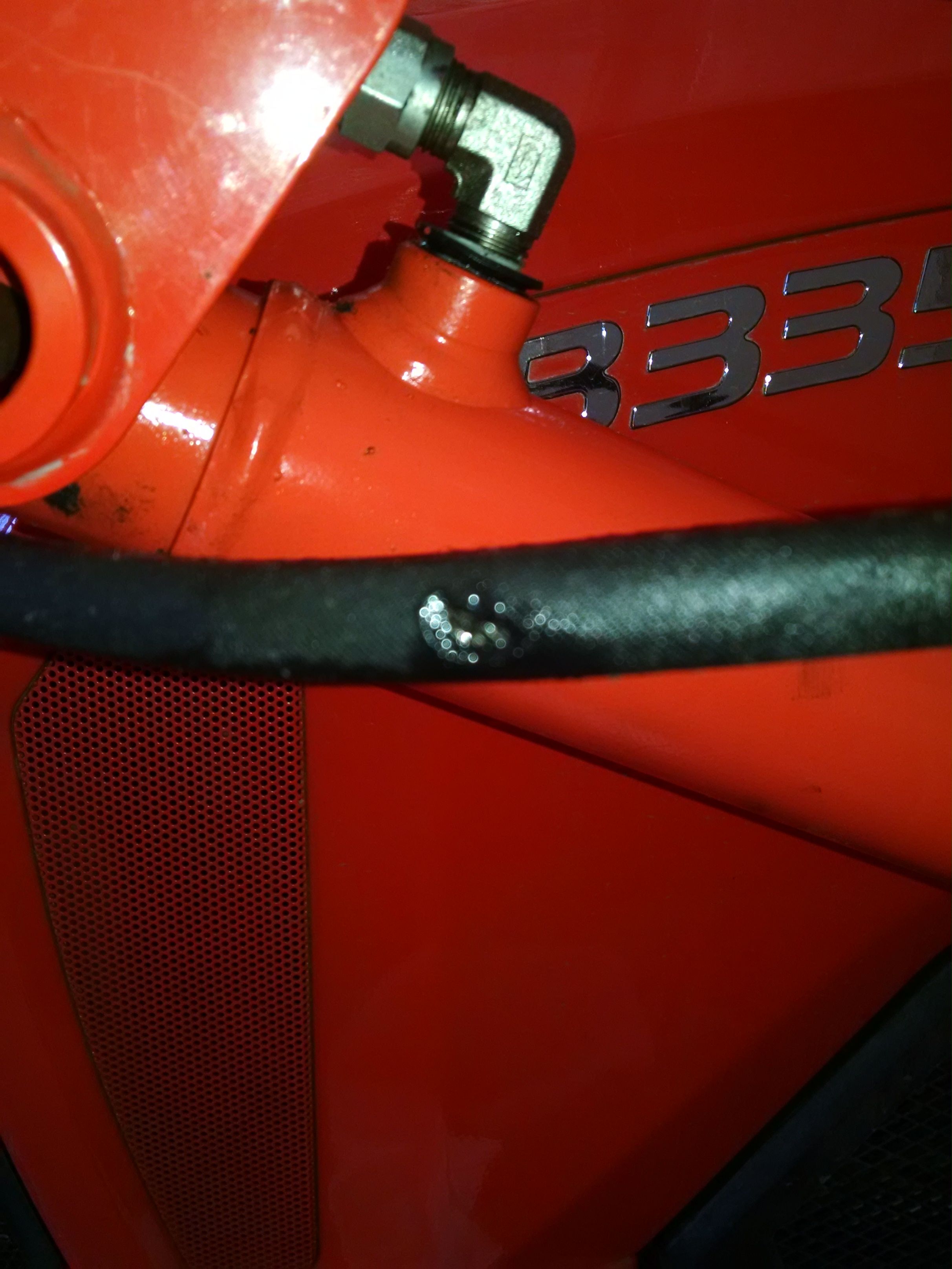

Kubota owners with the LA534 FEL should check their hoses ASAP.
I discovered a leak in the hose that feeds the left lift cylinder. This was caused by weld spatter inside the arm that rubbed on the hose. A fire could occur if a hose bursts and fluid hits the exhaust.
If anyone has influence with Kubota, please bring this QA problem to their attention.
