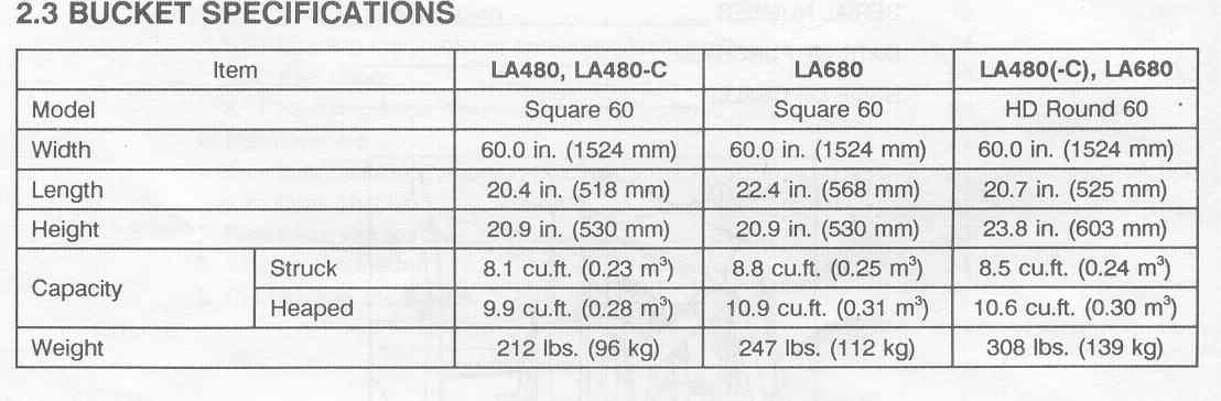

I need a favor - I have a LA680 FEL on my L4200GST w/ HD bucket. I need to know the width of the bucket (specifically across the rear bottom edge) and my tractor is not here. If anyone knows the dimensions of the HD bucket, please post them.

Here you go JayC...

YOU da man!!
Wow - only 5'. Actually narrower than the rear wheels (especially on your machine w/ the fat turfs) - who woulda guessed. I'm fabricating a mounting bracket today for a landscape rake thingie I made yesterday - and my tractor is 50 miles away (waiting for the rake). I would've definately guessed wider than that - you have no idea the disaster you just averted...:)
