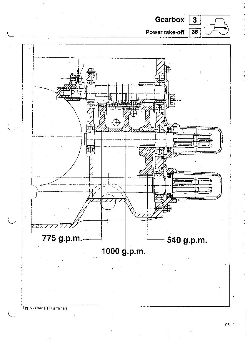

I have a Lamborghini 674/70 2WD...When I run an implement on the PTO, oil leaks from around the PTO Shaft..When I'm not using the PTO, it's fine...
I've replaced the sealing ring around the PTO shaft but it's leaking as bad as ever...is there a bearing in there which could have gone and is causing the shaft to wobble slightly, thus destroying the seal and is it difficult to replace?...
I'm trying to find a low cost fix and any advice would be much appreciated
   / Lamborghini 674 leaking oil around PTO shaft #2
I know on my Kubota that there is a bearing w/ seal in the pto housing. I had to drain hydraulic oil and remove housing and shaft recently for a repair. I replaced o ring seal where housing seats into case. I could see bearing in the housing at that time, in which mine was good and so was the outer seal.

Lamb PTO.jpgIf hydraulic housing can not breath it will press oil out everywhere

The pto bolts to an inner shaft...is it difficult to remove the inner shaft for inspection?...looks like I can gain access below cab

..Have the workshop manual and have checked bearings...seem tight...have removed breather and cleaned it as there was a load of oily chaff/crud under it..
Rather than dismantle the whole back end am gonna try a new seal (again)...fingers crossed

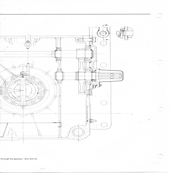

I can put photos on using photobucket
I can put the schematics on for posterity, in case some other unlucky sod has to scour the internet for schematics
Have put the seal in (carefully) and ran PTO with a hay bob for ten minutes and....so far so good...no leaks
