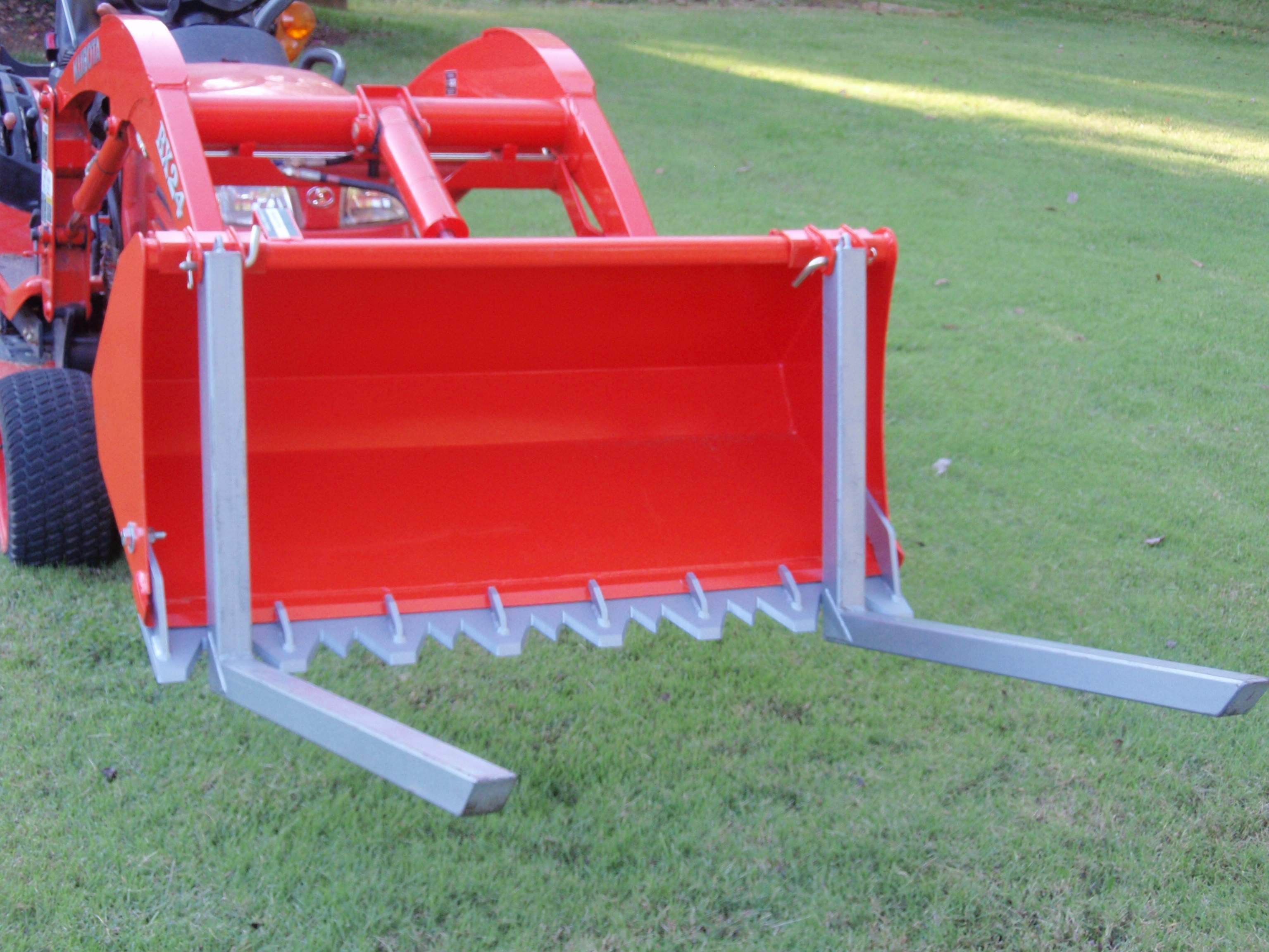

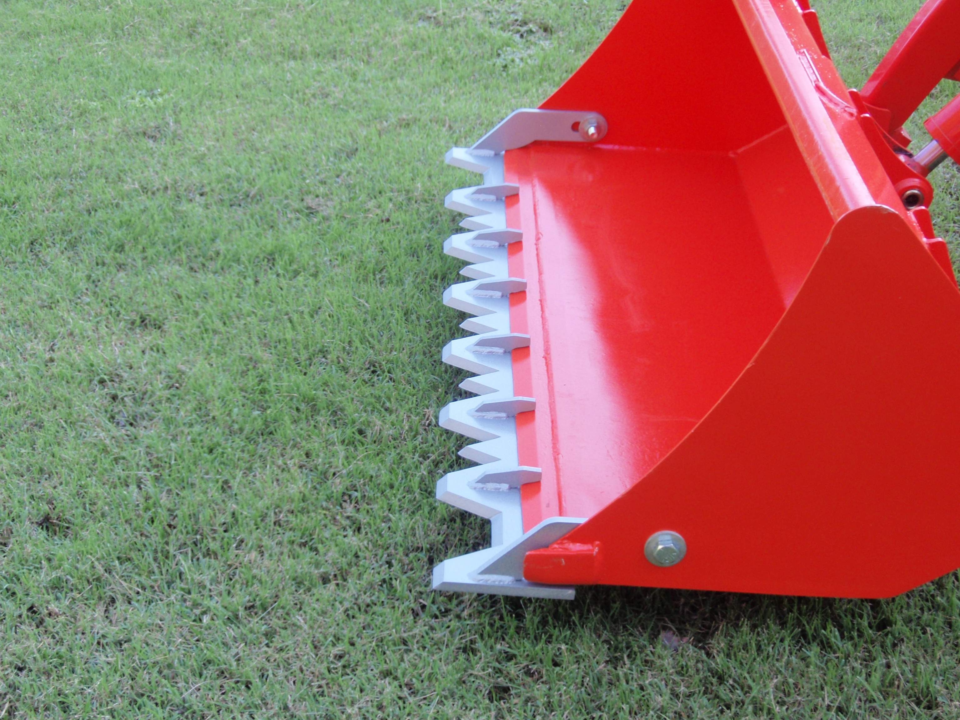

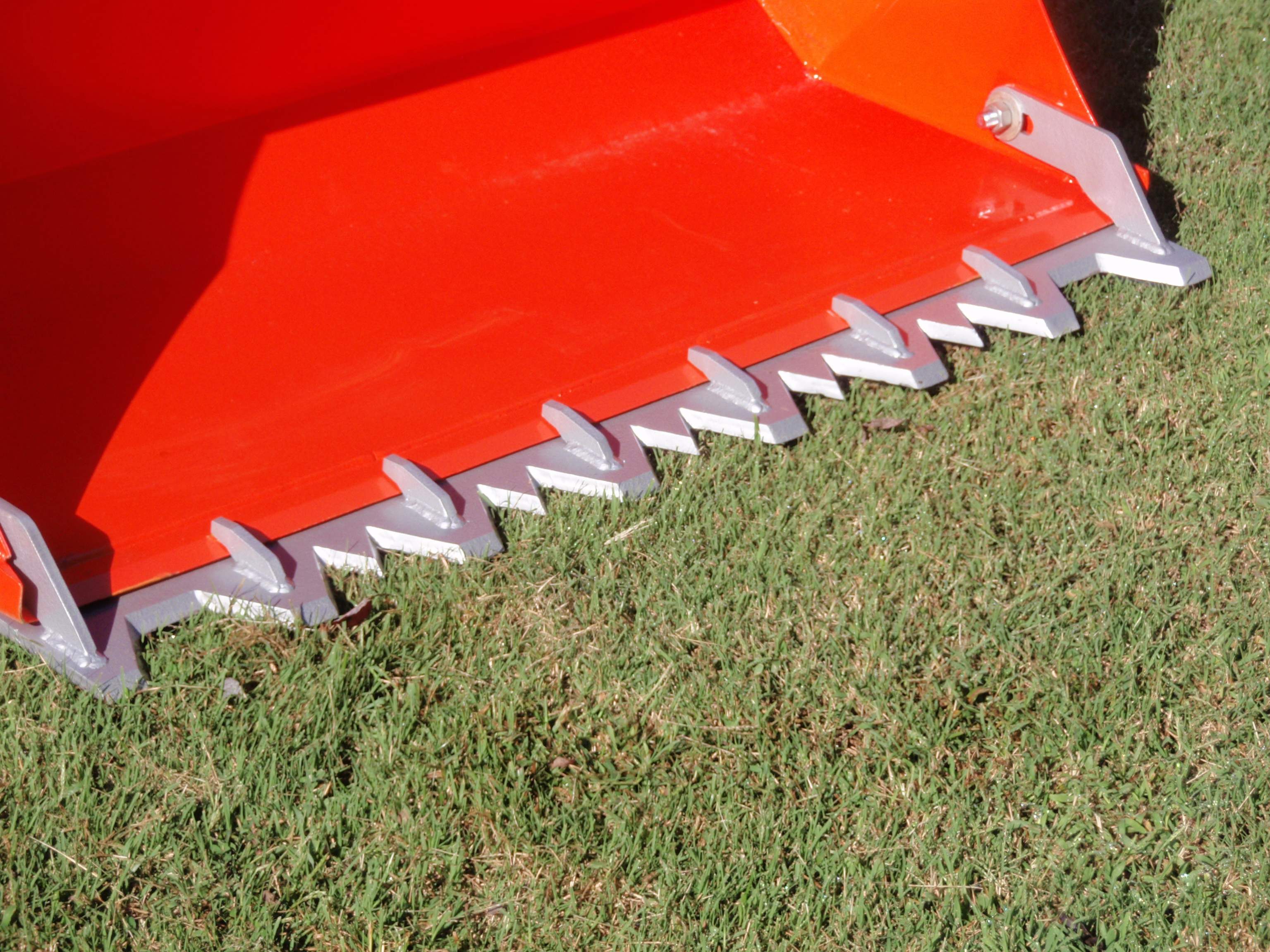

You need this!
New BXpanded PIRANHA Tooth Bar! Designed for digging and clearing. Serious 1/2" thick steel absolutely eats up brush and saplings. Too new for the website, but the BX model is available now at only $229 (plus shipping). The Kubota BX model even lets you use the BXpanded Quick-On forks to easily haul off that pile of clutter you just ripped through. Other versions available. THIS THING WORKS!
Made in the USA by a proud TBN Sponsor
For more info email contact@BXpanded.com or call 704-419-5332
