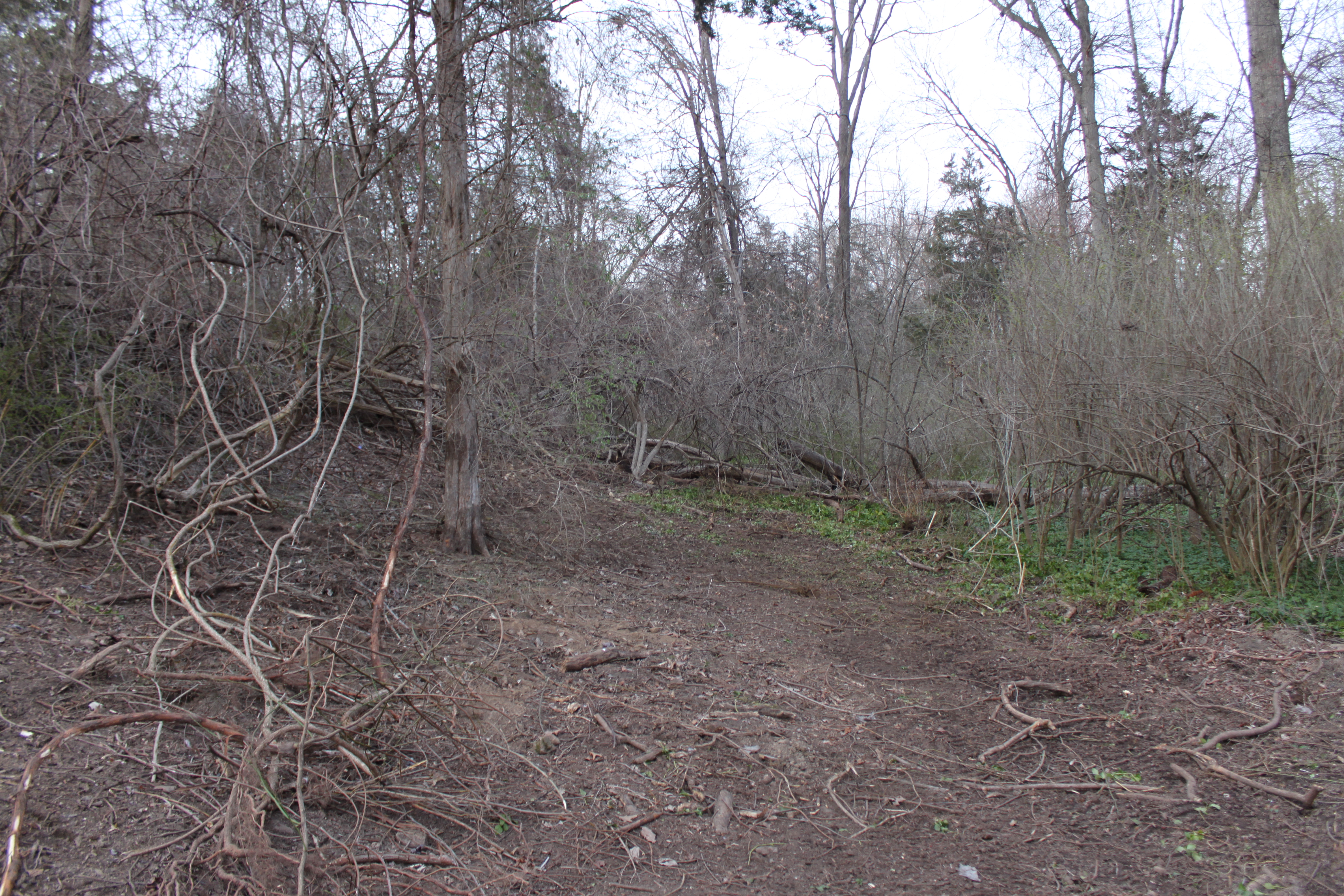

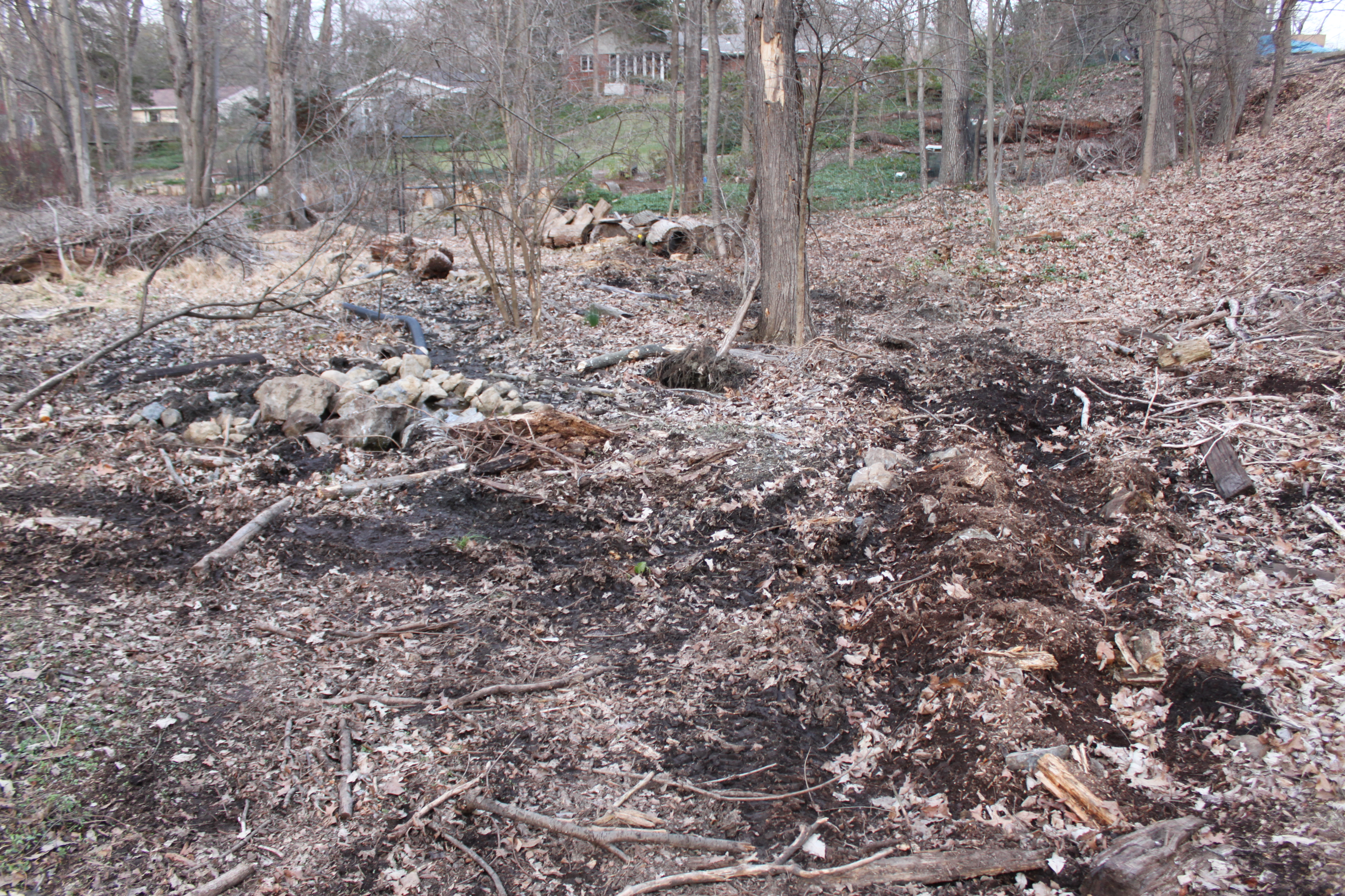

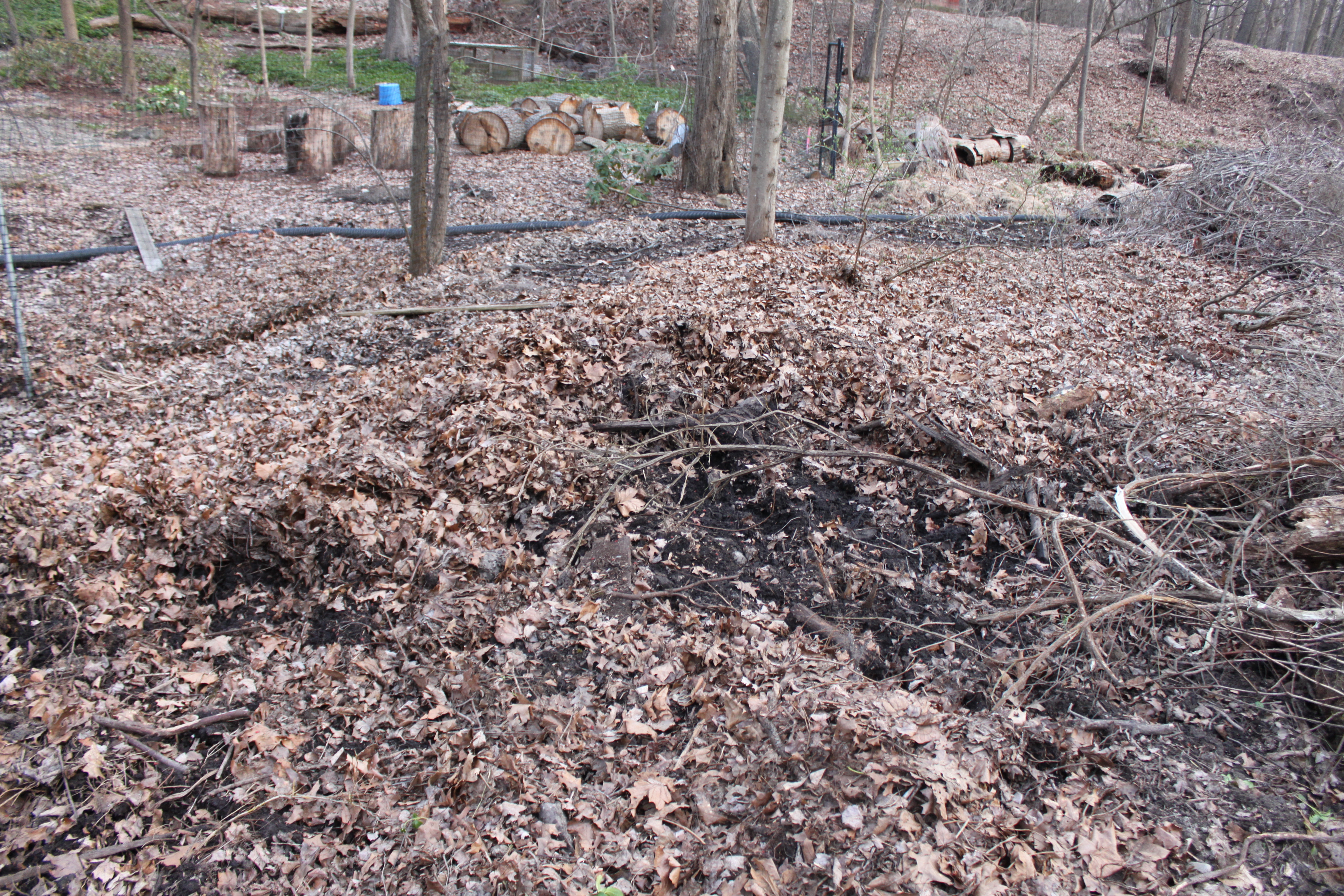

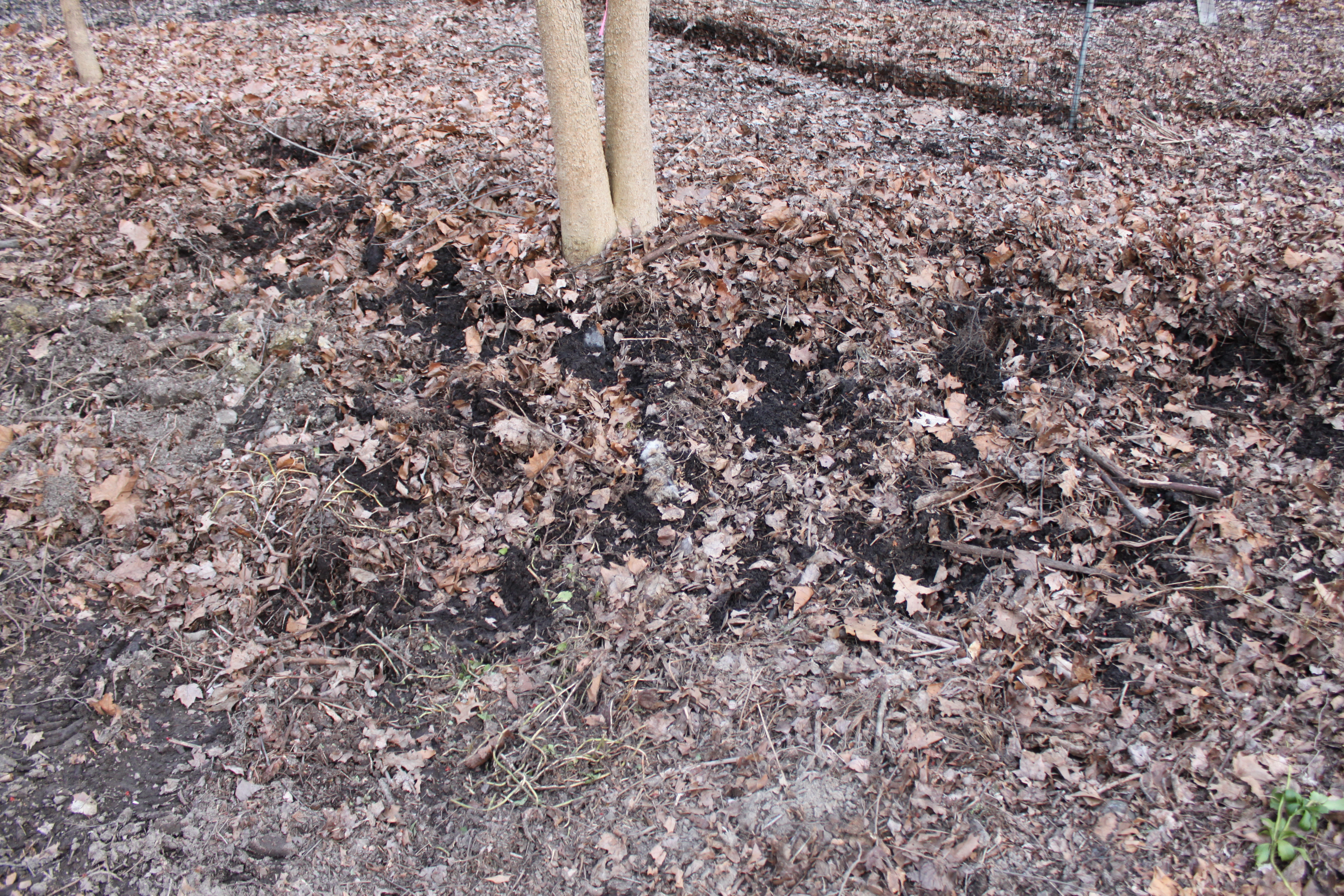

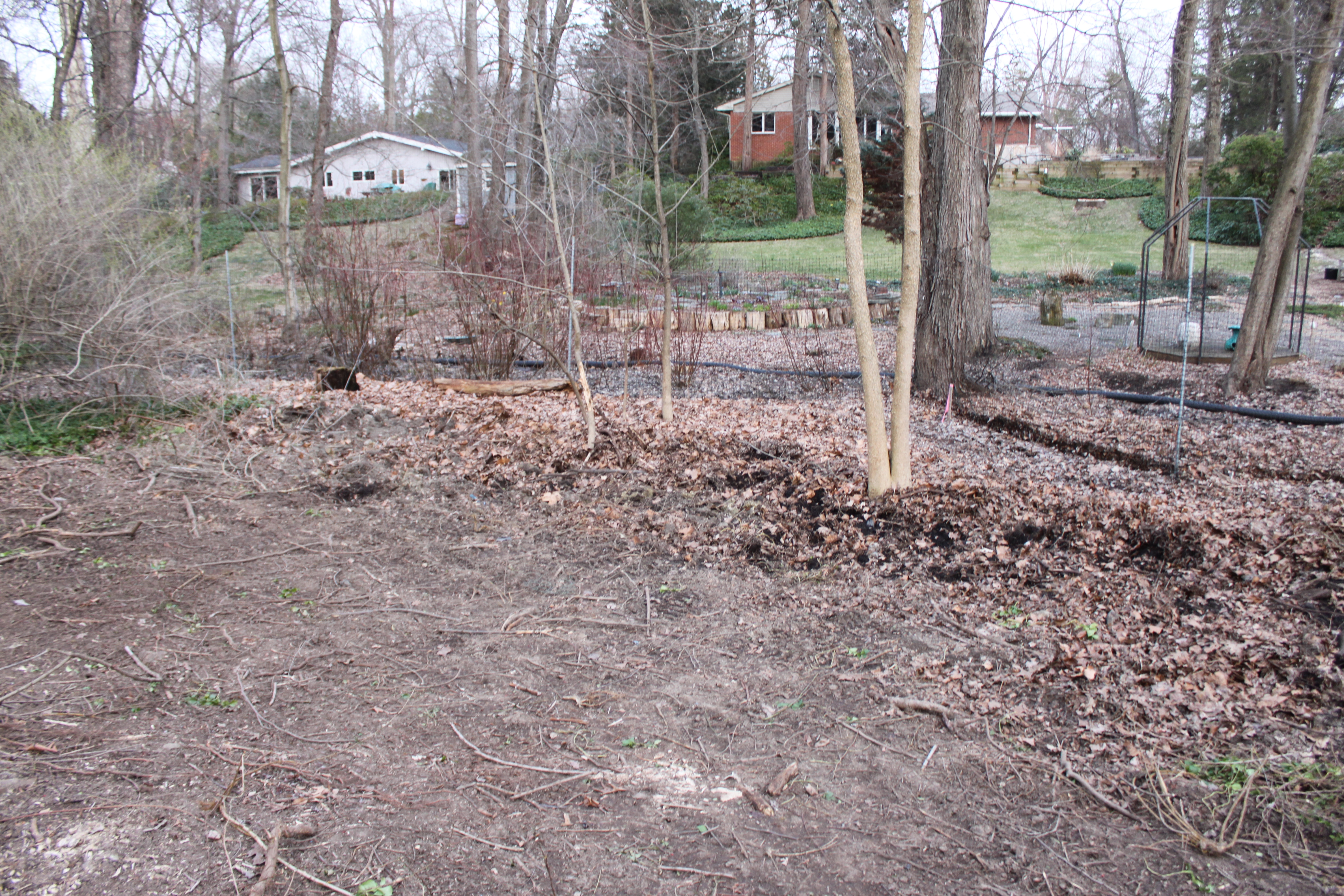

well here are the pictures sorry for the delay busy cooking for Easter sunday. Also happy easter everyone! I hope the pictures if not I will take more. I am not sure fo the dirt in deep as I have dug yet with my backhoe. but I does look like good soil for vegetation especially where all the leaves are.
well to my surprise their is a drainage pipe that is in my backyard from the town, so that might be why its stay wet. You can see it in one the pictures near all the rocks. the black rubber pipe was something a neighbor had put to years ago which is suppose to help with the drainage. its not coming from a basement water pump or from gutters. I don't believe them so I am getting ride of it after all its on my property.
so maybe the water problem can be fixed a lot easier. I am going to look at my deed and my land survey and see a little more in depth.
but to my original question is the leaves and debri, what should I do with it?

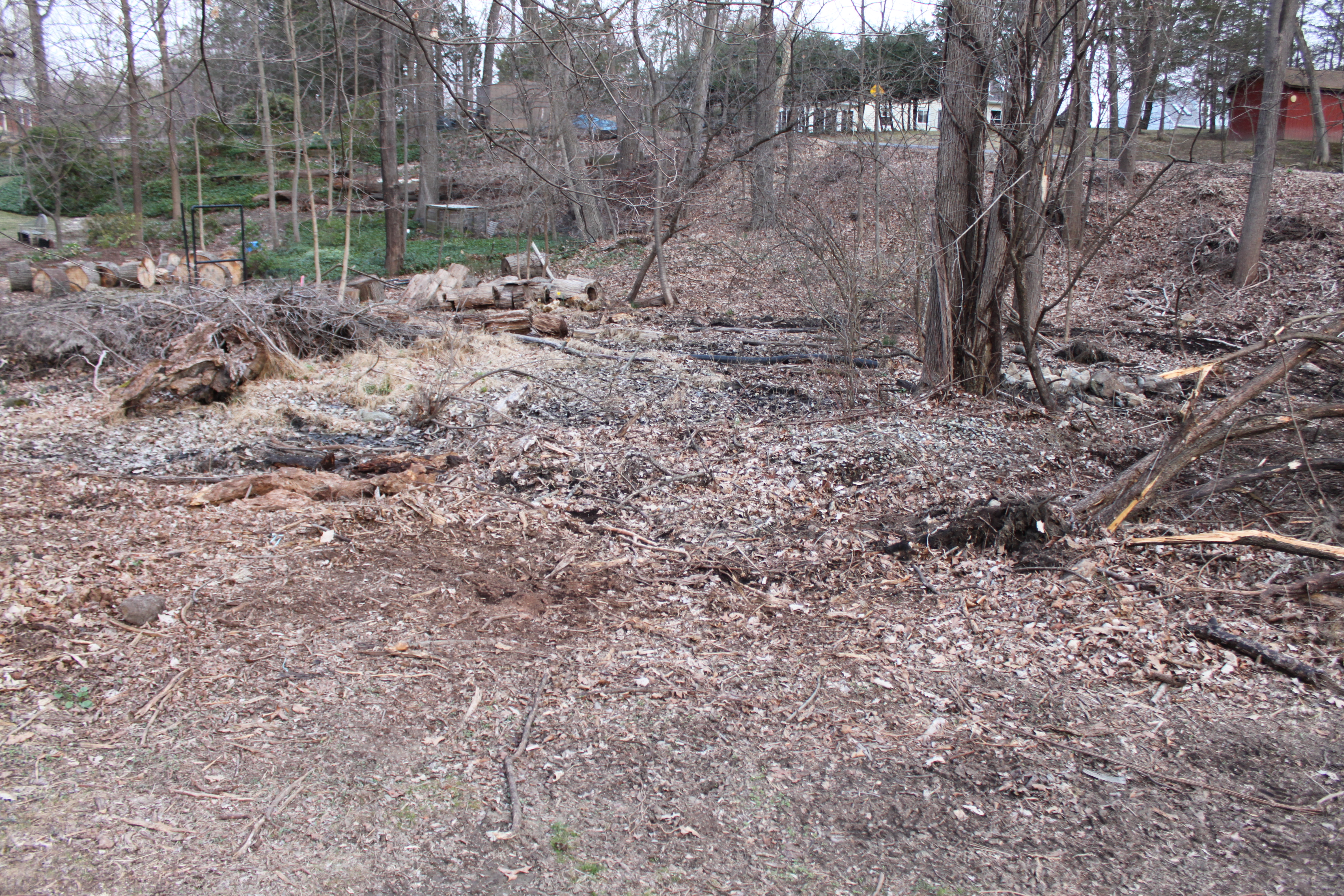

also this is whereIMG_7369.JPGIMG_7368.JPG I would want to put my concrete slab. also way in the back I was thinking of putting the wood chips since it would be way cheaper then a dumpster.
I mean I know I have a lot more to clear before I do anything..
