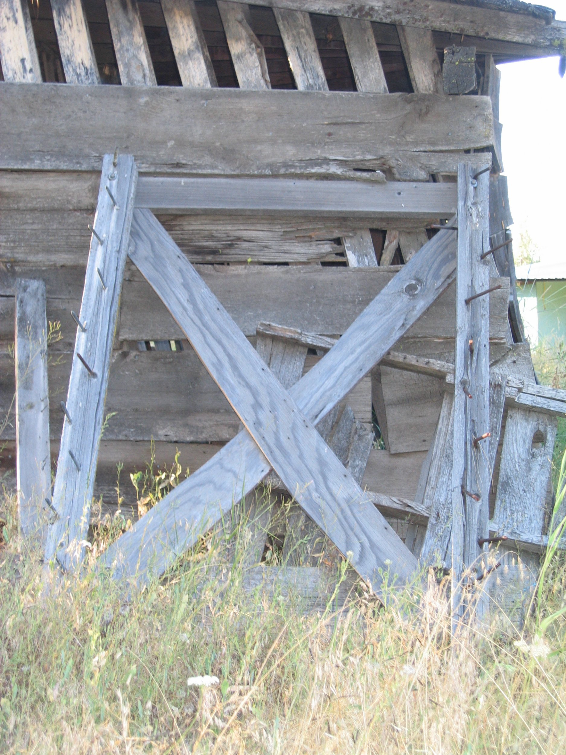

You could make yourself a "drag". Mine is made out of 4x4's and has spikes on the leading and trailing edges. It could also be - old set of bed springs, a couple logs chained together, rail road ties - etc. Drag it to level and bust up the clods. Spread your seeds - drag a final time to cover the seeds. Mine has a rope harness and I pull it with my ATV. I drag with the spikes down to level and bust the clods. Turn it over to smooth.
