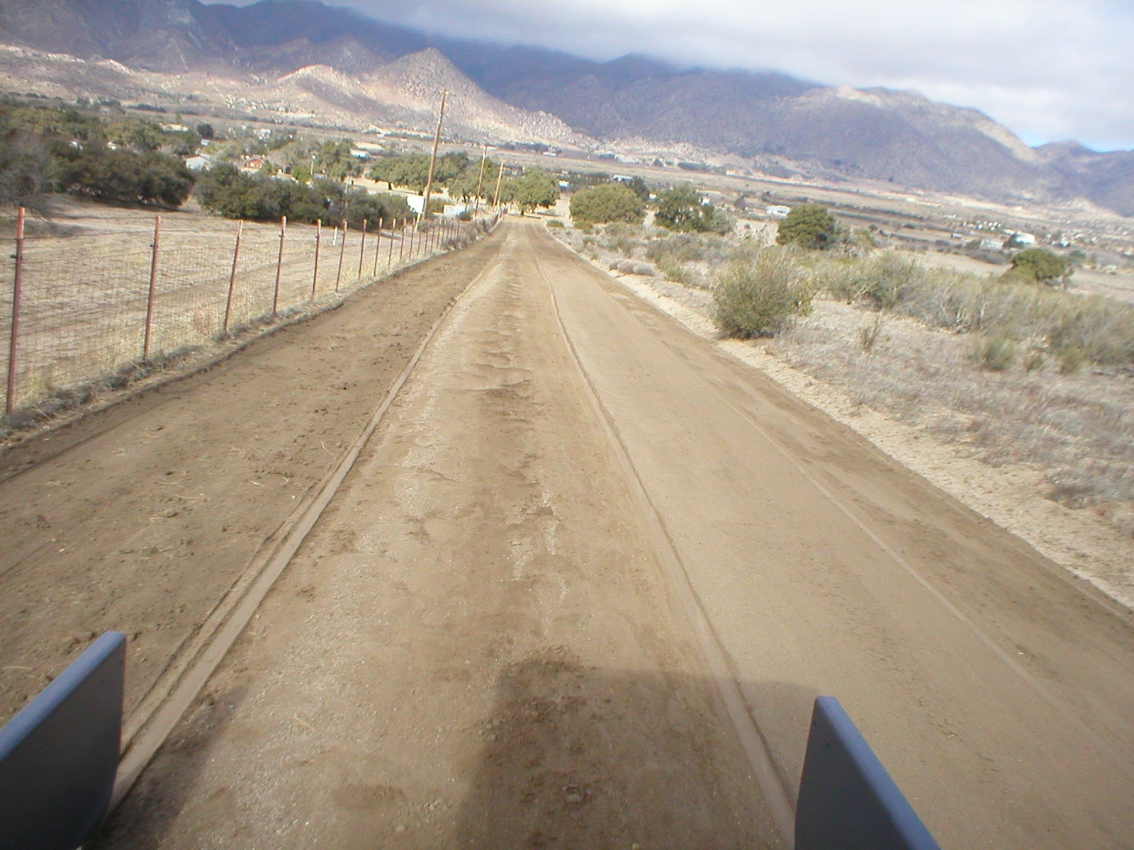

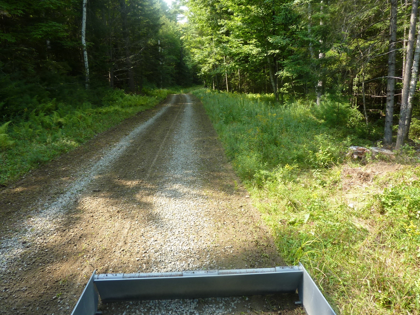

   / Land plane for dirt/sandy driveway? #6
I will say this, the Land Plane grading scraper cut my road maintenance time by more than half over my box blades. Of these 4 implements, they range from 800-1400lbs and from 60"-84" in width.
My road is over 1 1/4 mile in length and a half mile of that is shared with 4 neighbors.
The investment in the LPGSrs has been one of my better implement purchases.

   / Land plane for dirt/sandy driveway? #7
I have both. Land plane grading scraper and roll over box blade. Regarding use - LPGS gets used 99.9% of the time. ROBB - 0.01% of the time. I've been able to move any/all dirt and gravel with my heavy Rhino rear blade.
The LPGS does an excellent job on my mile long gravel/sand/volcanic ash, mix, driveway. I don't sell the ROBB because the minute I do - I will need it. At least that's my excuse.
My driveway is a mile long. Straight as an arrow. Right down the quarter section line. I have one section - 150 feet - that gets muddy every spring. This is my LPGS getting cleaned up after grading out that section. Timing on this section is everything. Still moisture in the material and before it dries out and turns to concrete.
