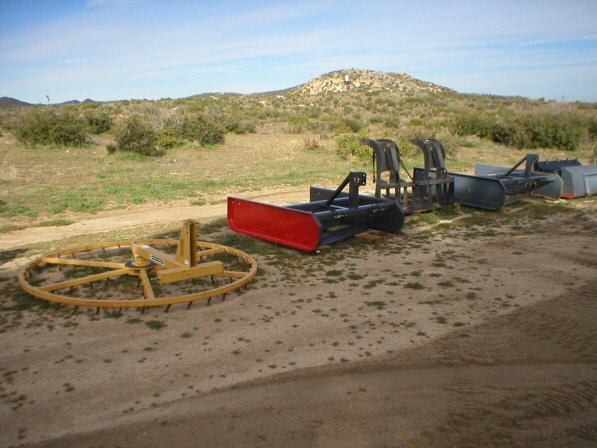

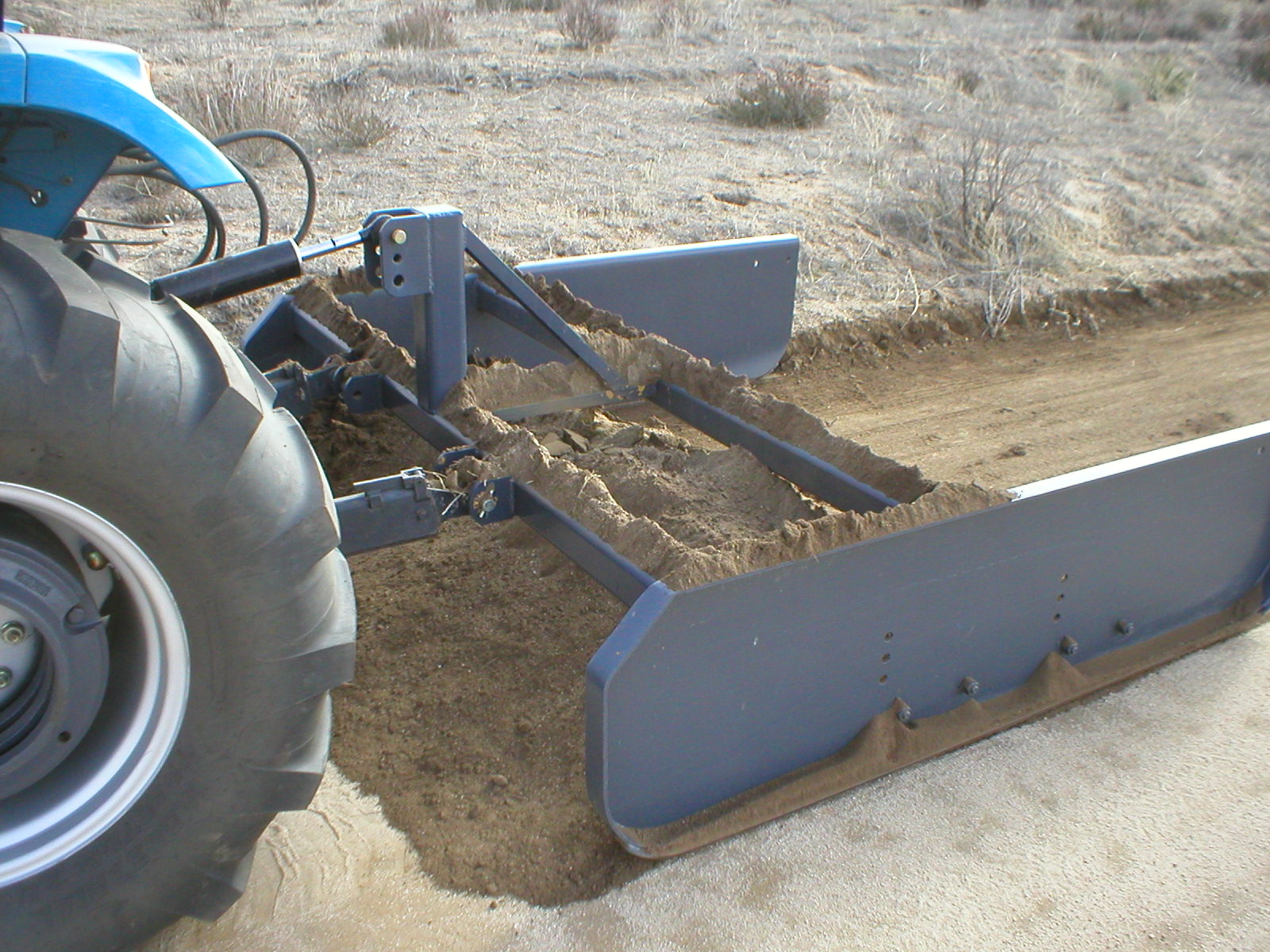

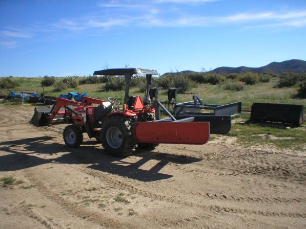

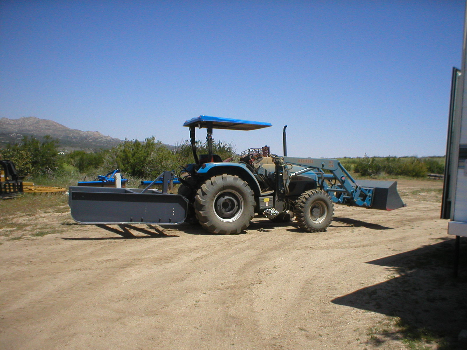

Lots of variables. What type of surface? What type of LPGS? Over 1000lbs? Do you want to just drop it and go, or are you willing to actually control it as in actually use position control?
If you want to just drop and go, then get a lighter weight unit (under 1000lbs) with rippers. You could probably get away with an 8 footer. I would get a 7 footer for your tractor myself.
If you go with a unit over 1000lbs, then a 7 footer for sure, I sort of doubt that you would even need the rippers, would not hurt to have them, you don't have to use them and they make for additional weight. Plan on making use of the position control with a heavier unit though.
I have a 7 footer that weighs in at 1400lbs, and even behind my 75hp 12,000+lb tractor if I don't use position control and just let the unit's full weight ride, it can stop the tractor when the moisture content is right. I have similar circumstances with my 800lb 5 foot unit when I use my 5000lb 32hp tractor.
All decisions that only you can make. ;)

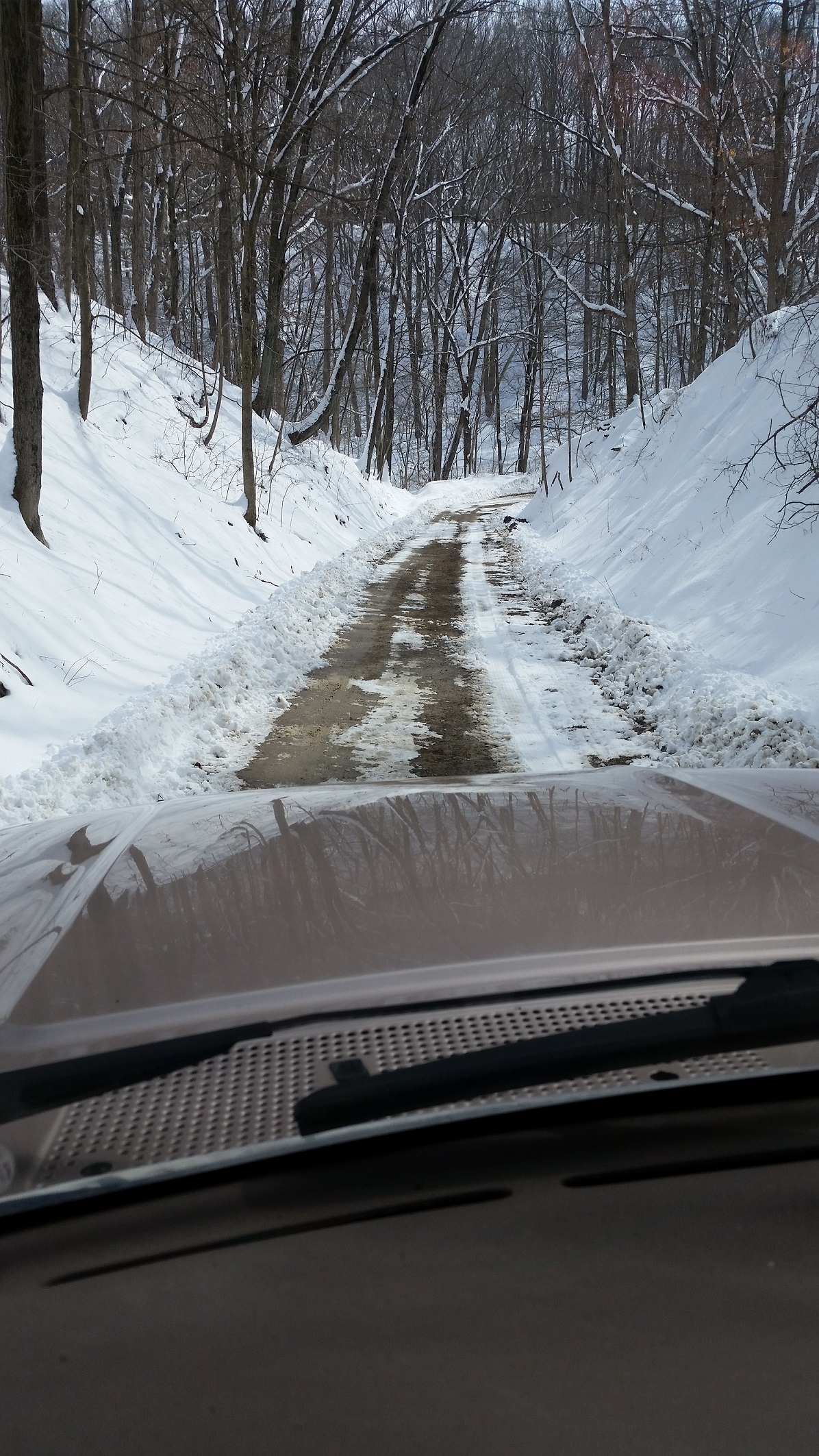

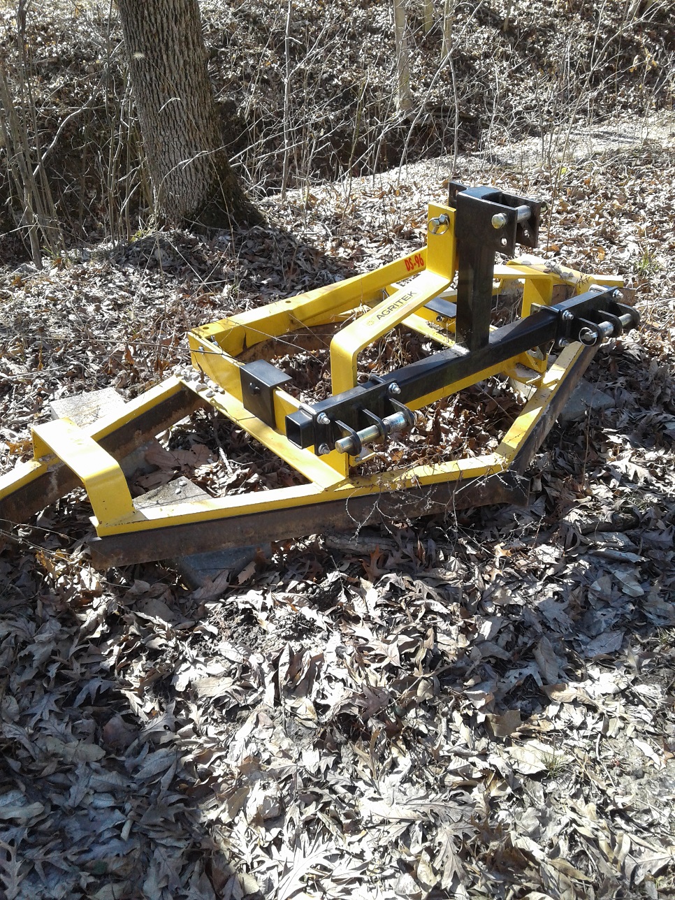

In the winter my gravel gets pushed towards the ditches. I bought the agritek brand to recollect the gravel and move towards the center. I plan to get a hydraulic top link to properly use this implement. Otherwise I would use what everyone else uses (conventional style of land plane.
What is that? I looked up "AgriTek" and found nothing on any tractor implements.
