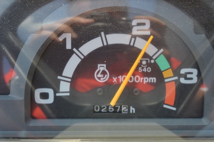

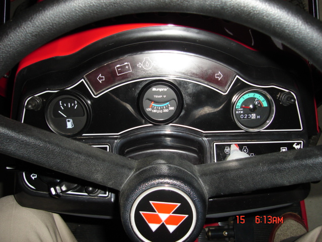

I don't see a temp gauge on this tractor. Don't see any indicator to show PTO speed. What am I missing?
   / Land Pride 15 - 48 with GC 2300 #4
Odd;
The GC series tractors have a temp gauge and on the tachometer there are labels and color indicators for PTO speed.

The early GC2300s do not have a tach , and a warning light for engine temp. PTO speed is about 3/4+ throttle. I usually just go full, then back it off a little. The engine should not be able to go over the redline, which is why the originals never had a tach, but consumer demand made the change on later models.

My 2007 GC2310 (one of the last ones) has a tach/hour meter, but came with no temp gauge; I just added one from a car parts store. There's already a hole under the stick-on dashboard cover for it, right in the center.
Chuck, if your tach looks like mine, that small white mark is the PTO speed point, around 2300 rpm. (That's also where rated horsepower is achieved, I believe.)
