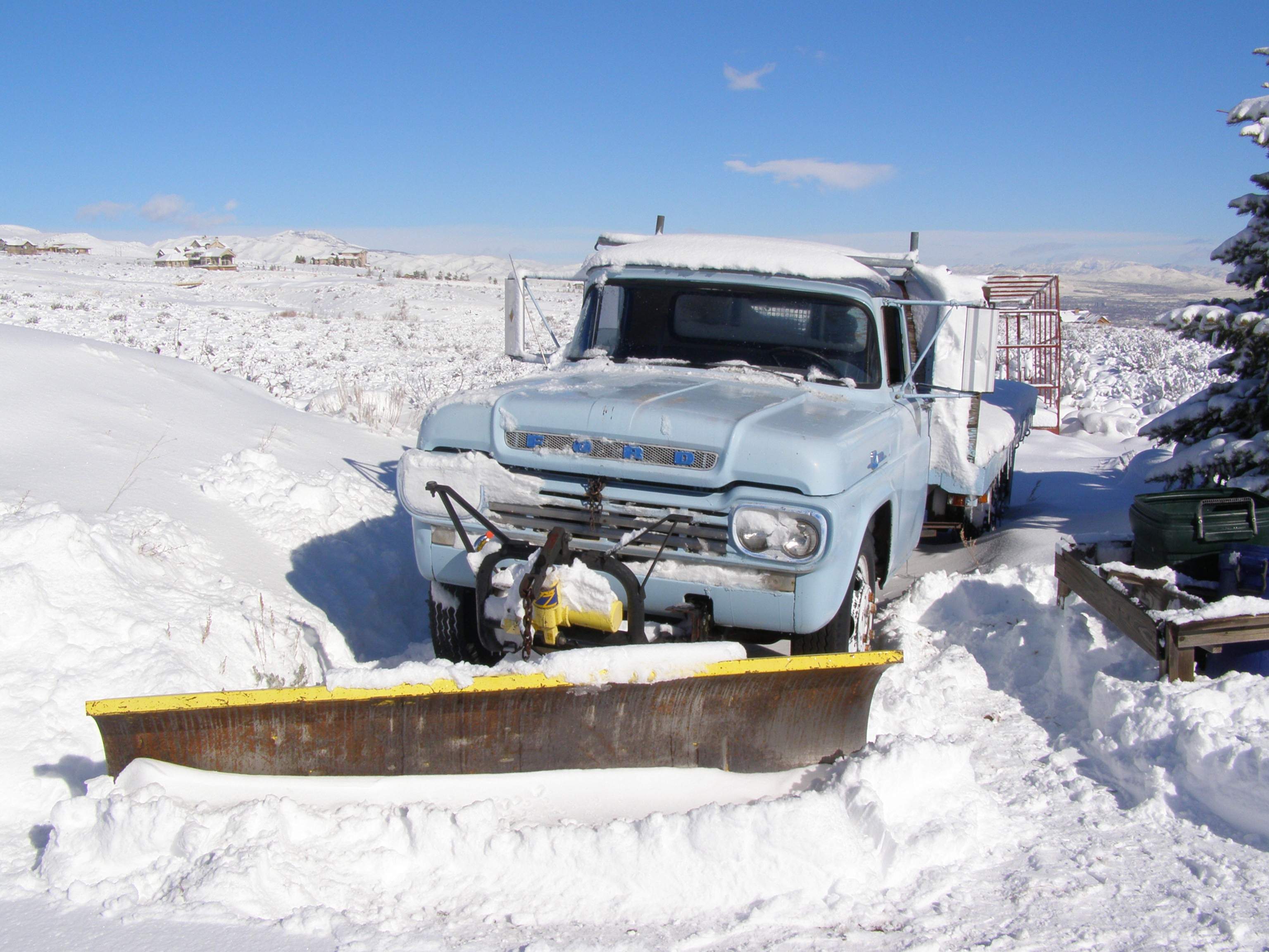

I intend to add pictures because I enjoy seeing them two. Here is old blue. She's a 59 Ford F-600 with a Y block motor/2 wheel drive and she has moved many tons of the white stuff

Old blue looks great, looks like you get a little bit of snow there. I have a 59 F600 with a dump flat bed. The 292 died a few years ago and we put a 368 Lincoln engine into it. Makes for a nice improvement.

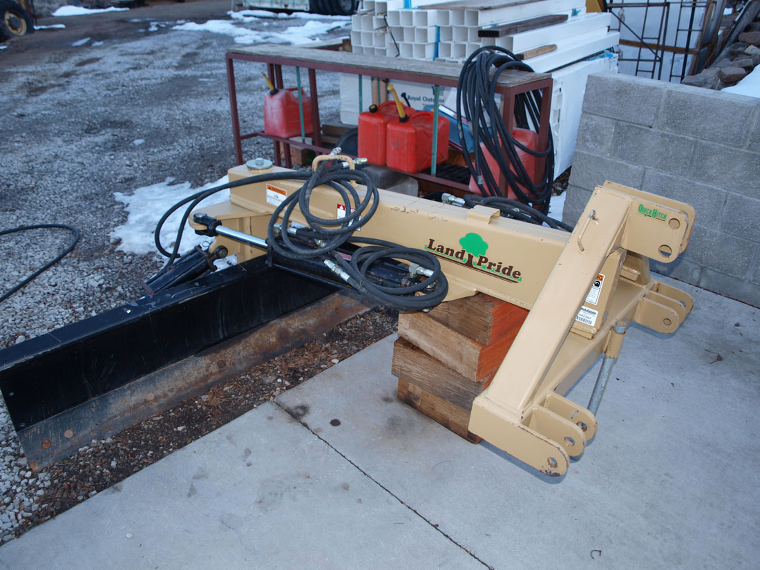

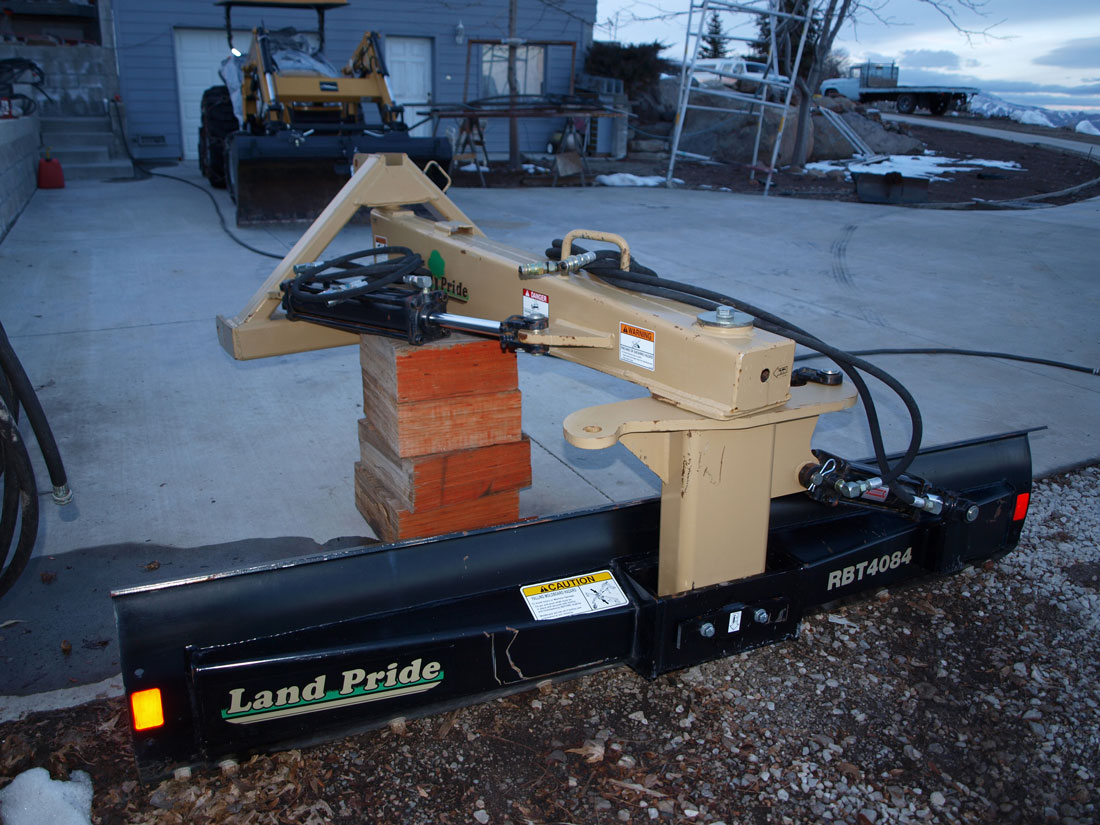

Well the blade was brought home today to her new home. It has the same hyd. quick disconnects as my two remotes have so I can save a week or two worth of grocery's. It looks to have been sitting in the sun a bit as the hydro lines show some minor checking at the bends. Sitting next to the tractor it appears to be a very good match. It is a very well built North America unit.
I now undrerstand what you are talking about Mtn view adding two hyd. ( Northern Tool ) calls them selector valves. I'll try to get some pic's going. I have no pic's of the tractor but I have used many of the ideas from this wed site to make a better tractor. I hope I can add to this family of ideas, but for now I'll add a bit more eye candy.

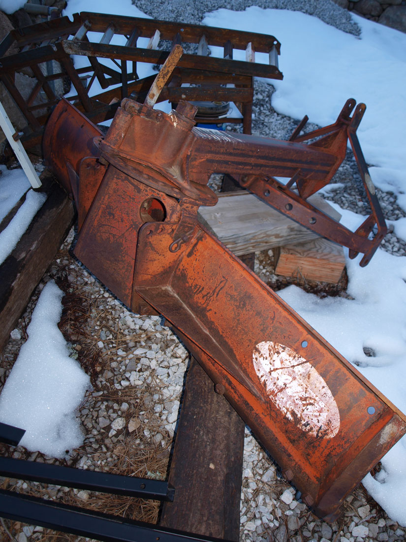

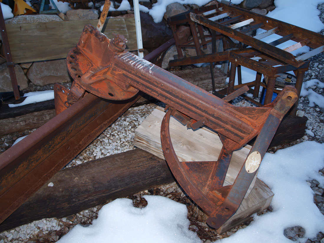

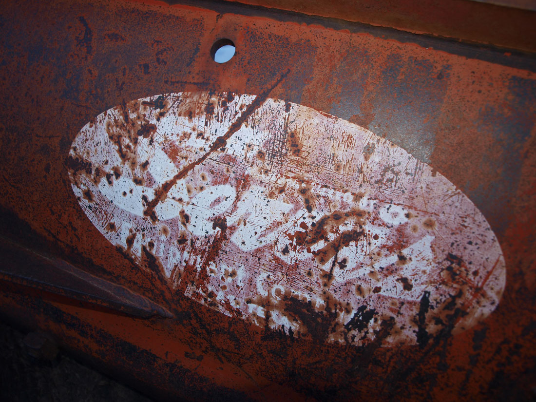

Here is some pics of the new blade and some of an older blade I was using on a 1953 Case 300. The old blade is built and I was able to go 4-ways with it by ajusting the right side link. It will be nice to run the new blade with the hyd's as the old one was all manual. I'll need to add a selector valve as the new blade is a three way and I only have two remotes for the back.
