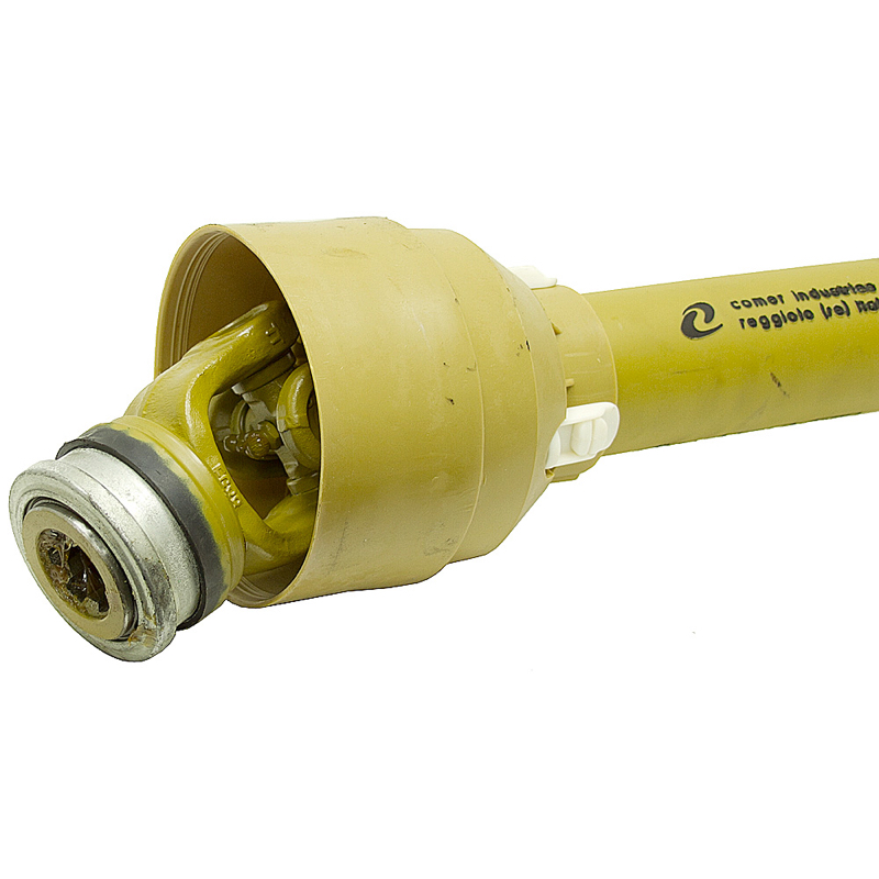

I did the final cut of the season with my Land Pride Rear Rotary Cutter (brush hog). Can someone tell me how to remove the plastic drive shaft shield? It's nearly impossible to access the Zerk on the u-joint.

What brand is it? (the driveshaft)
Sent from my iPad using TractorByNet
   / Land Pride Brush Hog. Grease fittings? #3
If it is a Comer as comes on Bush Hog brand cutters, there are three tabs behind the shield around the U-joints. Take a straight blade screw drive and rotate the square slotted white screws 90 degrees and they can be pulled out letting the shield slide back on cover over shaft.
Have you tried a flex hose on your grease gun?
