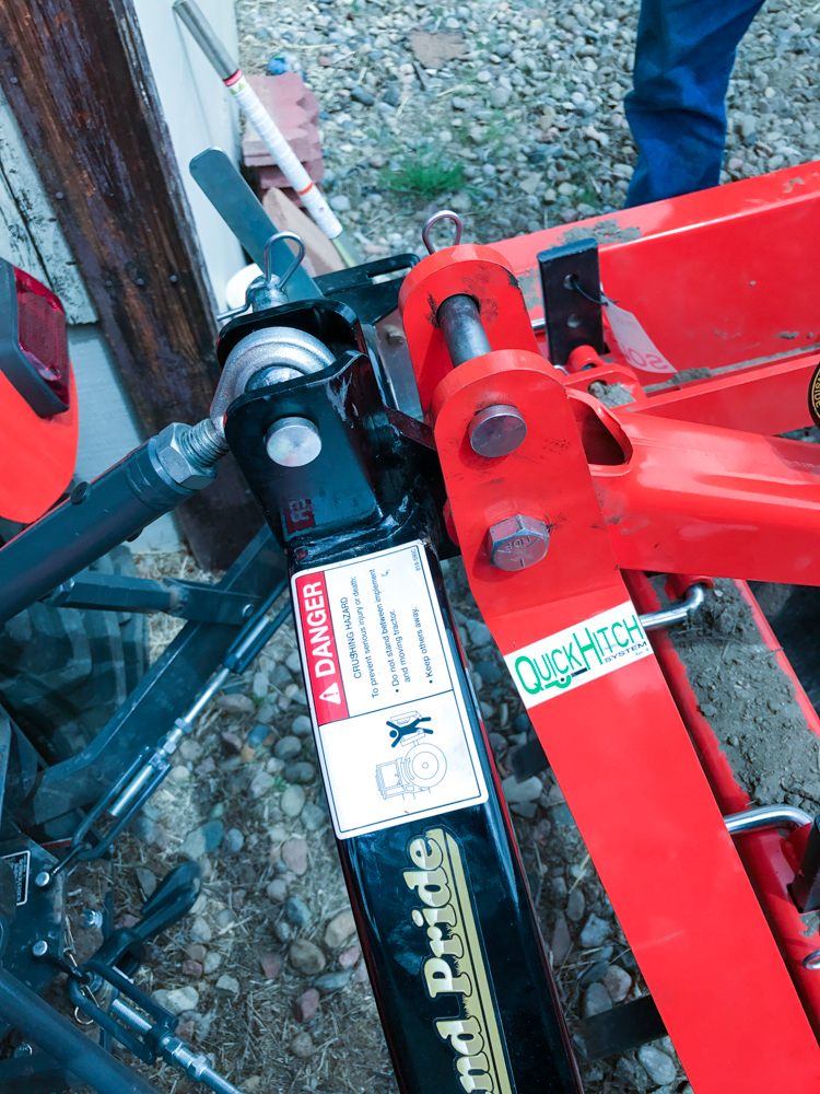

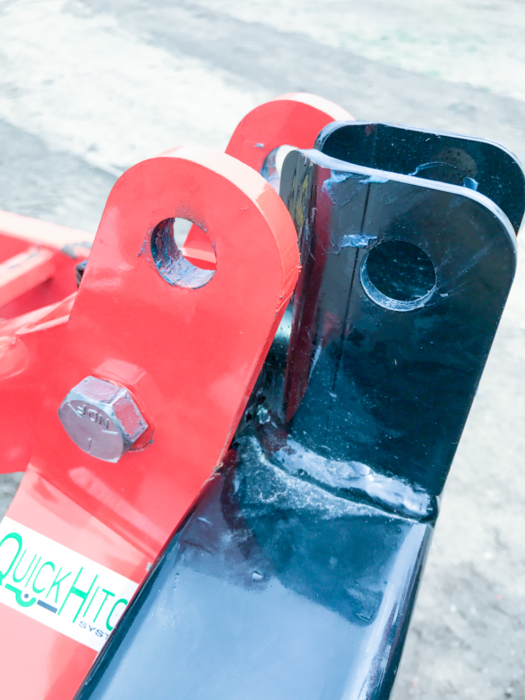

Tried to put these together this morning. Doesn't look like the geometry is right.
The QH hits the GS before the pins can engage. At best I can get one side or the other locked. The top hook / pin can't seat at all.
Brand new GS1548. It has a sticker that indicates "Quick Hitch Series B".
Brand new QH05.
Has Land Pride changed anything for on these for 2017?
Does this combination work for anyone else?

My GS1572 connects perfectly with my "no name Chinese clone" QH from Agri-Supply. Manufacture date on mine was probably a year ago.
   / Land Pride GS1548 & Quick Hitch (QH05) #3
I don't have a GS, but my other implements work perfectly with my QH05. I had to adjust my tiller's lower link width to match the QH width if I recall correctly the one time, but don't think I had to fool with anything else.
The top link connector pin on the GS may need a spacer/bushing to properly accept the hook width (pin may be more narrow than the hook up).
Can you post a picture of the dilemma so we can visualize and try to offer better advice?

The LPGS was assembled incorrectly. The left & right "arms" were swapped / reversed.
   / Land Pride GS1548 & Quick Hitch (QH05) #5
Took me a minute to see it. I get it now. So you swapped the arms on the GS from R to L and vice-versa and now the angles match properly to the rise section that the top link of the QH attaches to.
Glad you figured it out and are up and running now!
