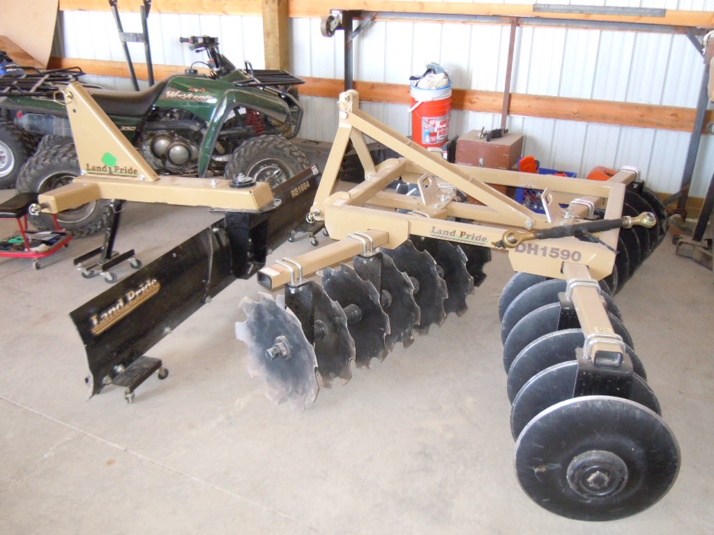

I own a land pride disc and scrapper, bought both of them with the tractor. Could not be happier. I do wish the salesman would have told me I had a choice of color. I got the tan but would have preferred the orange. DSCN1960.JPG
