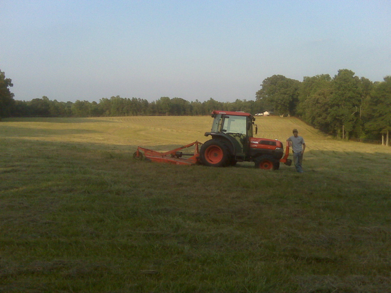

   / Land Pride rotary cutter #9
Picture of a big farm I mowed a couple months ago.
