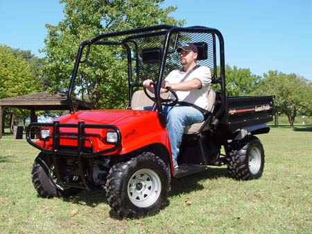

We have had a couple of the new 20 series in stock for a couple weeks, The performance is impressive with 30mph top speed, quicker off the line and even more low end pulling power (1200lb tow capacity 900 in the box) and still no need to have to shift gears to work or play. The same excellent ride as the 00 and 10 series with fully independent suspension and the same auto locking rear and overrunning clutch front differentials for true 4wd capability without excessive damage to the turf. Electric dump bed is now standard also. The CVT is sealed so water crossings are no problem, even with water higher than the floorboards (dont ask how I know this). If your in an area that has a landpride vehicle dealer, it is worth a look.
