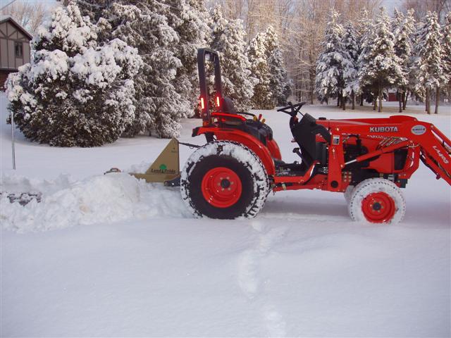

I have a LP RB1572 on the back of my B3030. I use it for snow and loose dirt. Sometimes I wish it had the tilt feature, but overall it works great for me. Your L3400 can easily handle a 6' RB. That, in combination with the FEL, will take care of a lot of snow. Unless you get 10" or more snowfalls on a regular basis or don't have anywhere to push the plowed snow you won't need a snowblower. Here's a pic of what my little B3030 can do. No problem at all.

toolguy: Thanks for posting the picture.
