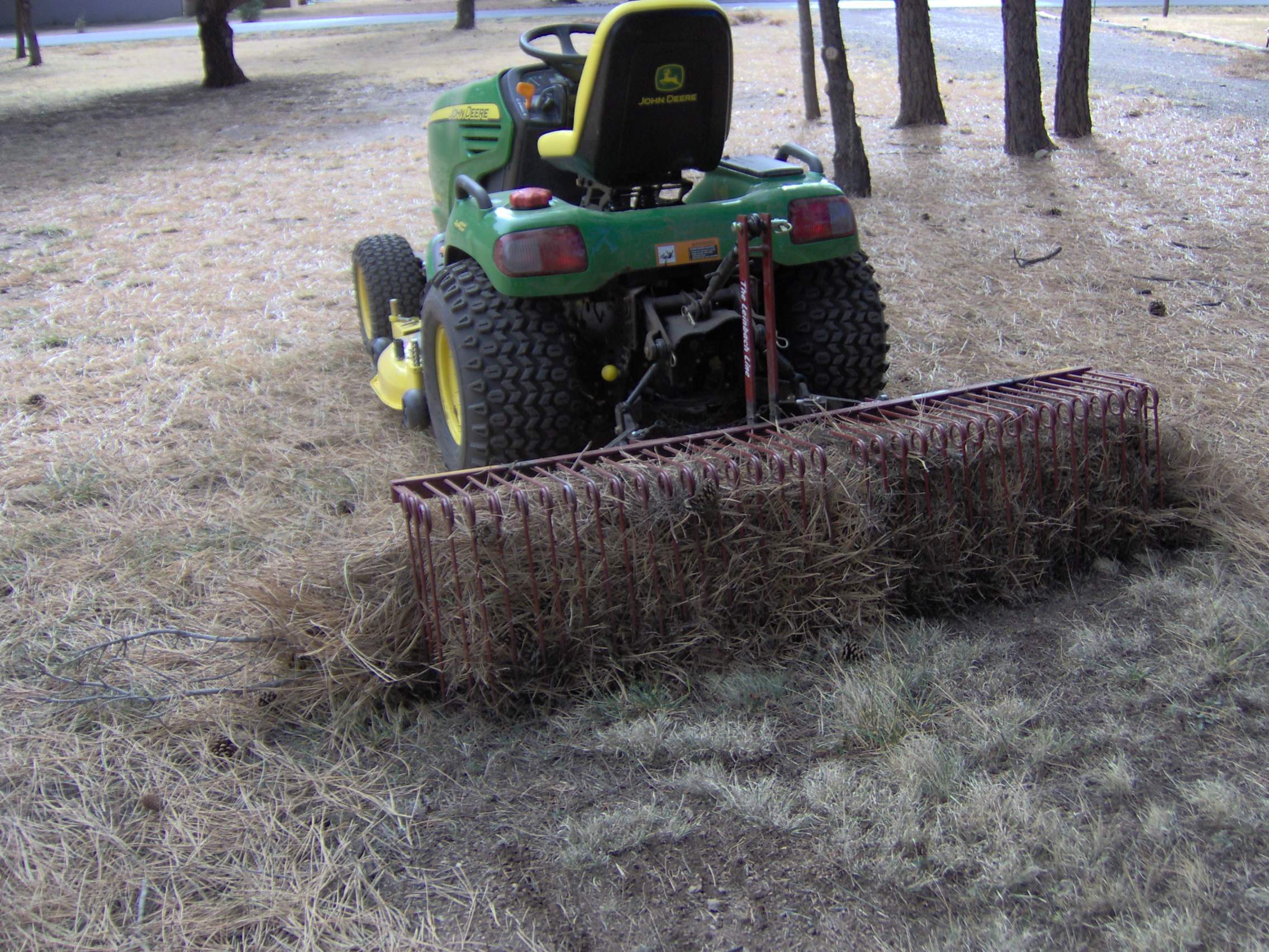

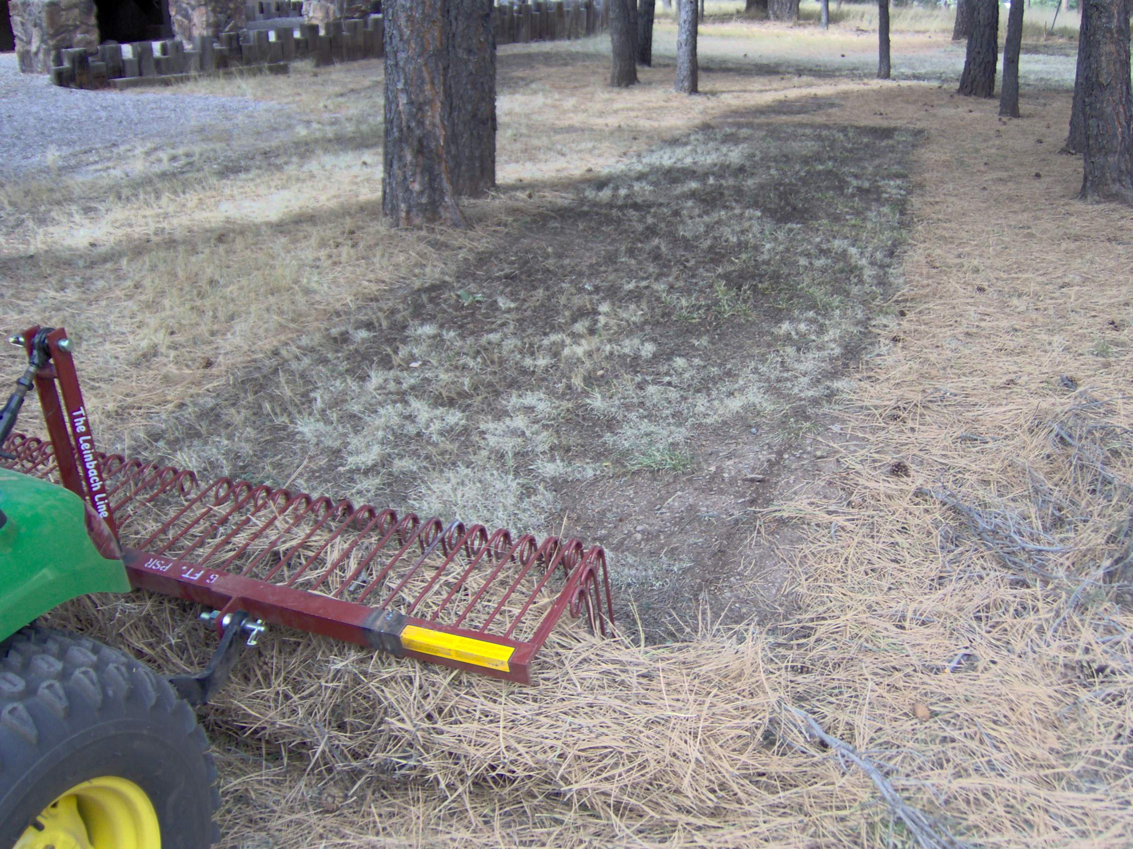

I have both landscape rakes and a pine straw rake, both are good for very different things. For raking a developed lawn the pine straw rake is the way to go, does not hurt the grass yet does a great job cleaning up debris. The landscape rake is more agressive and can be very useful for clean up of all sorts of debris including small rocks.
I don't find either rake to be usefull for gathering grass clippings that are cut short. I have used my ps rake to dethatch with couple of passes then used my collection system to pick it up and move to the mulch pile.

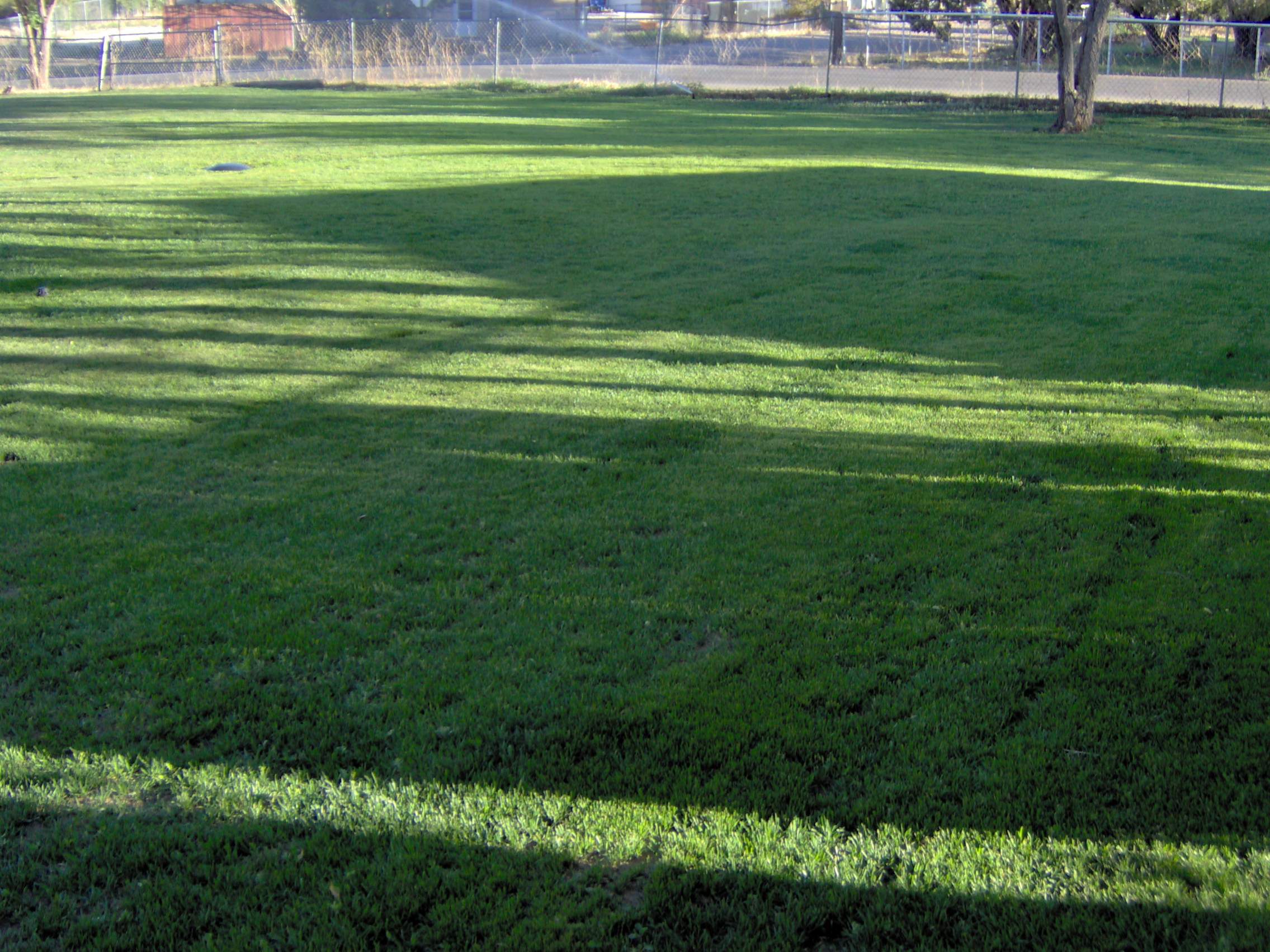

Here some pics I have posted before of my pine straw rake, the new one Ted has at Everything Attachments is the best I have seen so far. The last picture is a lawn area that I used the psr to cover the seed with, used a spin spreader first then raked and rolled. Seems tp provide just the right amount of seed cover, so lots of other uses for this tool.
