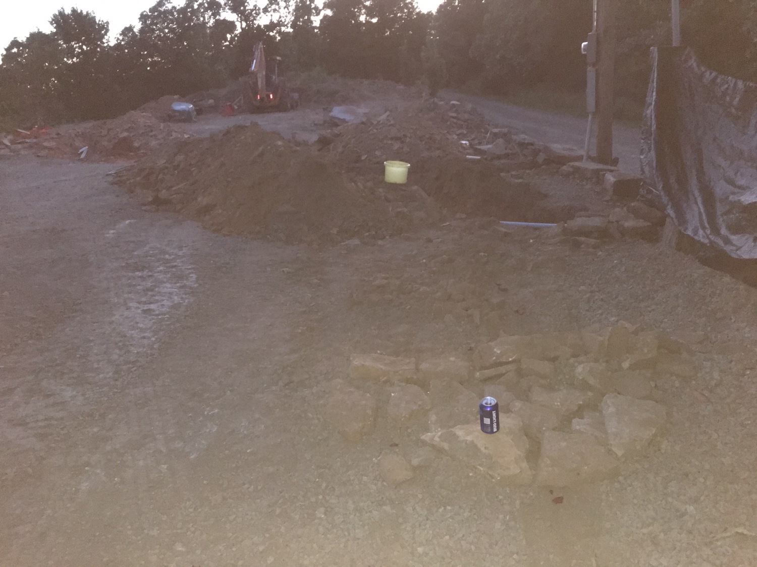

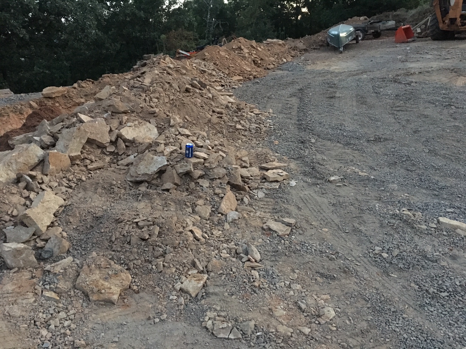

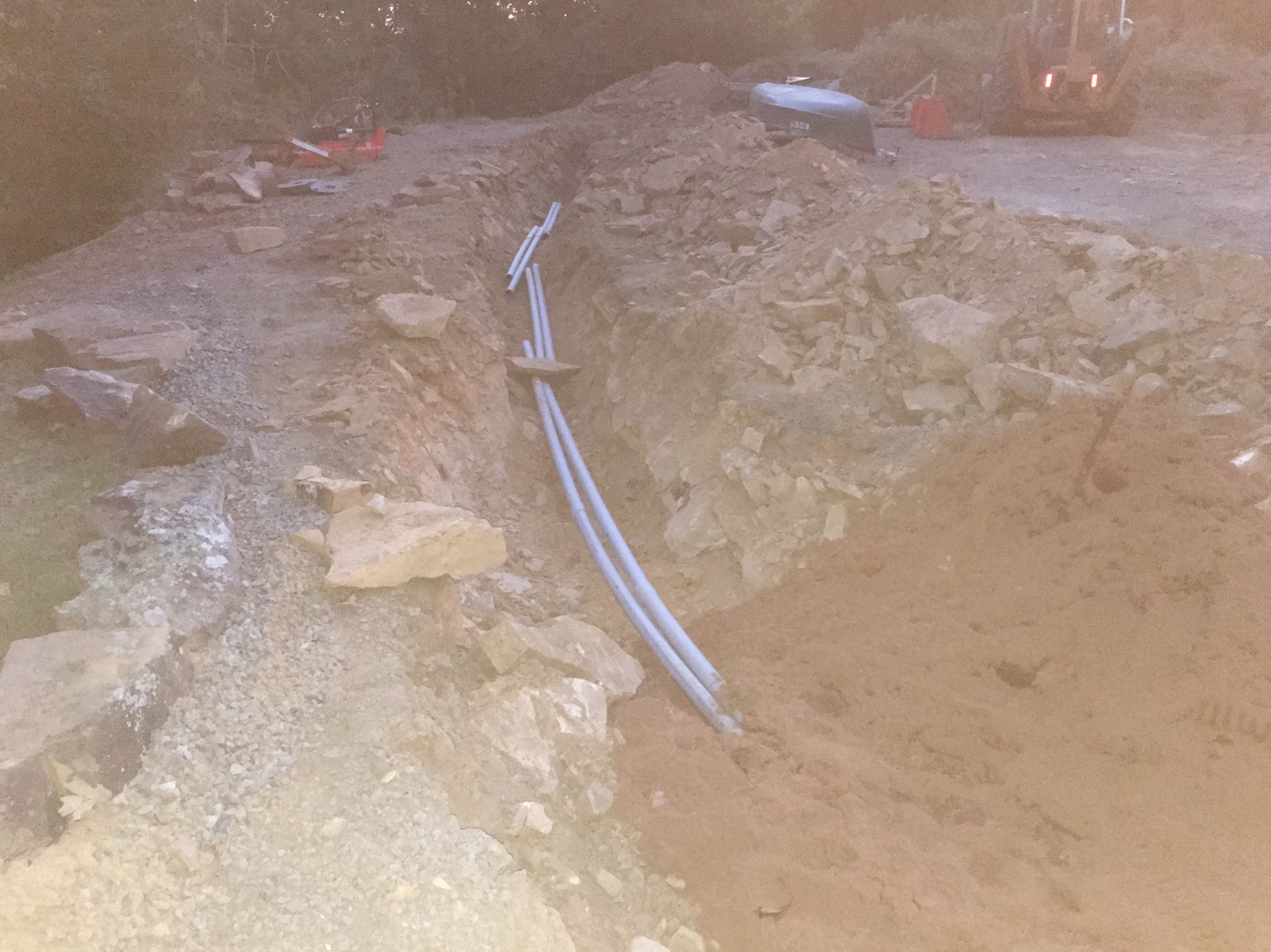

As I get closer to covering up my utility trench for the guest cabin, I'm wondering about something.
Will a landscape rake, rake up the spoils and surface rocks after I finish up and level everything back out before I respread the gravel? This is a driveway / parking area. The boxblade usually jumps rocks and I have to get off and "apple pick" rocks to get a smooth gravel surface.
As much as I like a new implement, I don't want to buy one if it won't measure up to what's expected.
I will cherry pick some of the bigger ones out with the grapple and pile them up for a stone wall later before I rake or boxblade.
Thanks,
Lenny

You don't have rocks in your dirt, you have dirt in your rocks.
I think my York rake would skip over rocks that size just because there are so many, I would suggest a root rake/grapple or a rock bucket.
Could you use that spoil for fill somewhere, and get some cleaner stuff to dress your trench?

I gotta say. The grapple did a fine job of it. I tryed with the backhoe but it wouldn't work worth anything. So climbed on the Kubota and that grapple slid along picking up the big rocks and bunching up the other smaller ones. Had it looking decent then hit it with the box blade and actually turned out nice.
   / Landscape rake work very well? #5
Considering the material you had to work with, I think you did an outstanding job!
