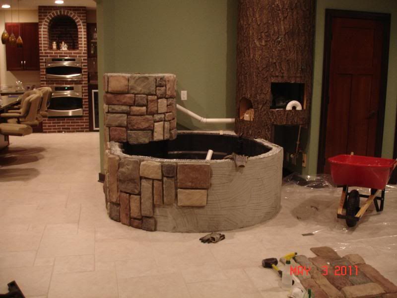

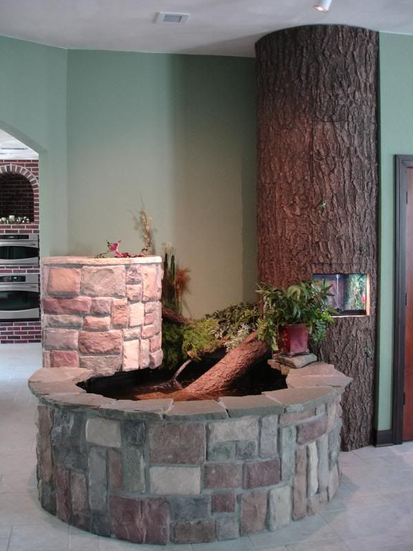

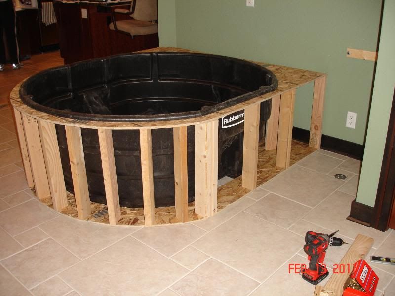

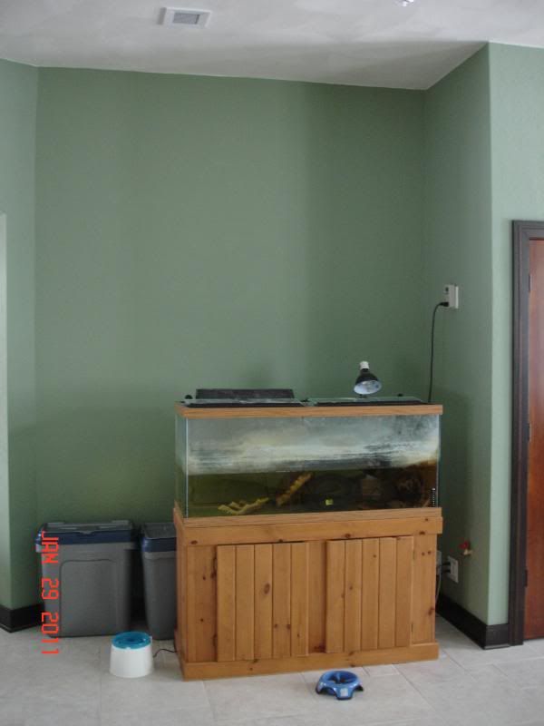

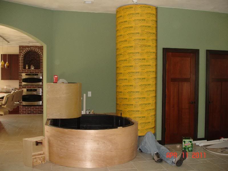

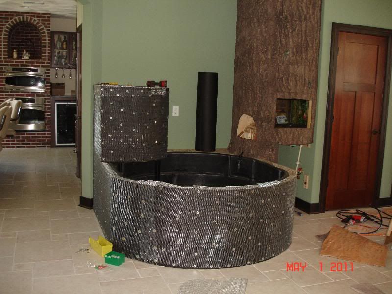

The wife and I built an indoor pond ourselves after receiving very large quotes from builders.
The water turn over rate and filtration depend a lot on what you are planning on putting in the water. Are you going to have Fish, turtles, plants, etc?
Turtles for example require a lot more filtration, specific water temp, and special lighting.
We have 2 large turtle and handful of random fish in our setup. It's roughly 300+ gallons and runs a 1200GPH pump.
Our filter is based on the Skippy filter design (google it) and is enclosed in a 30 gallon Rubbermaid garage can in the upper portion.
We went from this:
To this:

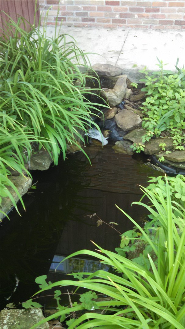

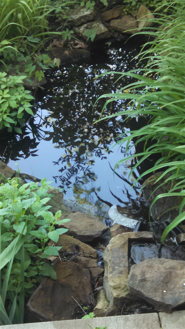

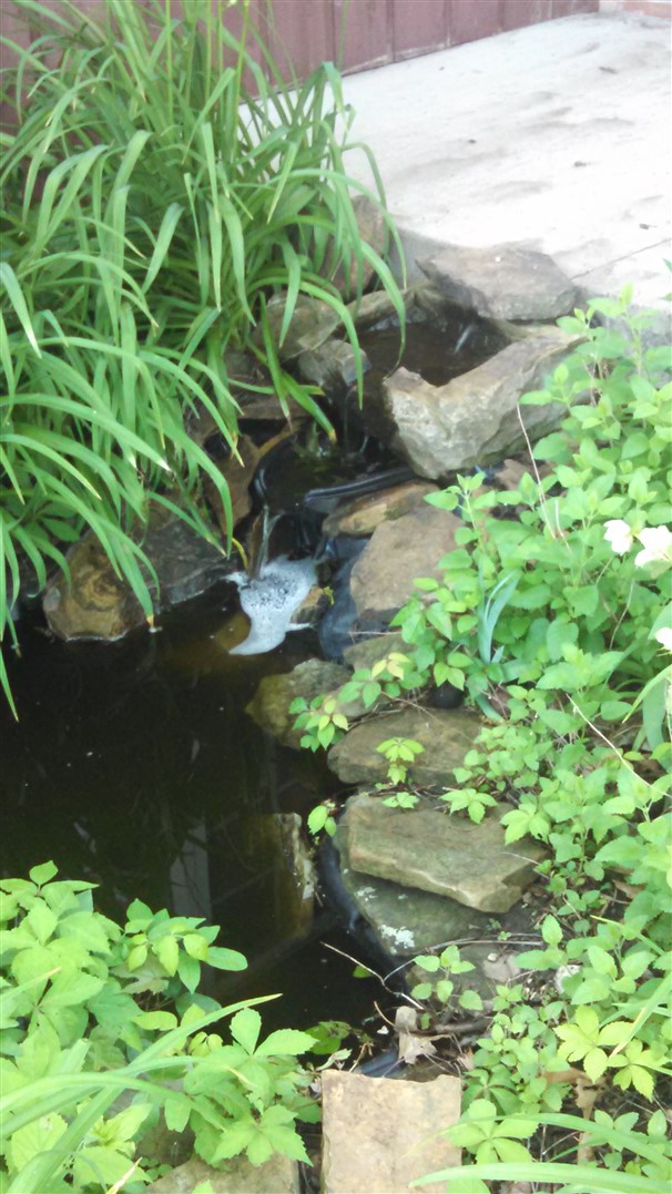

I just went out and took a couple of pictures of the little water feature we have off of our porch. It is between the sidewalk and the house, to the side of the porch. We have a 1/4 acre pond about 100' from the porch, which is lovely to look at. But I wanted sound. So I put a small pre-formed fountain tub (6' x 3' or so) and built a simple waterfall above that. The waterfall is only a couple of feet, but in my years of backpacking in the Smokies, I learned you don't need a lot of height to get a nice sound. It has been in place 17+ years.
No fish or plants, and just a small pump. I don't drain it in the winter, but do drain it and clean it each spring. I made the top stone by taking a square rock found on the farm and chiseling out the top, with a lip for the water. Drilled a hole in the back for the pump tube. Over the years I've tried a variety of setups for the little fall, but found the best sound came from using a little pre-formed waterfall tub. I can't really hide it and as you can see from the pictures, I still need to cover some of the liner. Part of the fun for me was trying different methods for the waterfall to get the sound just right. Not to loud, just soothing.
The birds enjoy the water, as does our Lab. He drinks from the top piece and I think he enjoys the sound too. I just took that picture a couple of days ago.
I think you are on the right path. You can start small and then decide if you need more. I was careful when I installed the tub to make sure it was on some sand and it has lasted through all these winters without an issue. If you would like more measurements let me know.
