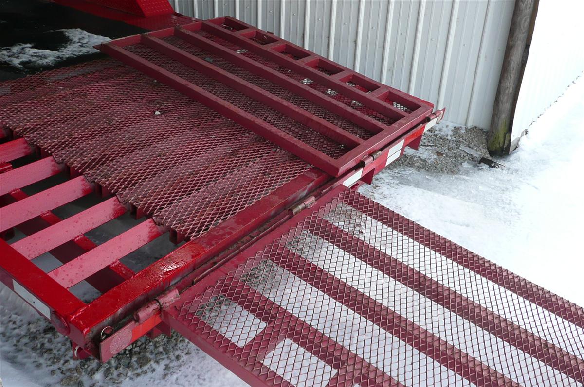

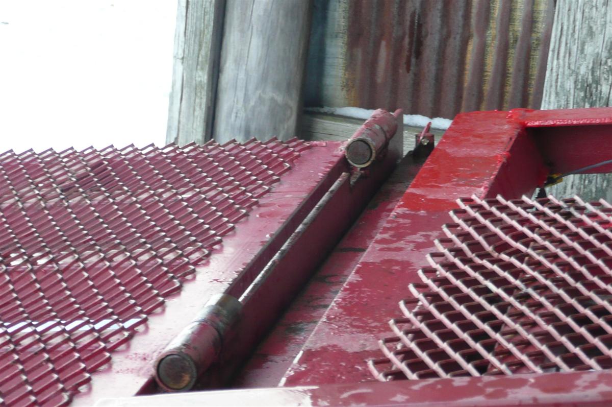

Mesh gates create more drag than you think!! Years ago I had a 1/2 ton Chevy w/small V8 and a 18' utility trailer (side rails) w/ 4' gate, I was going to a auction running on the interstate, I had to run it up to 70mph in 4th, then shift to 5th set cruise at 65mph and would only hold it until a slight uphill then would lose it. After the sale I had someone help me remove the gate, lay it on the trailer, tie it down and came home the same route at 65mph, the only way I could tell the trailer was there was seeing it and the rougher ride.
I have 3 trailers 2 with stand-up gates and one that I can lay down on the deck. Install the hinge pins up higher and the gate can flip past center.
Photo 1 shows this
Photo 2 shows 1/2 gate down and the other flipped over. I also have two 3' bars to allow me 4 stand up positions of the gate also.
