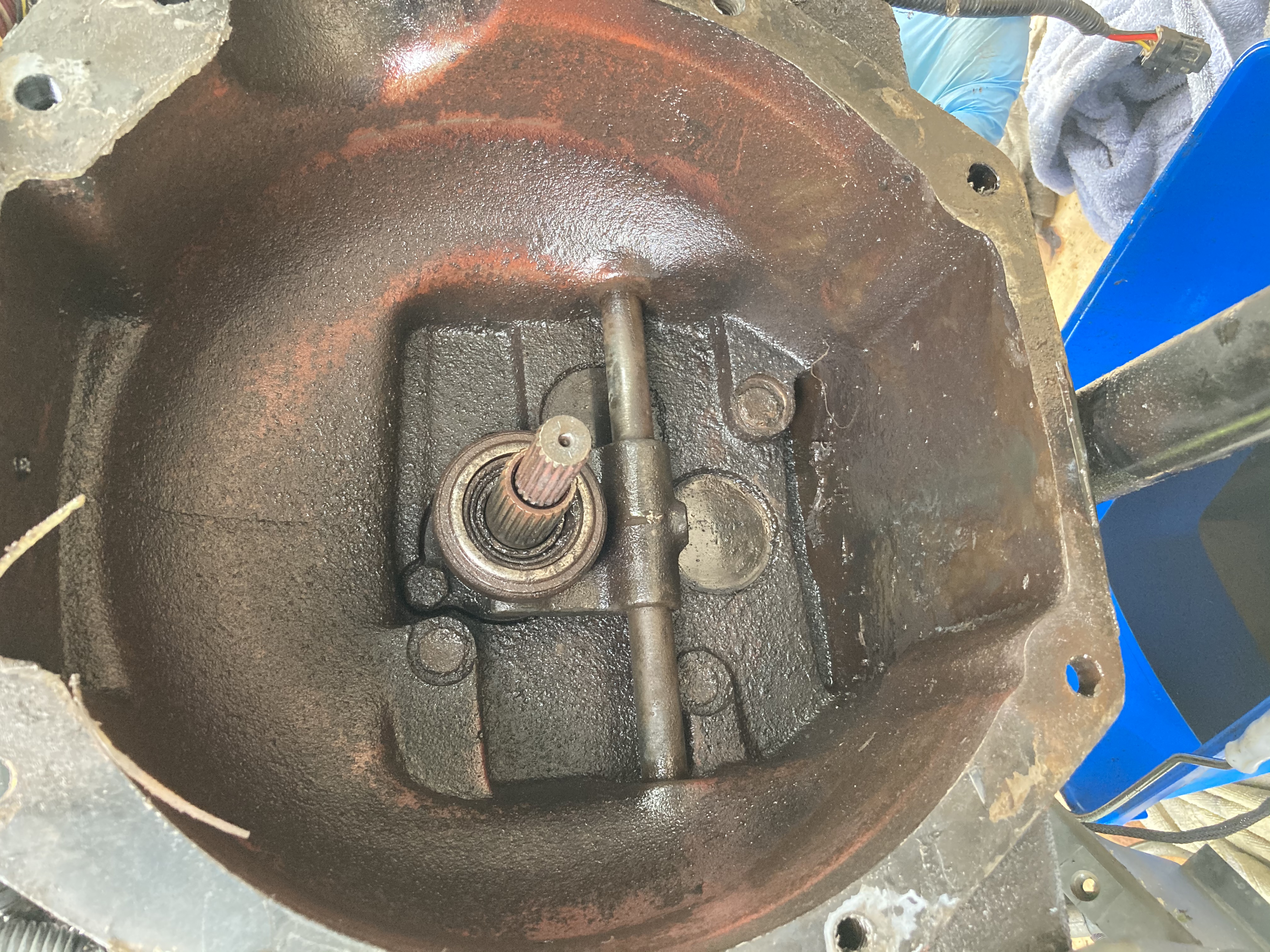

Hello,
just bought a landtrac 360 and it has a hydraulic leak that pours fluid down both sides of the bell housing, has anyone else had this problem? wants the fix?
there is another post here by littlefield years ago but no one responded!
thanks in advance!
   / Landtrac 360 Hydraulic leak at the top of the bell housing #2
The only thing I can think of up there would be steering hydraulics.
Ok everyone!
This is caused by the “plugs” on the transmission leaking hydraulic fluid into the bell housing, the clutch grabs it and throws it around and it leaks out of the top two bolts of the bell housing!
Split the tractor, replace the clutch plate and tranny “plugs” and you will be good!
   / Landtrac 360 Hydraulic leak at the top of the bell housing #4
Ok everyone!
I have a 300dtc with the same problem. don't see tranny plugs listed in parts manual. Do you have a source for them?
