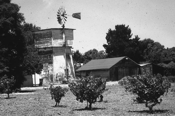

Pictures of ones I have (because they had a water pumping windmill attached to them) have vertical siding that looks like it was T-111 cedar type siding and some sort of 6 or 12 inch shiplap. On one of my windmills, I'm putting home-made horizontal shiplap siding I make from 6" dog-eared cedar fence boards.
