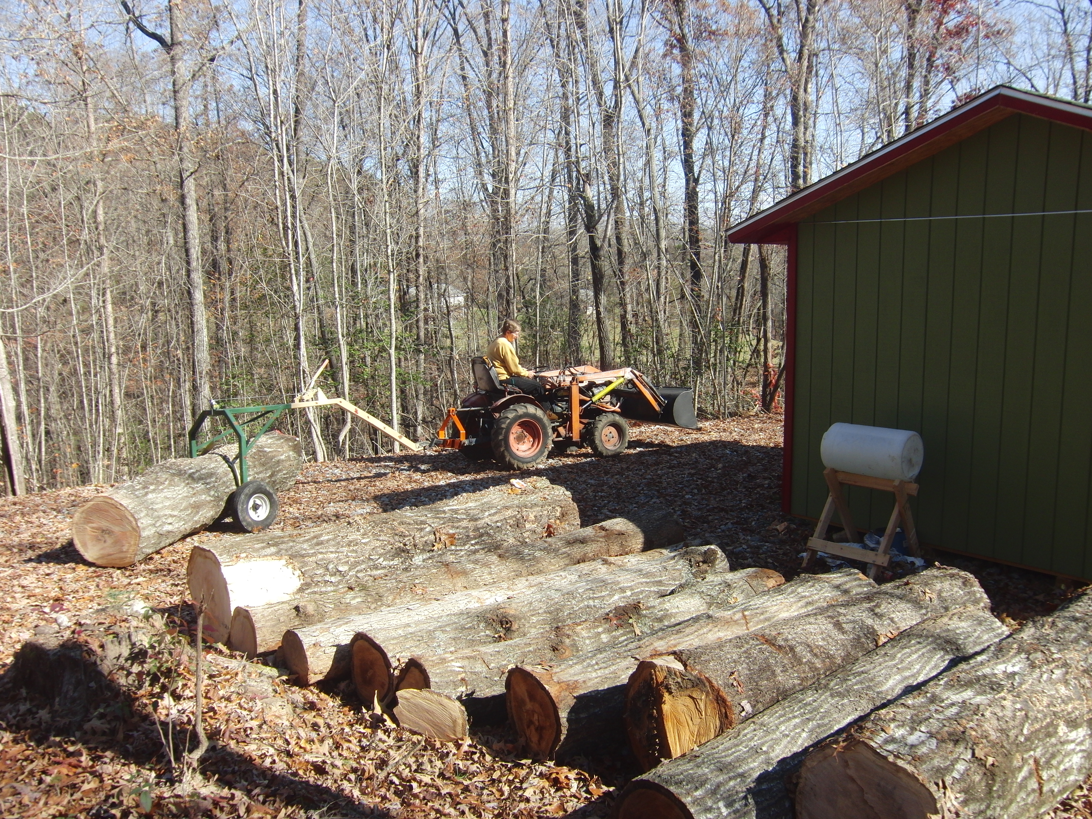

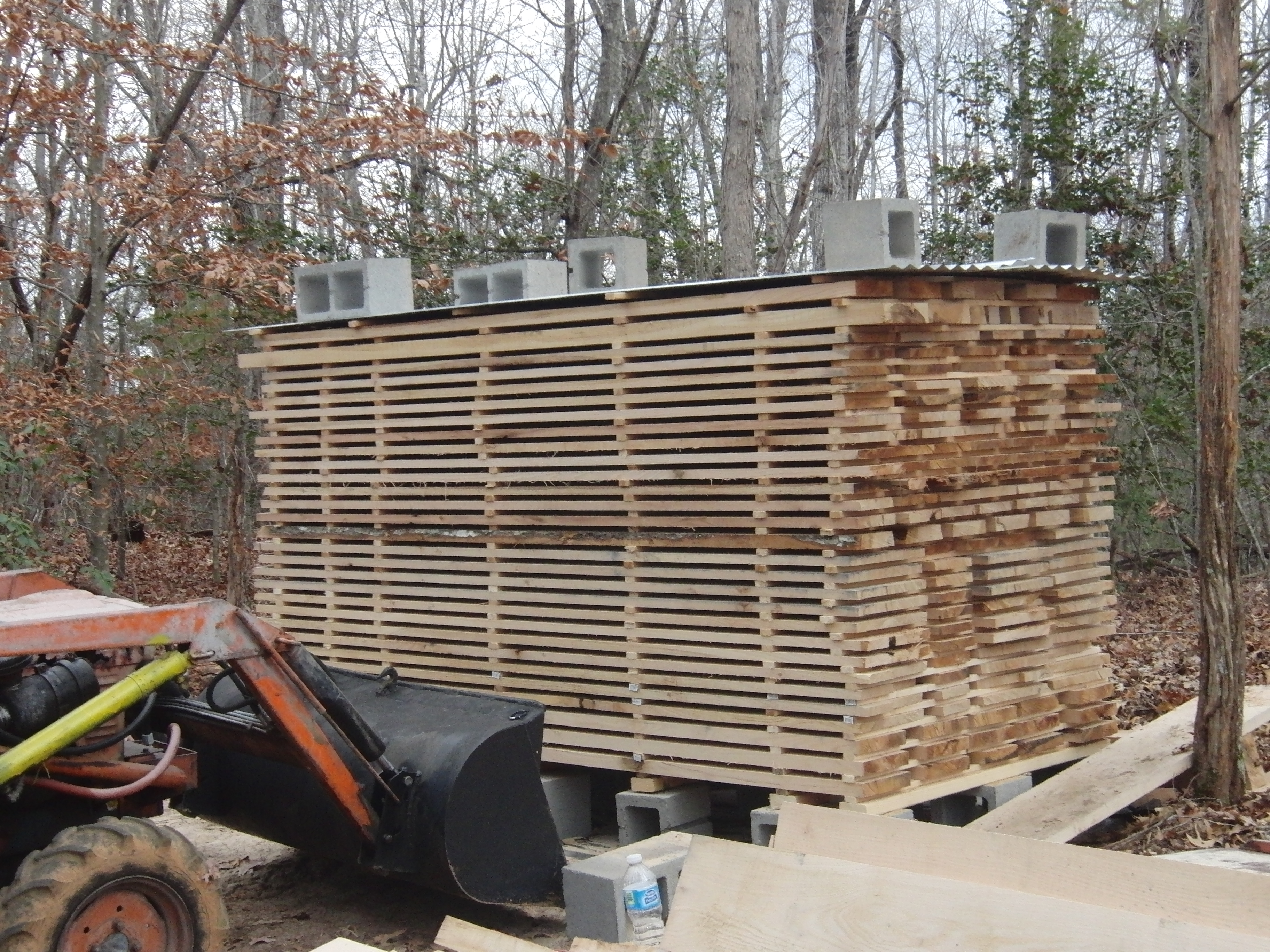

I had these logs milled by a guy who came to me 7 logs ready.JPG He took two days. First day was with setting up mill on my property and some cutting. End of second day all wood was cut. Mostly 1 inch thick by 6 -12 inch wide. $280 did it all.lumber stack.JPG
