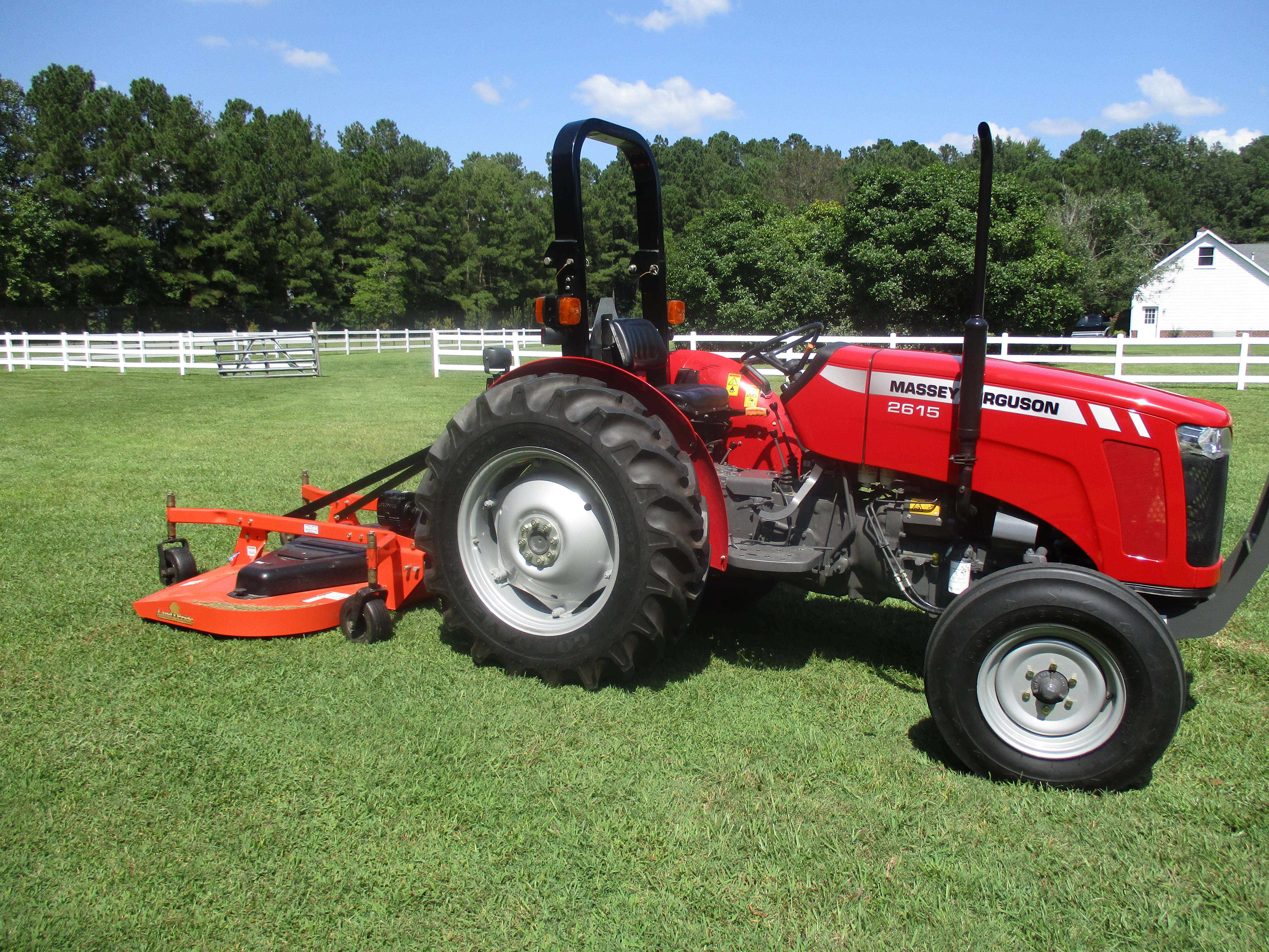

Not sure how large larger is but my 7 foot Land Pride rear discharge provides a superior finished cut, almost indistinguishable from a zero turn.
I have the mower offset to one side as far as i can and it nicely clears the rear tire of my Massey. Terrible paint clash, I know, mower bought for my Kubota.
Like all finish mowers, sharp blades really help. Mower is very quiet, almost no vibration and not prone to scalping. This is my second LP finish mower and they both have been
superb.
