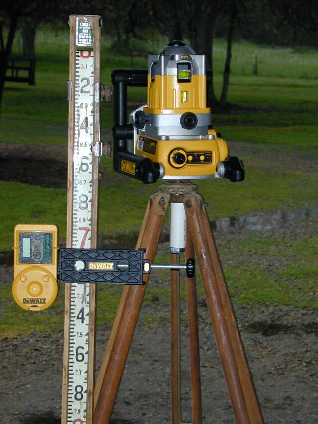

Thanks to a recommendation on another thread, I bought a DeWalt "DW071 Heavy Duty Laser" (rotating). The specs are easy to find on the web so I won't bore you.
Yesterday was creek brushing and burning day so I only got time to do a standard surveror's 2-peg test on it ... I confirmed the spec'd accuracy of 1/4" at 100'.
It's a "kit" which means that it came with the rod detector.
It does not auto-level and that's what I wanted as it can be used in an out-of-level position for setting a slope. (It has a bump alarm but not an out-of-level alarm)
The rod and, obviously, the antique tripod were not included. I expect to be receiving a modern tripod soon though the antique is surprisingly functional ... after cobbling a 5/8"-11 screw mount.
For those of you that might have noticed, yes, the rod is incremented upside down. It's a Lenker self-computing rod ... an excellent buy on eBay, $60.
I bought the laser via Amazon for $305 total, after $25 Amazon discount and free shipping. That beat Lowe's by around $60 (excluding tax I'd have to pay locally).
Cheers!

Update: I received the tripod today that I bought via eBay from TripodGuys (or somesuch). It's "used" but does, in fact, look brand-new. It's a standard aluminium "contractor's" type tripod. I'm not a fan of aluminium tripods nor do I like paying tooo much for a beat-to-death "surveyor's" wood-dowel tripod so this was a perfect match for $49 (including shipping). The only thing of note is that this tripod has cam-lock style clamps for the leg extensions instead of the wing-bolt type I'm used to ... again, the price was more than right though for a life-time tripod.
Cheers!

I just finished running a benchmark loop around my compound. I traversed about 400' with the laser in about 6 setups. I was able to close on my initial backsight 0.02' (1/4")low which I was very pleased with. I did try to balance my foresights and backsights and I don't believe any were more than 100'.
The laser system was very easy and fast to use. I was a little concerned about the speed of setting up after hearing so much negative feedback on the subject of setting up a non-auto level laser. In the off chance that I can help someone in this regard, the standard surveying setup procedure that I use is simply: 1- stomp the tripod legs into the ground while trying to get the instrument kinda level; 2- use the tripod leg extensions to rough-level the instrument relative to the level bubbles; 3- fine level with the leveling screws. If I had even wanted an auto leveler, I'd only be saving about 5 seconds to do step 3.

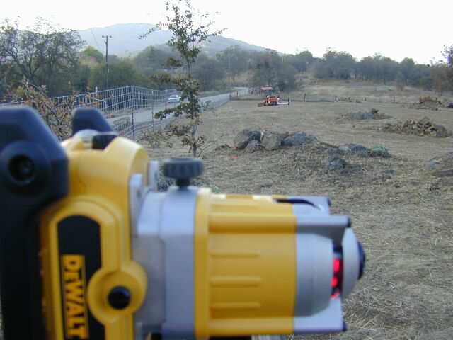

So, today's challenge was to run a line for a new fence line. I can set the laser to spray a verticle line but, at 400+' and no helper ...
The laser detector has a low and high audible output but I figgered at 400+' it would be of no use even on the loud setting. I was wrong. I set up the laser at one end of the line and set to detector at the other. My laser has the ability to be mounted on the tripod so it throws a horizontal OR vertical line. I set it up to throw a vertical line, obviously. Then I was able to just loosen the tripod screw and rotate it horizontally till I heard the detector BEEP at 400+' away !!!!!! VERY handy.
Cheers!
