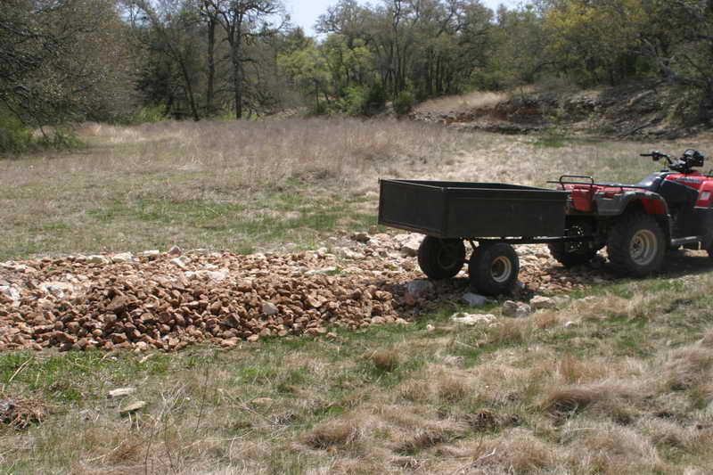

This past week, the kids and I were clearing rocks out of our lawn where I had tilled this past winter. We are smoothing it out in preparation for planting grass.

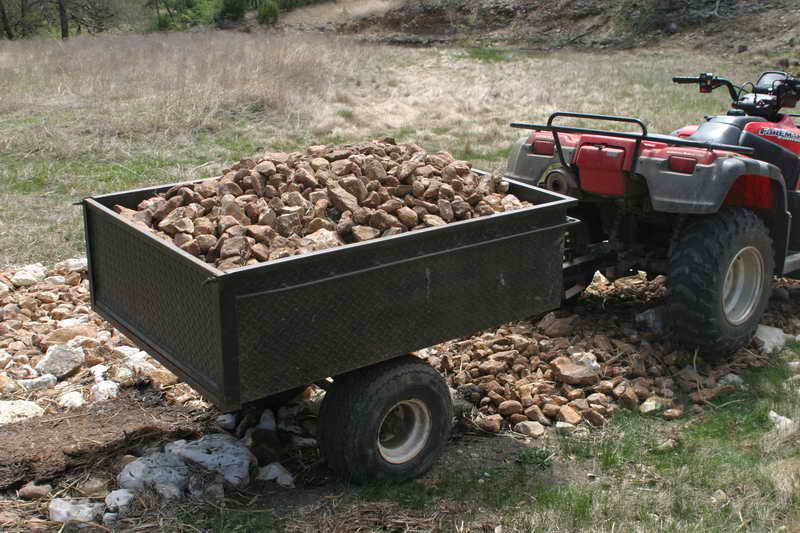

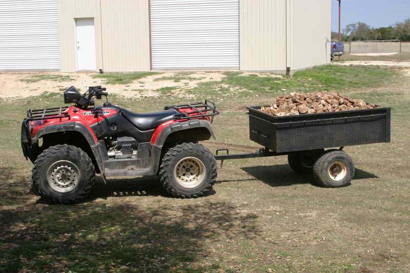

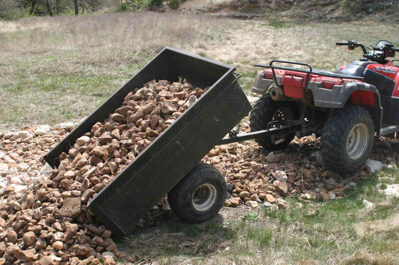

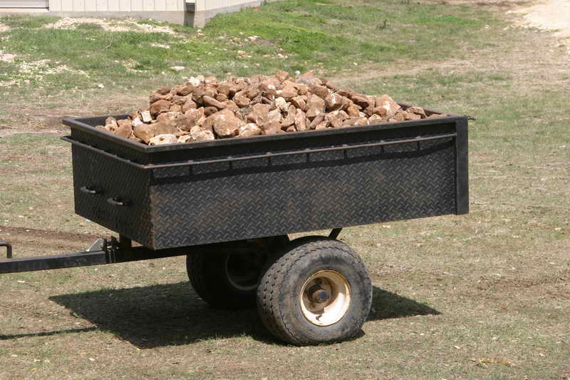

Anyway, I have this "lawn and garden" trailer I built 13 years ago. We pull it behind the ATV. I wanted it to be heavy duty, but still in the lawn and garden range. It has 1,000lb spindles and 18.5x8.5x8 golf cart tires. The frame is 1x1/8" square tubing with 11ga diamond plate. The bed is 3' wide by 4'6" long and 15" high. It will carry just about anything I can put in it.
Folks are always asking me where they can buy one like it. I wish there was a market for trailers like these and someone with enough pride to manufacture them.
