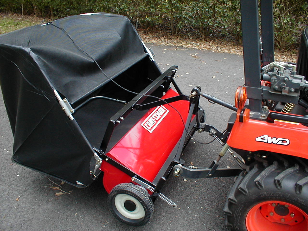

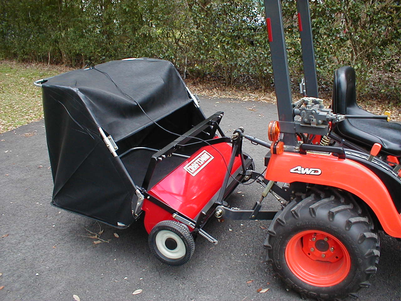

This is a conversion I recently made to a new Craftsman 42 inch "pull type" lawn sweeper (see photo). Since I'm terrible at backing up any towable attachment, I now can pick up my sweeper when the hopper is full, and back right up to a trash pile and dump. I don't have to get off of my Bota, and can raise the sweeper high enough to make the pile fairly high. Just something to share.

Great idea, I am interested in how it performs when turning.
And additionally my sweeper's basket would probably not support the clippiings if I lifted it, did you reinforce the basket?

This sweeper is new, and is replacing a 38" AgriFab I 've been using the past 5 years in the same way. The AgriFab hopper is in excellent shape (no tears). The hopper is always suspended a few inches off the ground anyway, so will hold a load regardless. As for as turning goes, I've always made gradual turns when the sweeper is down. When I make sharp turns, I lift it a few inches to lesson any side strain on the wheels. The wheels of the old AgriFab show no wear at the hubs, and I've made may a turn with it.

Have you had a chance to use it? I'm just curious how the frame will hold up with lots of grass in it- will the frame twist or bend?

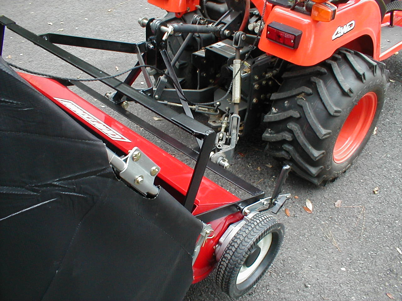

No problem I know of. These types of sweepers have the hopper hanging from two side arms mounted to the end plates of the body. The weight of the full hopper remains the same, whether you pull it or lift it. As the photo shows, my anchor points (3pt) are at each end, close to the wheels. Even the third link pull is distributed closer to the wheels. I've only used the Craftsman once to test it, but in 5 years of using the old one, I've hit bumps, etc. in the yard that have caused the sweeper to be jolted around a lot, and it continues to hold up. Keep in mind that my BX1500 has a single action rear lift, not double. So there's no danger of pushing down on the sweeper with the 3pt.

Very nice. I had the same idea this fall and rigged mine up temporarily. I don't have pictures but I basically connected the tow point to my 3pt drawbar and then I used a chain to link to the sides of the sweeper. Raising the 3 pt hitch raised the sweeper. I tried the temporary set up to make sure it would work and I was quite pleased. It easily allows for the load to be driven to wherever you want it for dumping.
So this summer I will rig up a permanent approach similar to yours. Thanks again for sharing.
