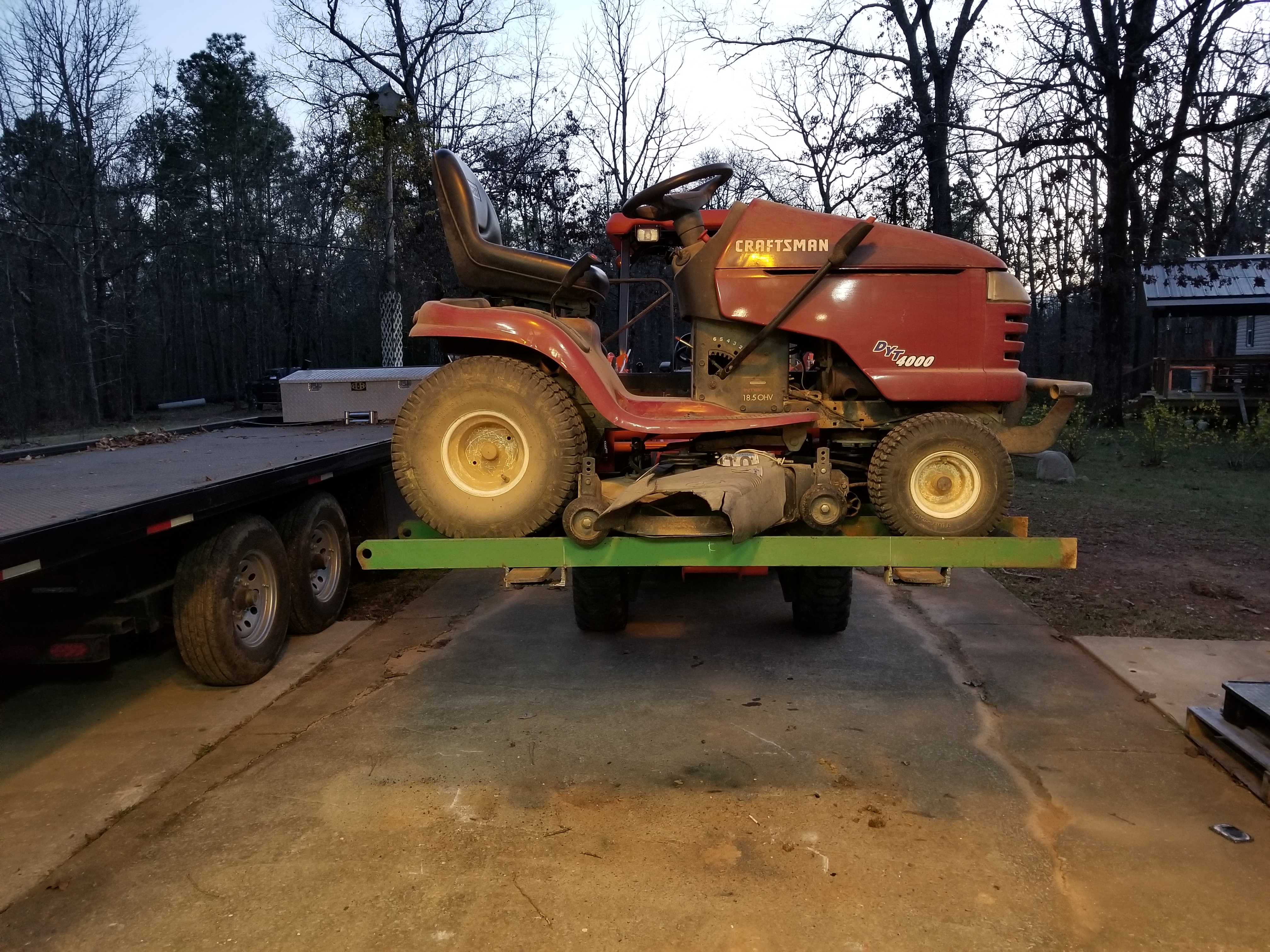

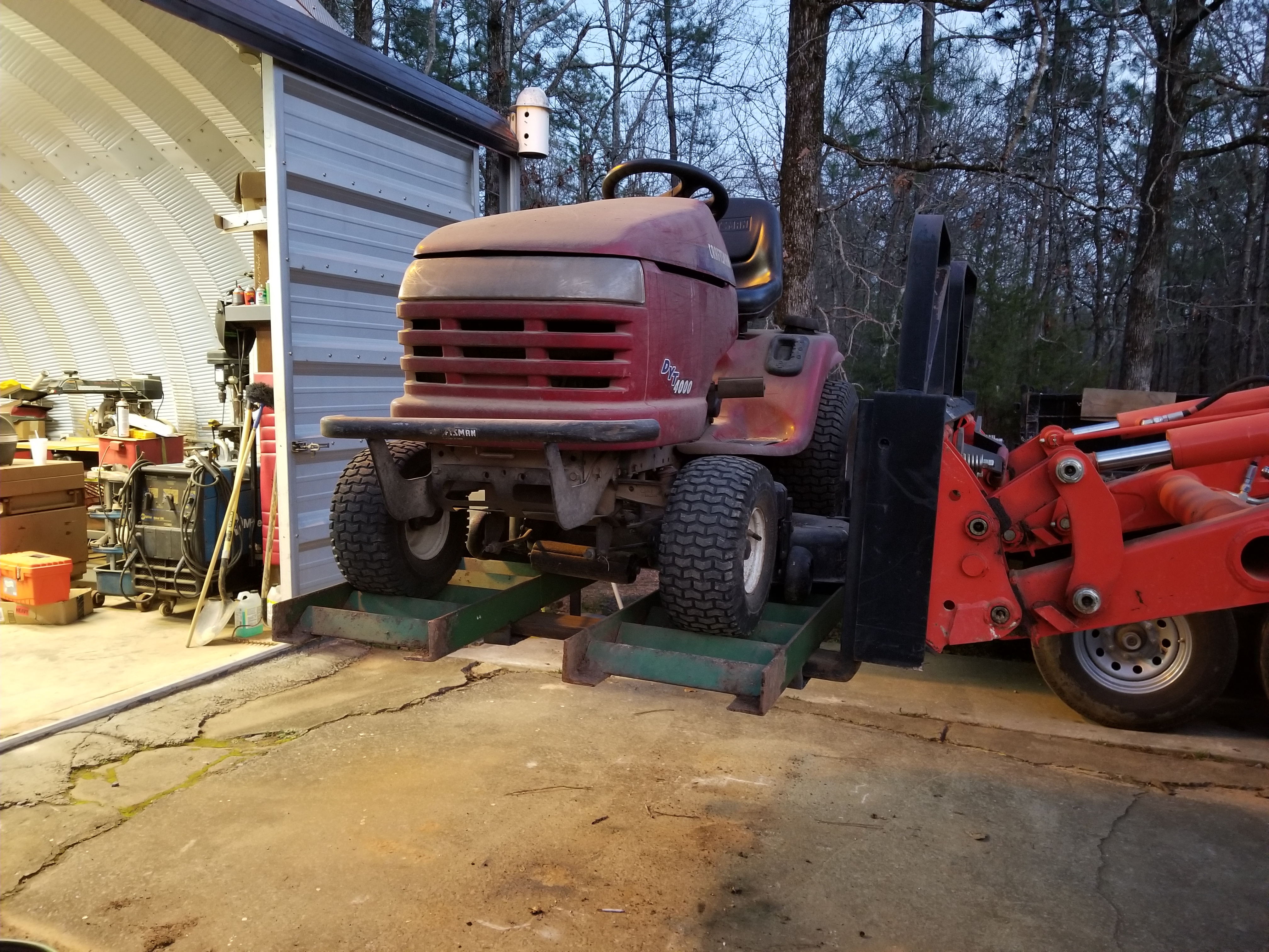

Been playing around in the shop again, welded some channel iron on the bottom of an extra pair of ramps for my forks to fit in. my thinking is I can use this to raise a mower up to load or unload a mower, maybe raise one to look at and see what's wrong but not work under it unless I put a safety leg under it. I do plan on a safety chain connected to the tractor so that it does not slide off the forks.

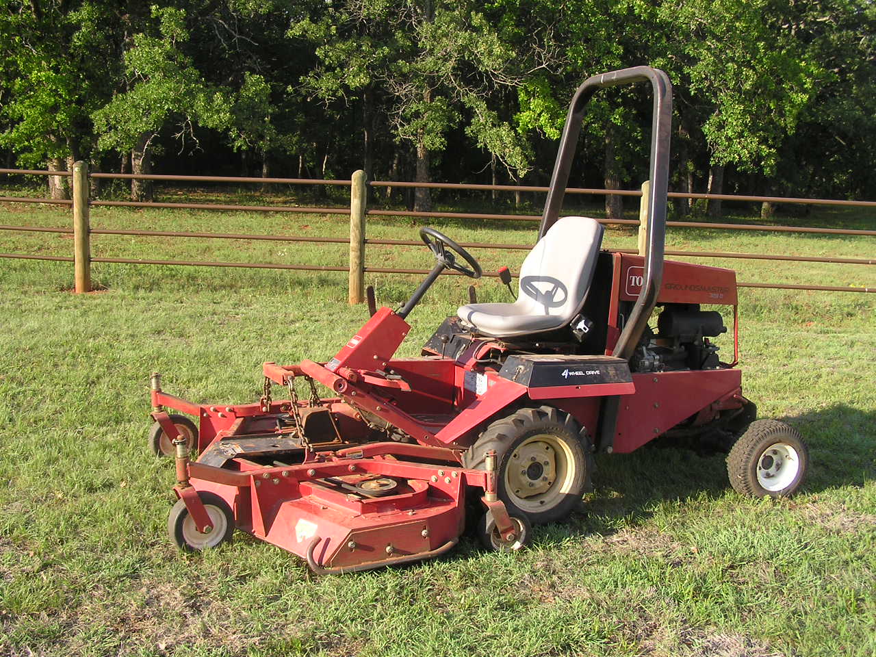

Thanks for the idea. I had looked at the commercial mower lifts, but most are too small for the TORO:
