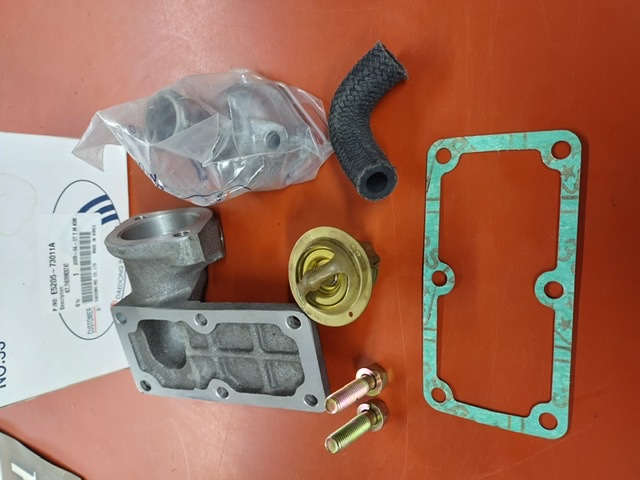

I have a Kioti LB1714 (1988 - first year of production). I require a new thermostat but having trouble sourcing. The old thermostat has a flange of 38 mm and post of 27 mm. Searches return part #s that are larger - probably for later model years. Any information would be appreciated.

You would need number E5205-73011A. Your local Kioti dealer should be able to order it for you.

It seems that the part # is for a thermostat kit. Do you have an idea of what the kit is? Thermostat & gasket - or other pieces, possibly?

Here is a pic of that assembly - contains all pieces from the rad to the block.

I just needed the 38mm thermostat. Googled and found an equivalent from Kubota.
Part #s are: Thermostat - 1E399-73012 and gasket - 16264-73270.
