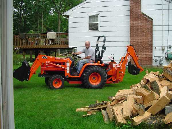

As a 1914 owner, I can only say good things about this tractor. Aside from the loader and backhoe, I only have a rear grader blade that I have only used for snow so far. It has dug every hole and pulled every stump or rock I went after. As far as steering goes, in 2wd is better than 4wd. I plan on a rottotiller and a york rake for it next year. If asked whether or not I would buy it again? You bet. I was smiling the day I got it and I'm still smiling.
