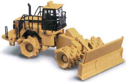

Cool! That looks good.
Here's a picture of my next leaf mover /w3tcompact/icons/laugh.gif.
See attached.
