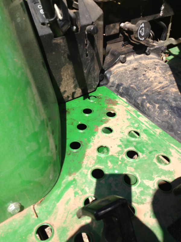

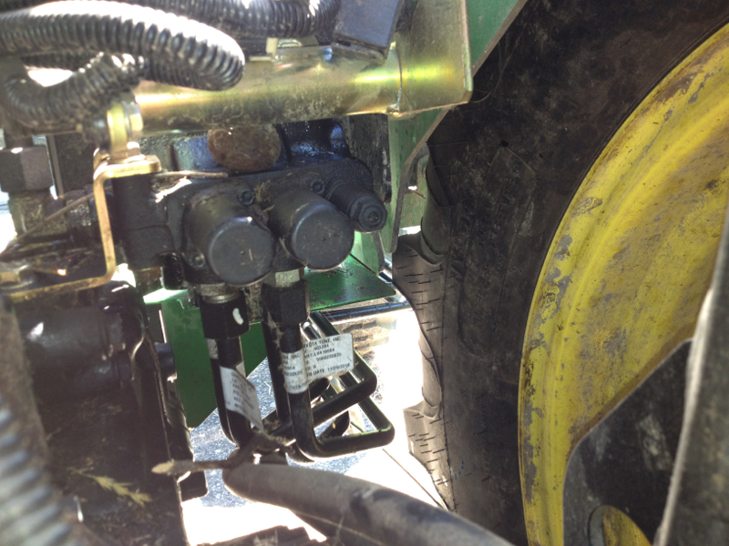

I noticed a lot of oil near the joystick. From the rear, it looks like the control unit is missing a cover or cap. Would this be the likely source?
Thanks!

There are no caps missing, as there is a cap for each spool on the two spool valve.
The third item over is probably the relief valve for the open center hyd system on your tractor.
If you have a leak from the bottom of the valve, you might have some o-rings that can be replaced.
You normally can not replace spools in a valve when they wear as they are a precision part.
   / Leak near base of Joystick #3
Soap it up and clean it spotlessly clean and then search for leaks. If it's clean, it will be much easier to spot the exact source of the leak.
