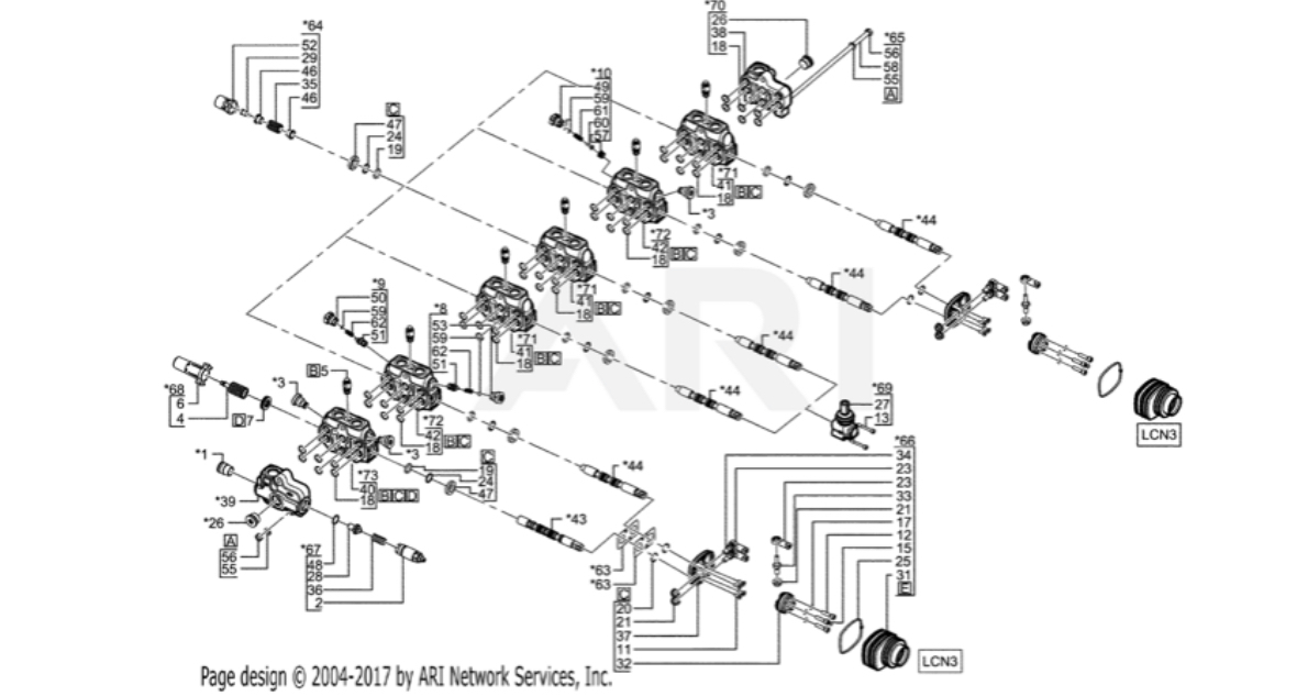

Leaking Backhoe Valve KB2475L

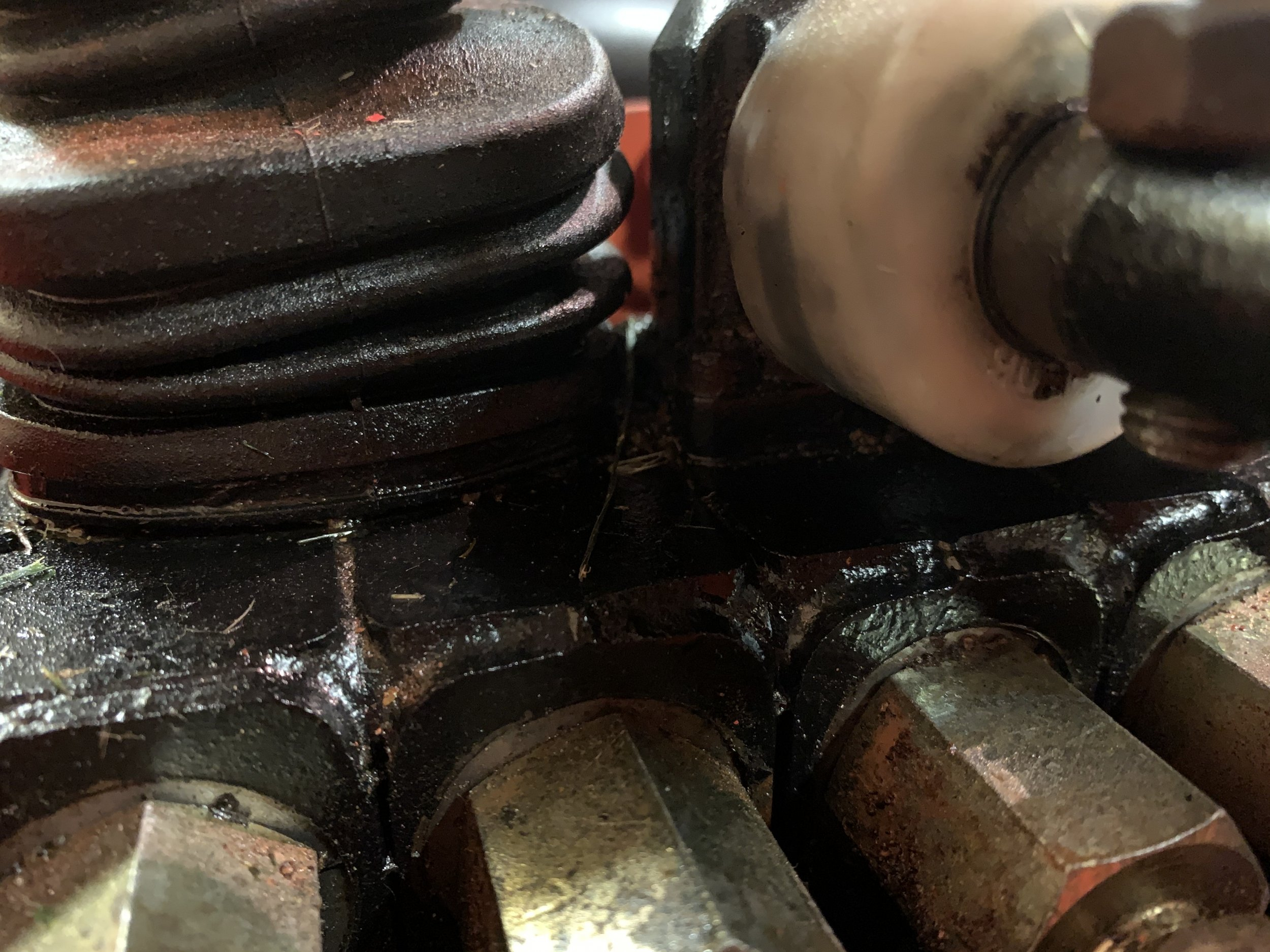

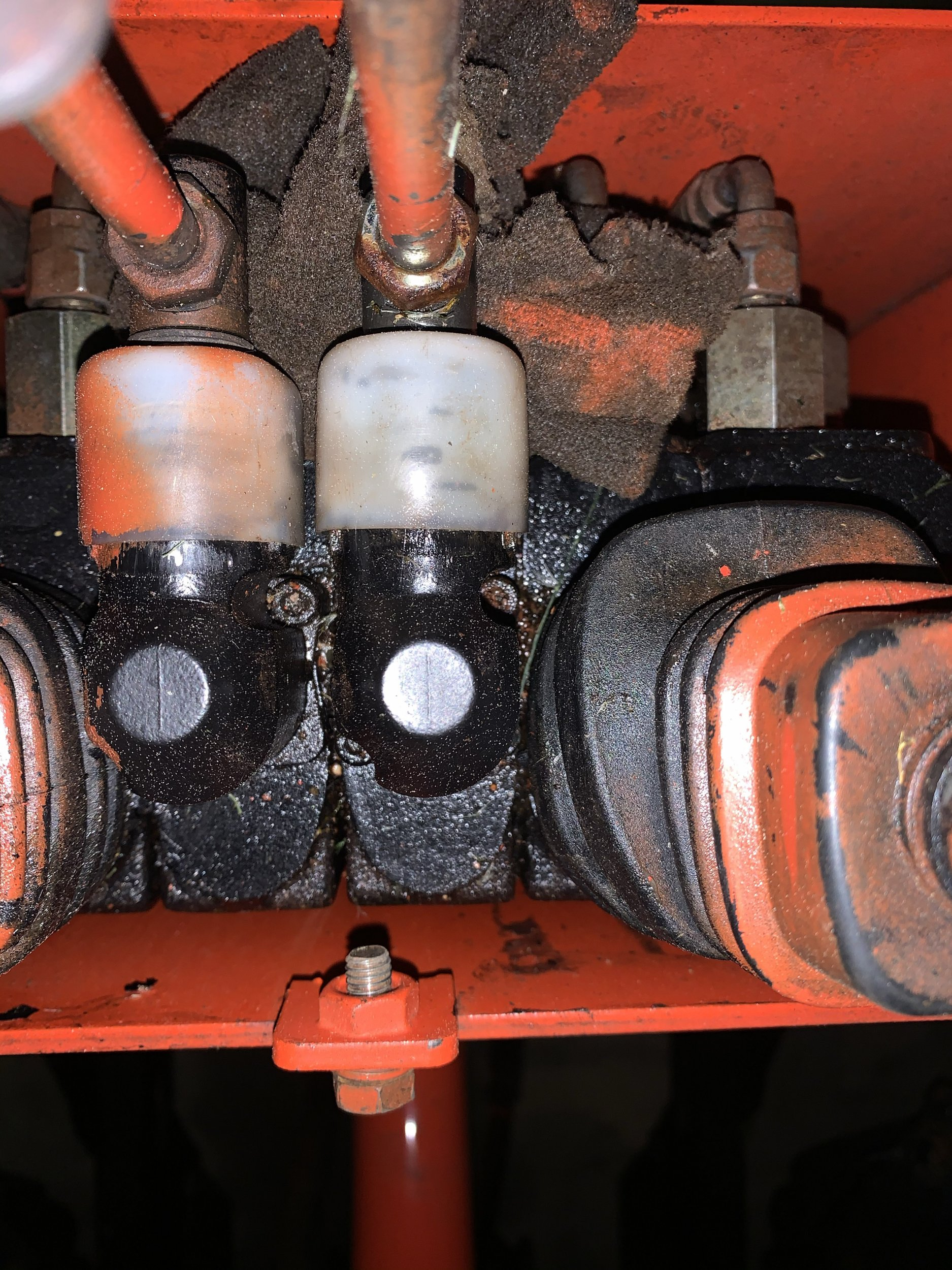

I think I may have found enough info now to have a better idea of what is the issue. The leak is coming out around the valve lever for the left stabilizer leg. I’m wondering if I take off the “lever pivot box” is the spool going to come shooting out?
Here are some more pics:
Leaking under the white plastic cup/cover when actuated.

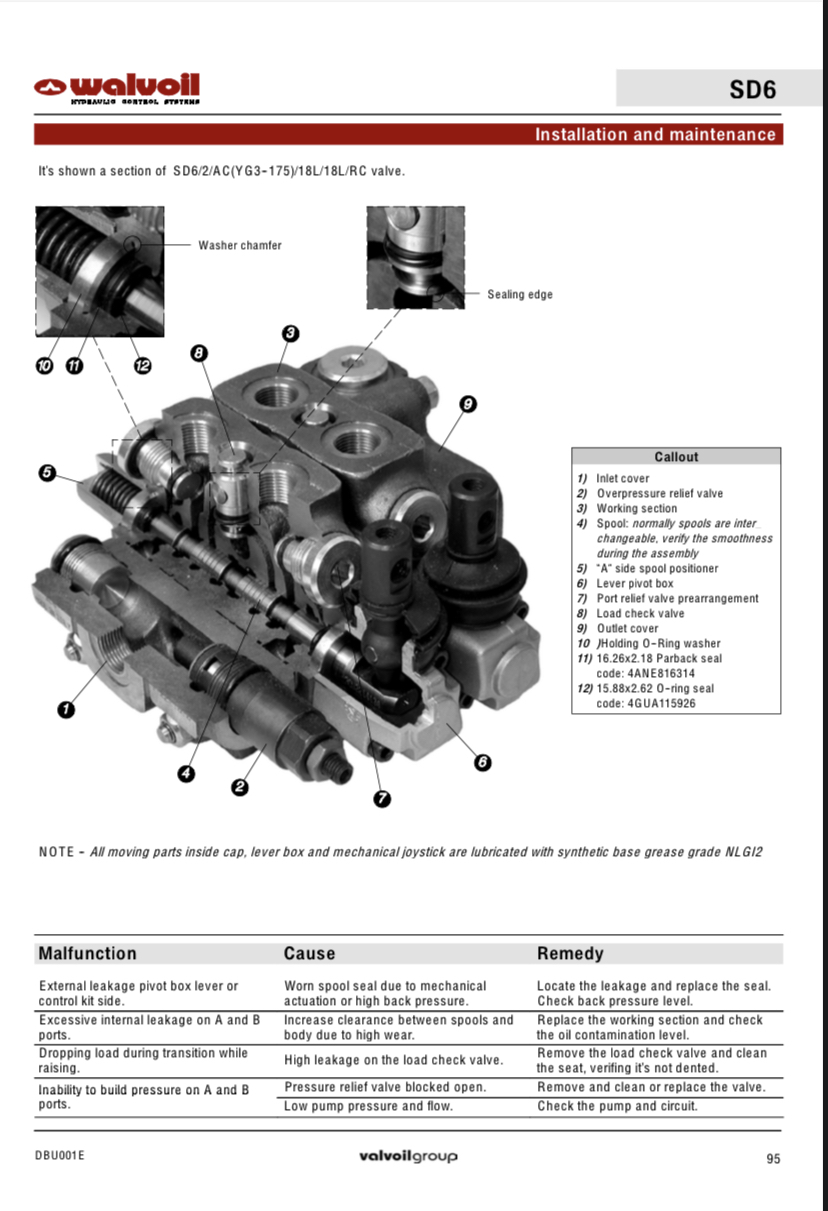

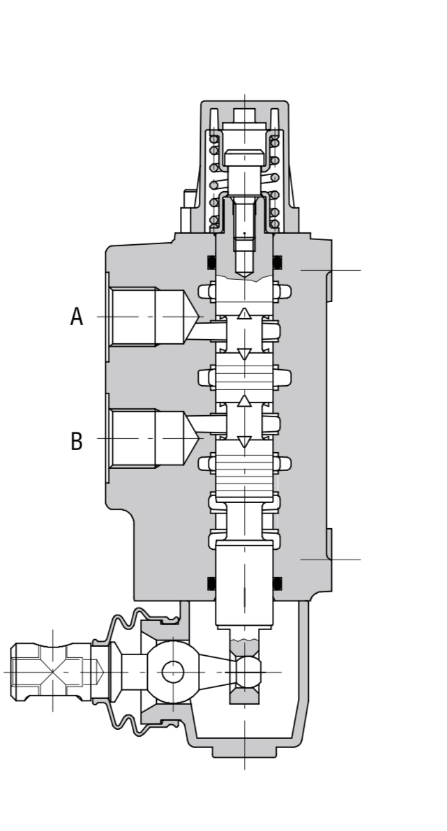

Like you I have never had this unit apart and I am just guessing but from the drawings it looks like the spring is a centering spring so that the spool returns to a neutral position.
I would guess that when you remove the the pivot box this spring does not have much if any compression on it.
as you’re removing the box un-tighten the fasteners in an alternating pattern to see if the pivot box becomes loose. If it does then the spring is not compressed.
Let us know what you find.
